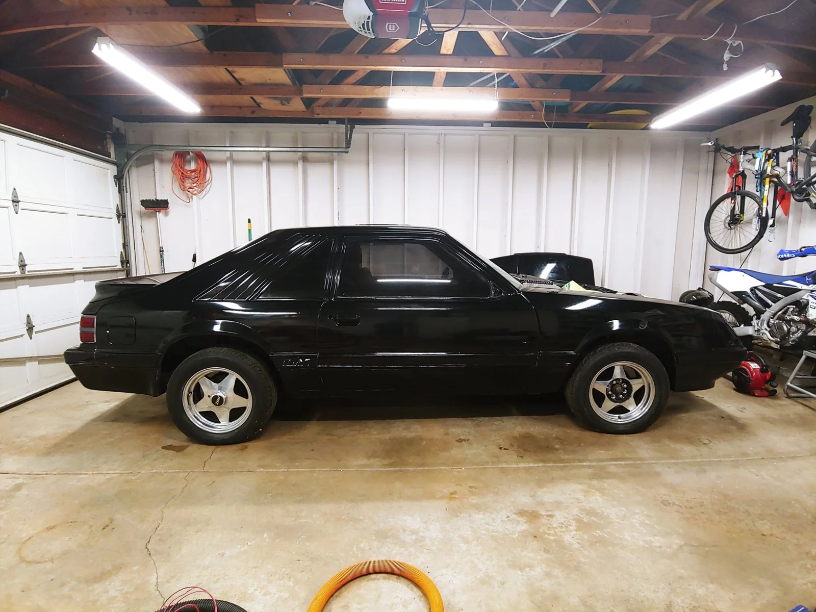

Hey guys, got an 85 gt, carbed 302. I took over someone elses project. Stock 95 f150 bottom end, with the 85 gt top end. Edelbrock 600cfm carb. bbk shorty headers. Last owner did install new distributor, durapsark and accel coil. Then it sat several years after this. I have the right firing order, verified by watching the intake valves move while hand turning the motor. Timing is set about 10-12 degrees. Also has a holly red fuel pump (7psi, no regulator but i have one getting ready to go on). I have done new plugs, wires and rebuilt the carb. Car starts up and will idle all day. A quick stab at the throttle and it will rev right up to about 2500-3k. If i try to go higher, it stumbles and pops out the carb. By doing some research on this, symptoms of a bad coil will do all of this. Just wanted to get some more input before i start throwing parts at it. Appreciate any input. Thanks
