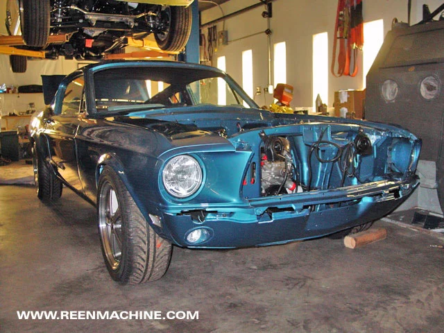

What year is the car? I have used those wheels on a '68 with a 1" spacer/adapter up front and 245/45-17 tires and it's perfect.
DO NOT use longer studs through a simple spacer. You must get proper adapters, which bolt to your existing studs and then have new studs for the wheel.

thats just about perfect... heres a pic of it with bullitts before and ugly bodywork :D
