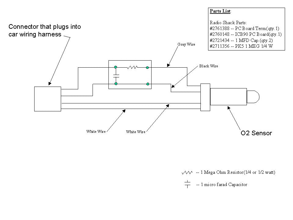

I'm still getting a check engine light wtf:mad: . Basically i did my own mils that required a resistor and the capacitor cant remember the specs of the resistors and cap. Can someone please send my a diagram if you did your own I lost the diagram i had before. thnx:SNSign:

There you are
