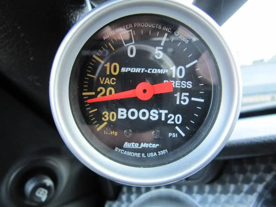

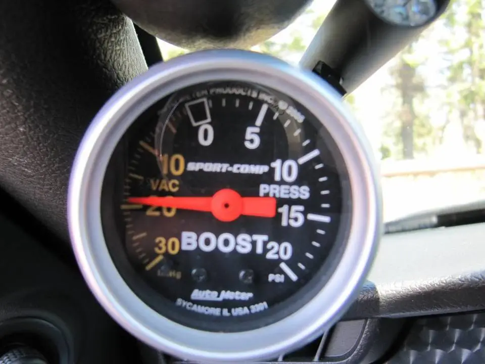

Here's some pics I took during my NJ-CA road trip. Some proof of how much altitude affects your car just at idle.
5,000 ft in Zion NP, UT
10,000 ft in Bryce NP, UT
My vacum back home (Jersey) is at sea level at 26. I don't have a pic.
In Bryce there were times when I couldn't go up a mellow hill without going into boost!
