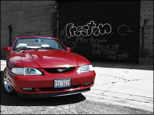

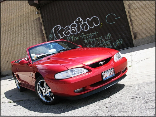

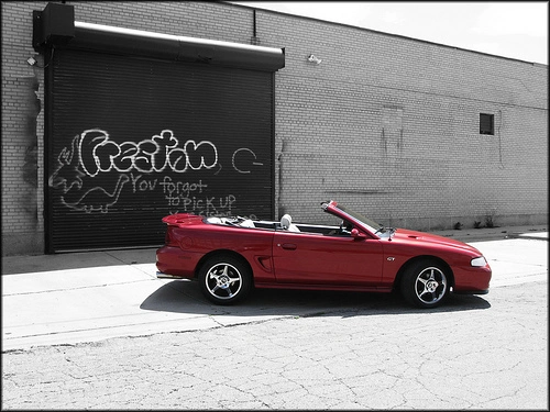

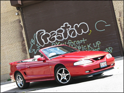

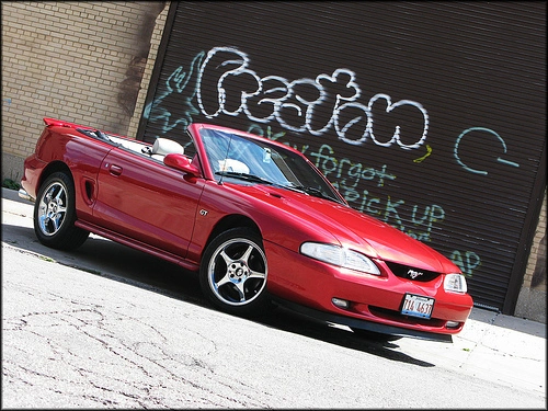

Hello everybody i havent posted in a while since I have been busy wrapping up school and looking for a new career. Anyway i just put on the s281 spoiler i had in the garage for 8 months and decided to take some pics. I also had a question for any of you that may know. I got keyed a few weeks ago because of some jealous A*Hole and I attempted wetsanding the deep scratch on my own and stupidly used p800 grit instead of the finer 1000 and above. Now my clear coat where i sanded is hazy and rubbing compound nor buffing does the trick. Do i need to wet sand those scratches out with a finer grit? Any suggestions would be helpful it is unsightly. Anyway let me know what you think.

The car looks really good, anyway. ;)
