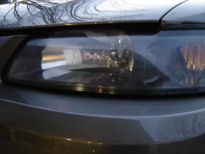

Just an update on the problem we've all had with headlights that are etched by the elements so they aren't crystal clear anymore. I had a go at restoring mine, and it worked great!
To see if your headlights are etched on the outside or fogged on the inside, wipe some light oil like WD-40 on the outside. If the fogging goes away, you've got exterior etching that can be repaired.
I started by removing the light from the car and wet-sanding with 1000 grit wet/dry sandpaper. Spray water on the lens occasionally- it will help keep the paper clear and prevent debris from scratching the lens. Once the lens had a uniform cloudy appearance, I switched to white jewelers rouge compound on a buffing wheel. This really reduced the amount of manual labor and at the end the lens was really looking a lot better. The final step was Turtle Wax polishing compound- applied wet by hand. The headlight looks like new now. I no longer need to think about replacing the lights!

It does look like new. Nice job
