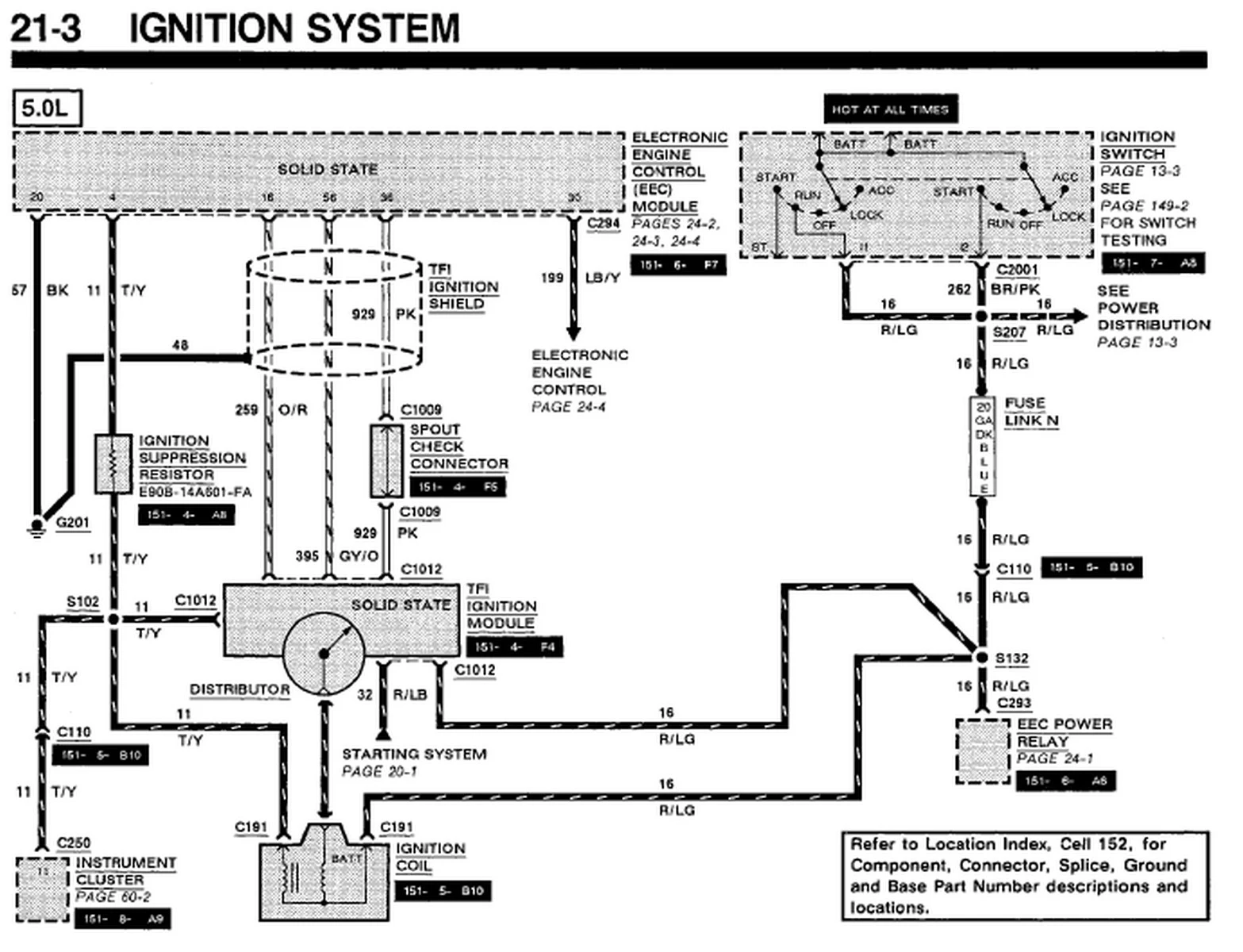

89 MUSTANG 5.0.... It would die or stall at random times. Thought maybe the tps or iac was causing this so replaced them and set the tps at idle at .97 volts. found some cracked and dameaged vacuum lines. replaced them. replaced the distributor. Now I notice when I have a test light connected to the pos. side of the battery and the other end on the ground of the coil the light will blink when the engine starts missing and hunting around. Also if I'm not mistaken pin number 4 on the ecu should be seeing this ground as well as the tack (green/black wire. only codes I am getting is for smog stuff and that is no longer there. checked all my grounds and they are all below 1.5 ohm does the ecu need to see the pulse signal on pin 4?

yes. disconnected iac. set idle and made sure the tps was under 1v

let me add this problem was intermittent until I charged my ac and now it is all the time ac on or off

Pin #4 on the computer is the IDM (Ignition Diagnostic Monitor) signal that is used to drive the tach and computer. It expects to see an IDM pulse for every SPOUT pulse. It uses this information to determine if the ignition coil and other ignition components are working properly. This signal is low current and will only drive test equipment with a high input resistance - that means no test lamps or other low resistance devices.

you are correct jrichker. but if I check the wire from the ign module (green) to pin 4 I show ol on my meter. the print that I have shows the number 4 pin through a ignition suppression resistor to connection s102 to were it goes to the tach tfi module and to c191 ground of the coil guess what I am asking is how this works. does the signal start from the ecu and go out or is this supply info to the ecu

The IDM signal originates with the TFI module. The 22K ohm resistor drops the voltage down to somewhere between 9-15 volts for the Tach and the computer.
