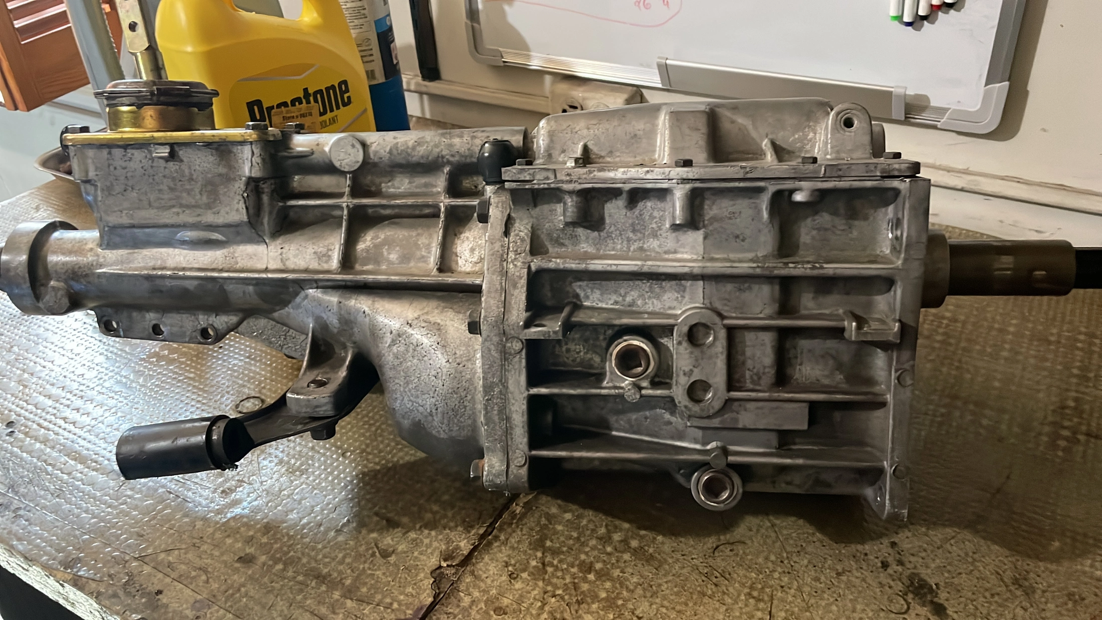

Shortly after all that the original T5 started to have issues with holding in gear - it would pop out of 1st and 2nd gear. I managed to get a reasonable deal on a T5z and swapped that in - learning the hard way about not using the bolts to seat the transmission . After pulling it back out and replacing the pilot bearing again everything was smooth.

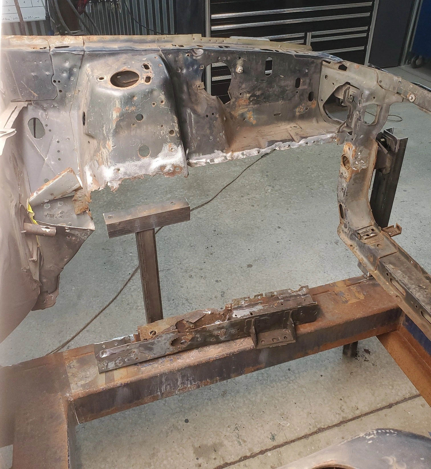

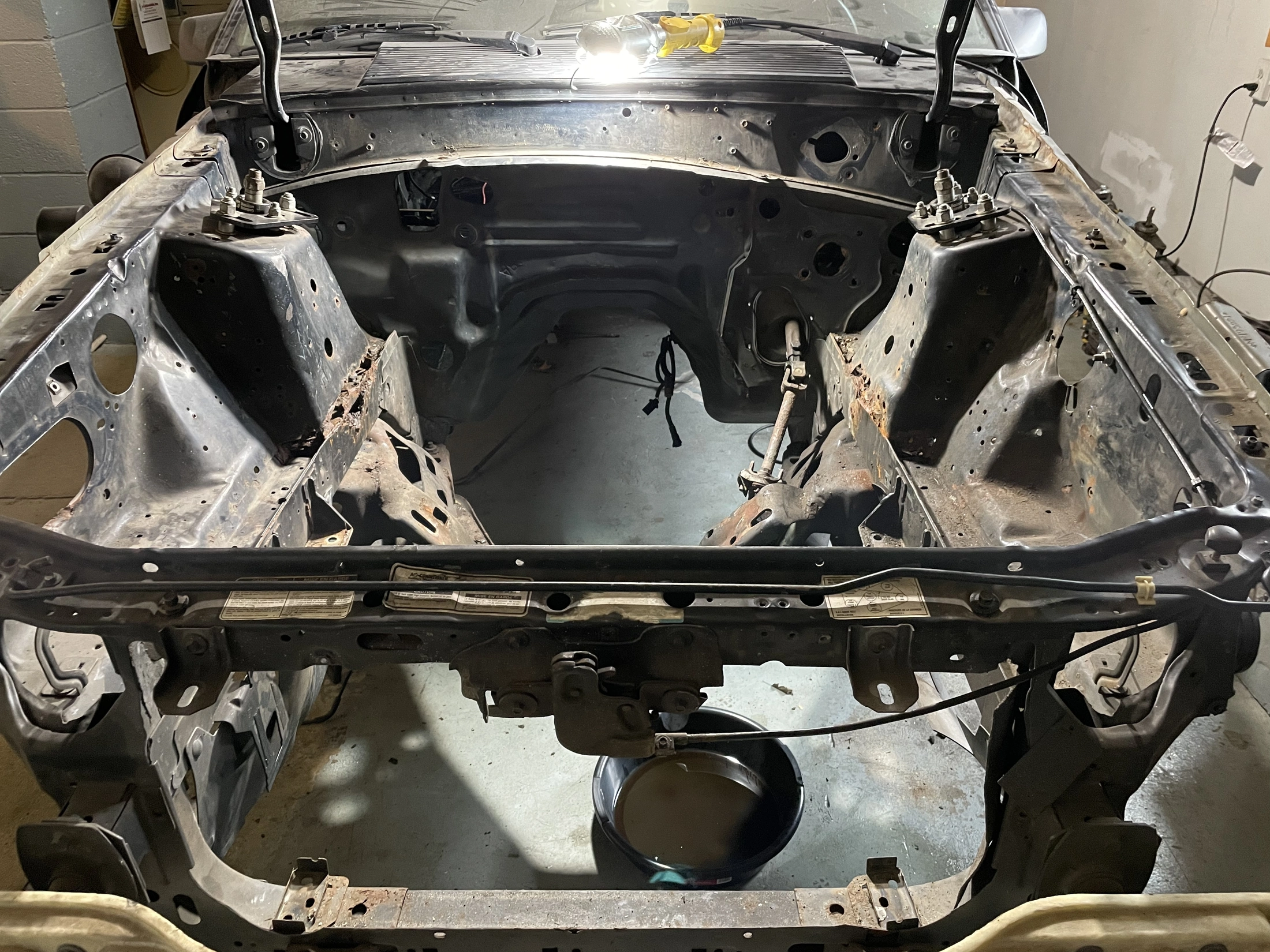

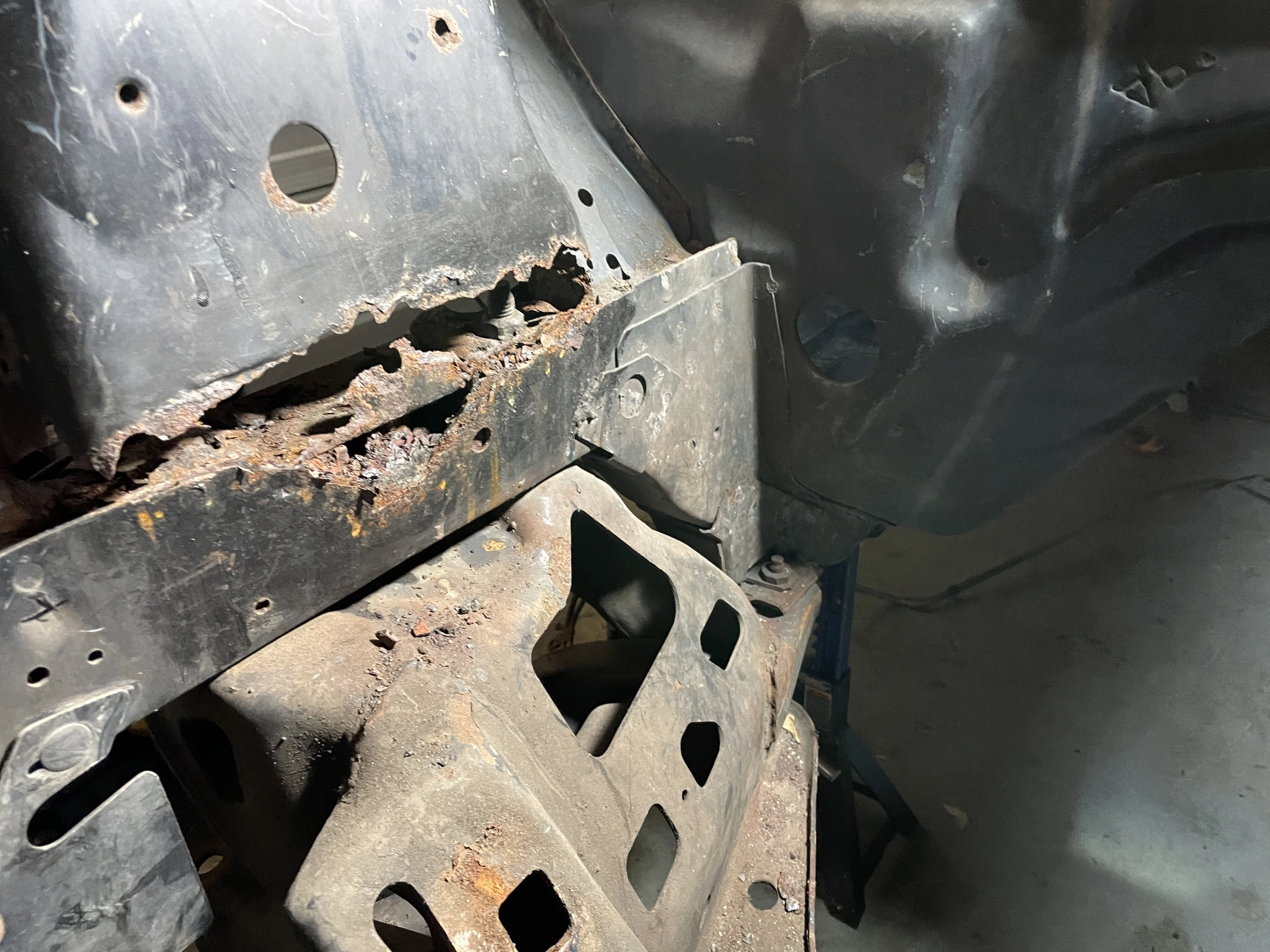

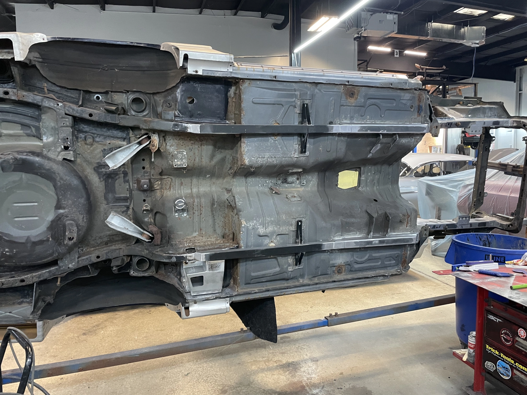

Alright now for the rest up until current day.... I stripped the car down to the absolute minimum - everything got removed unless it was needed to steer/roll. After a lot of quotes and discussions I finally found a local shop that could do the work - repairing the framerails. Since the car was basically fully stripped.. it made sense to do some other stuff underneath at the same time.
The torque boxes were pretty bad, so lets replace those and install subframe connectors:
Front frame rails? who needs those:
The rust was pretty bad, but we also found out the car had been bent from side/side - the passenger and drivers sides were about 1 inch lower than they should have been - and the center of the car (think trans tunnel) was higher than it should be - so that had the get straightened back out. Since the car was basically fully stripped - i was able to have the bottom side sand blasted and painted - removing any last surface rust and rot and sealing it away.

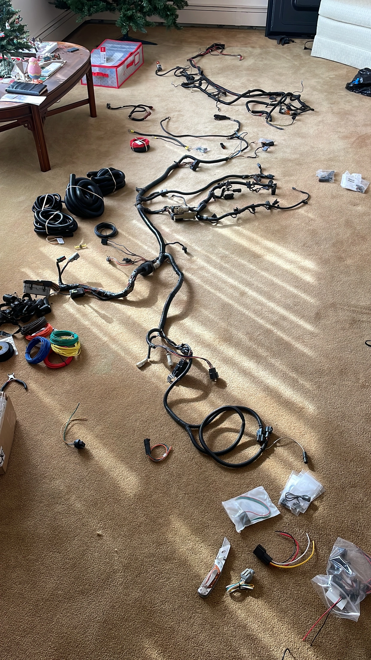

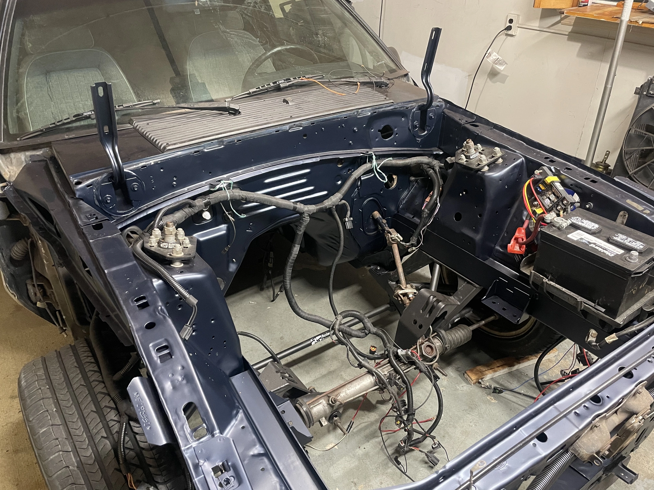

While that was going on, I figured I might as well redo the factory harness - removing the salt-pepper shaker connectors and lengthening the needed wires so I could hide the harness as best as possible, trying to clean it up as best as possible:
I wish I took more pictures of that process.. it took forever but was 100% worth it in the end.

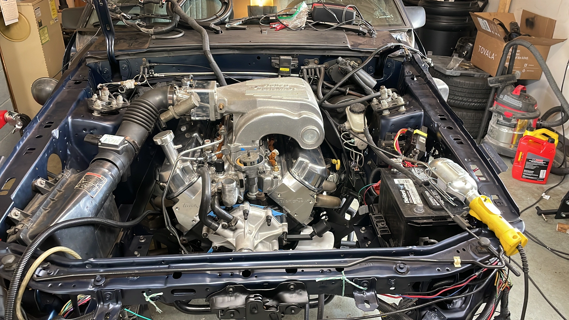

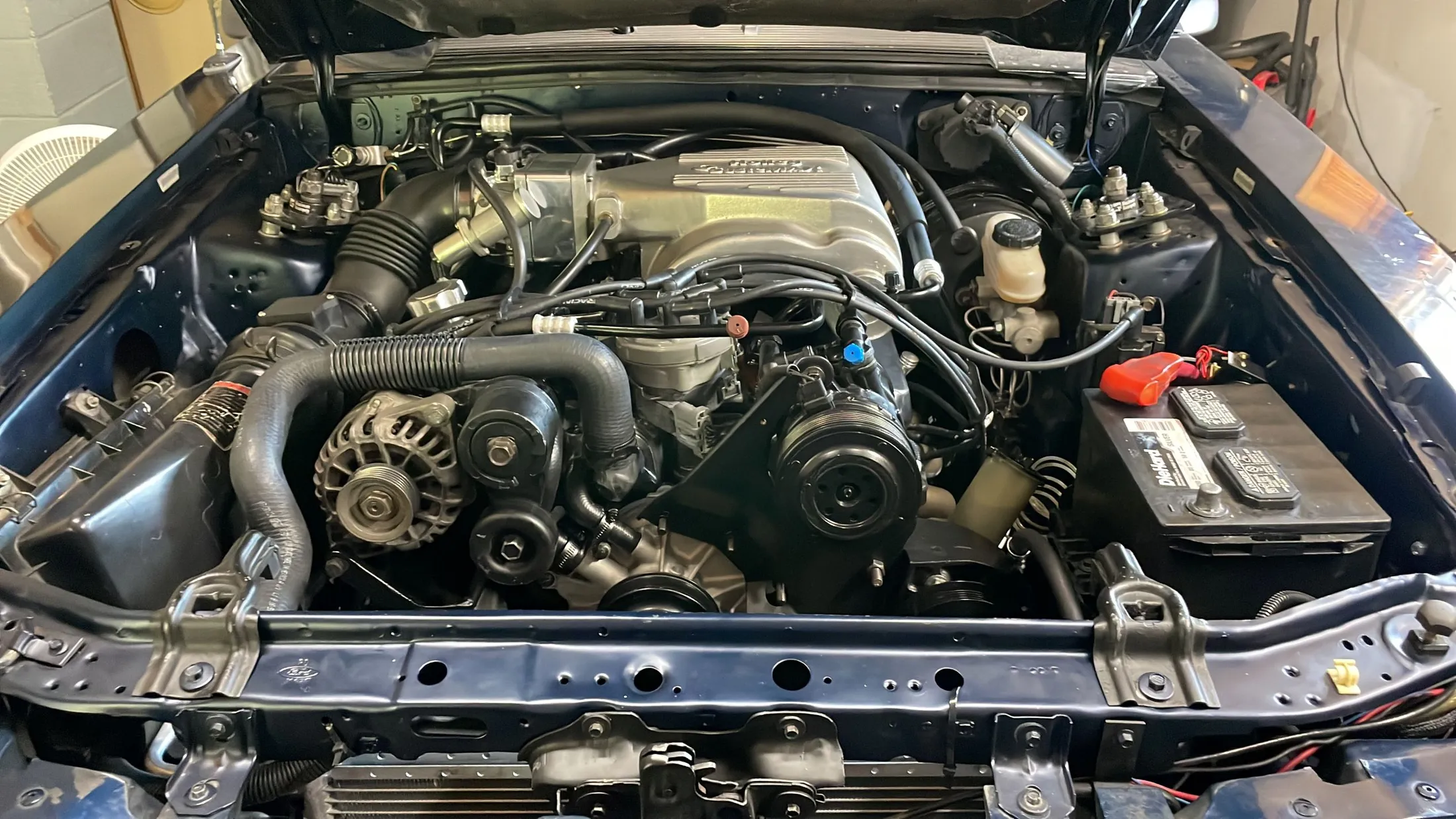

Once I got it back from the shop - it was full steam ahead to get the engine back in the car. I had already re-loomed the factory harness - so that went right back in:

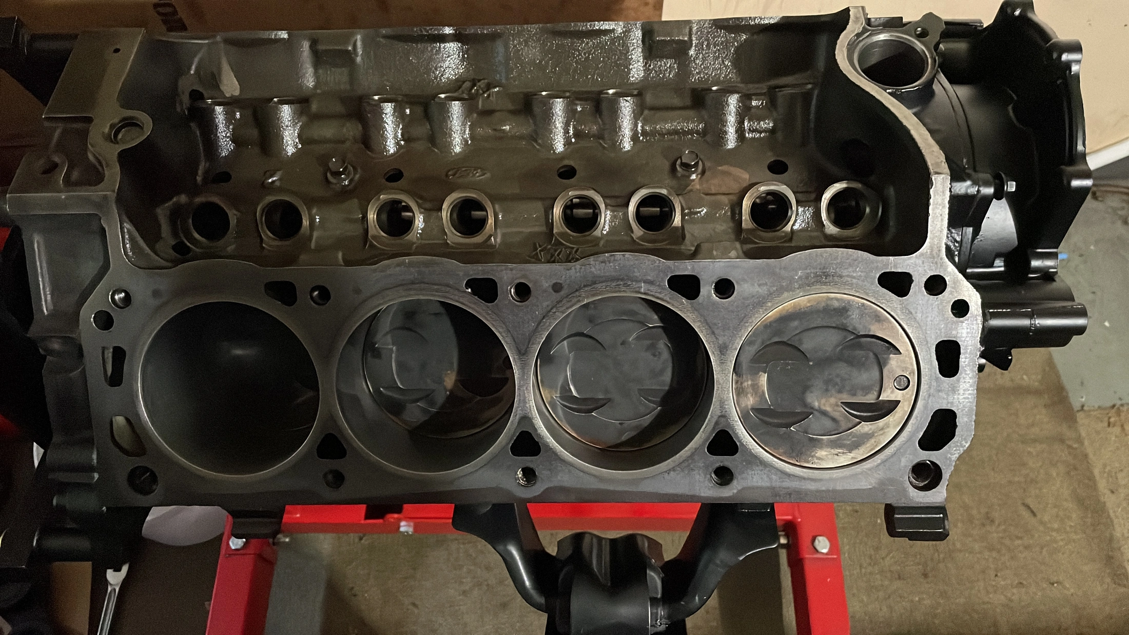

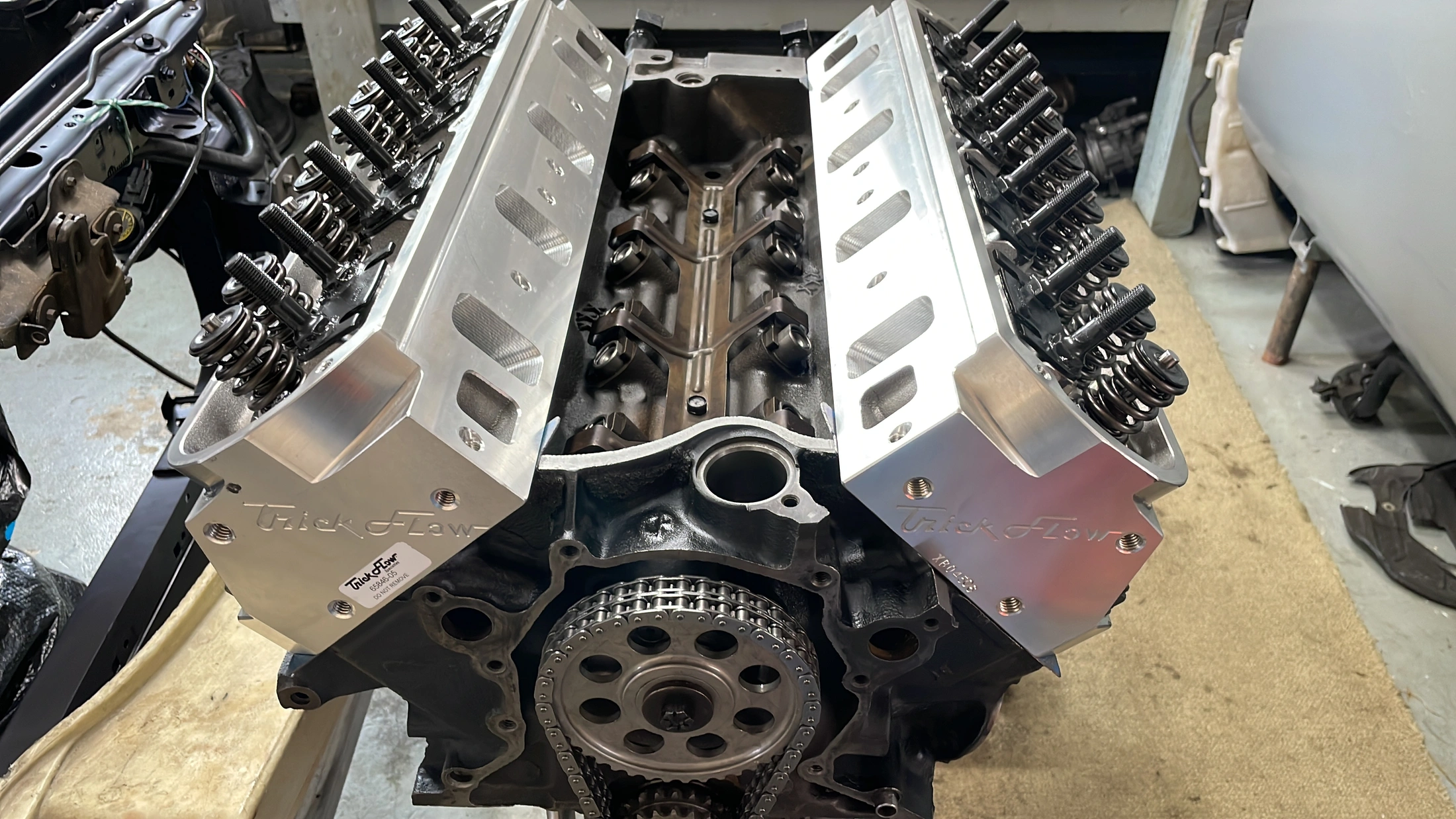

Now it was time for the engine, cleaned everything as best I could, put new rings/bearings and new custom cam:
And now the heads (TFS 11r 190cc):
And bam installed:

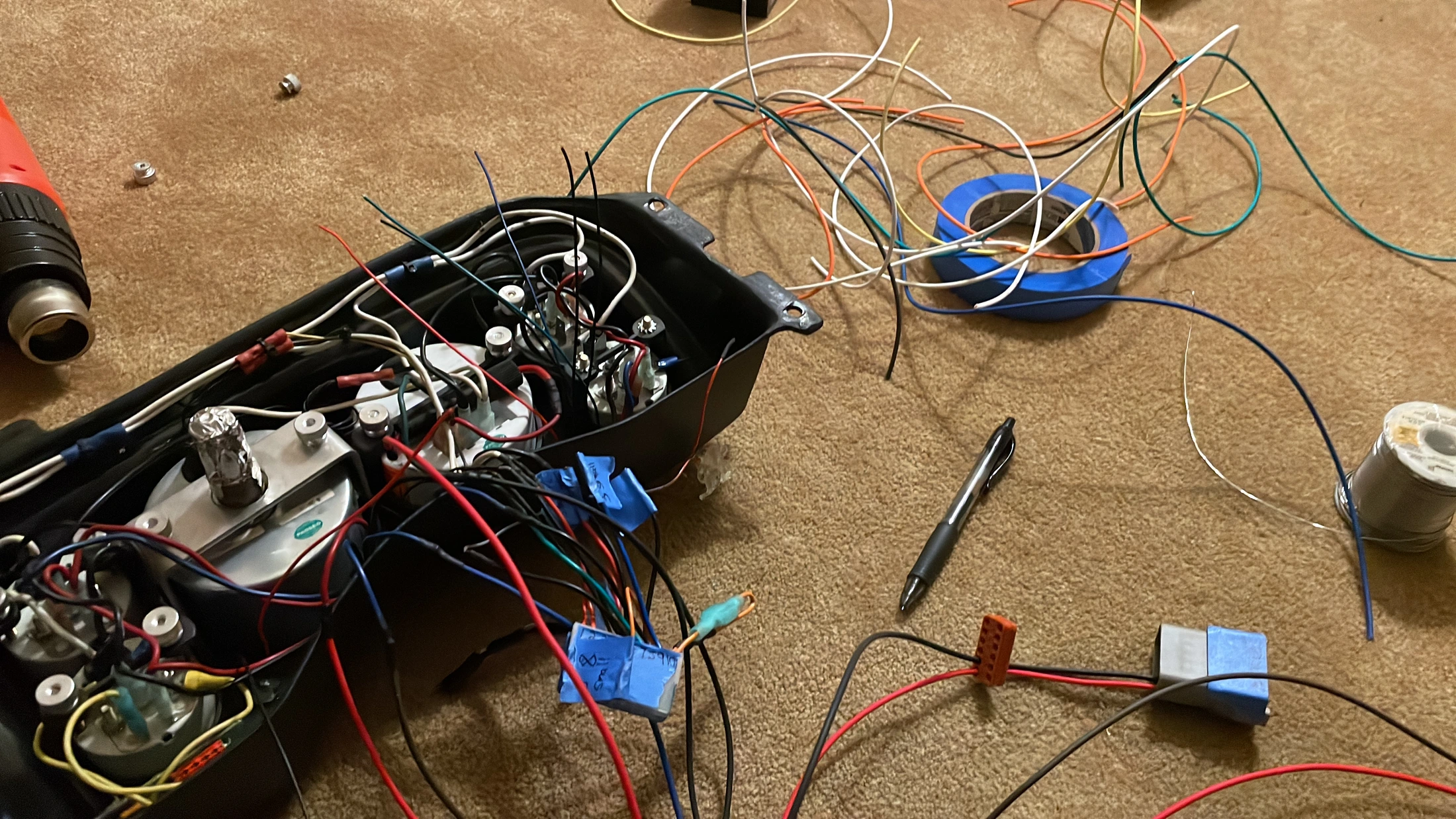

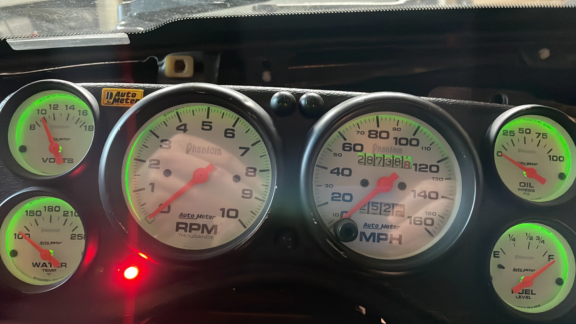

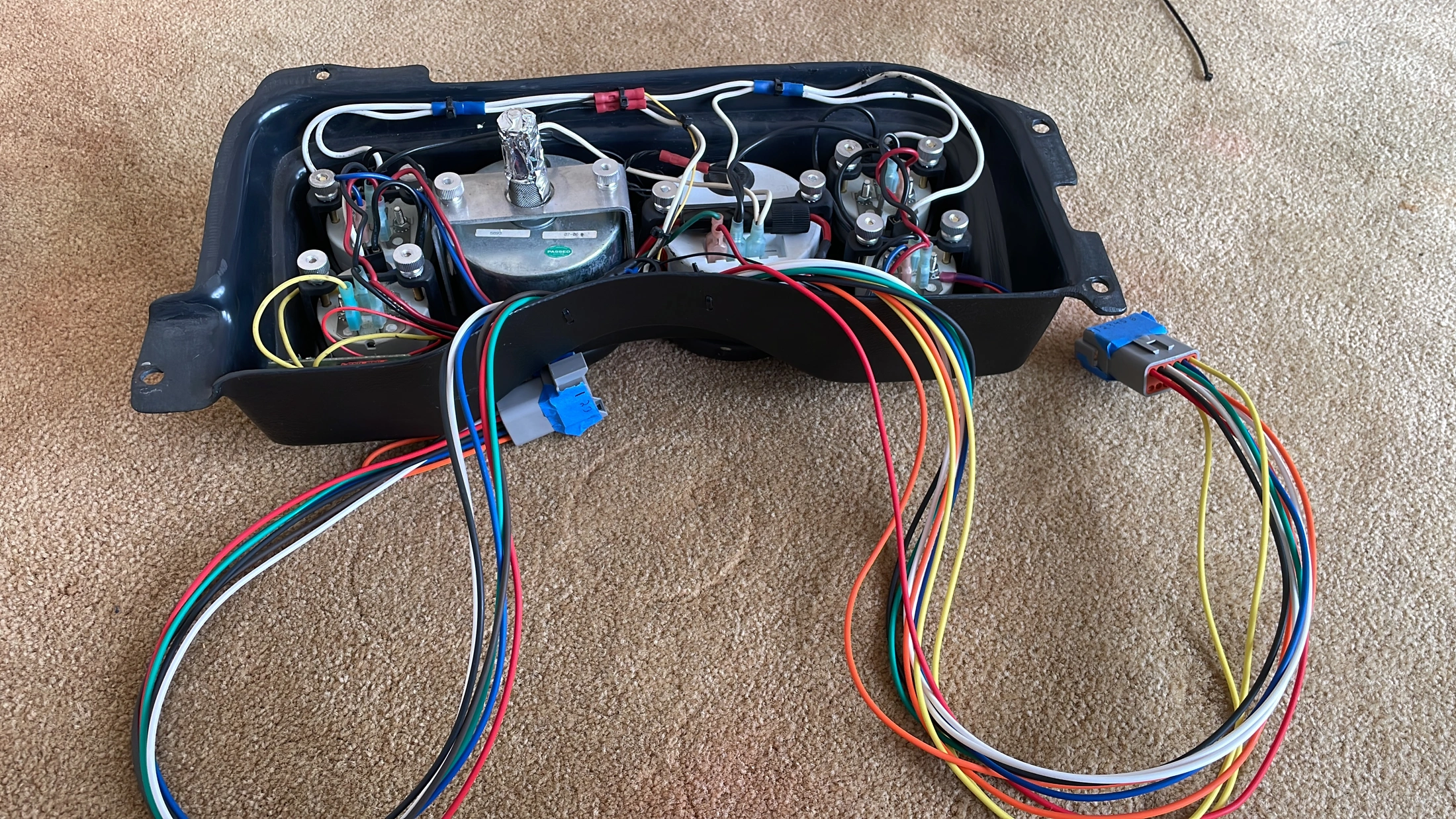

Had to re-wire the gauge cluster as I originally used some crappy computer connector which kept falling apart:
and now:
And all working:
And finally driving!

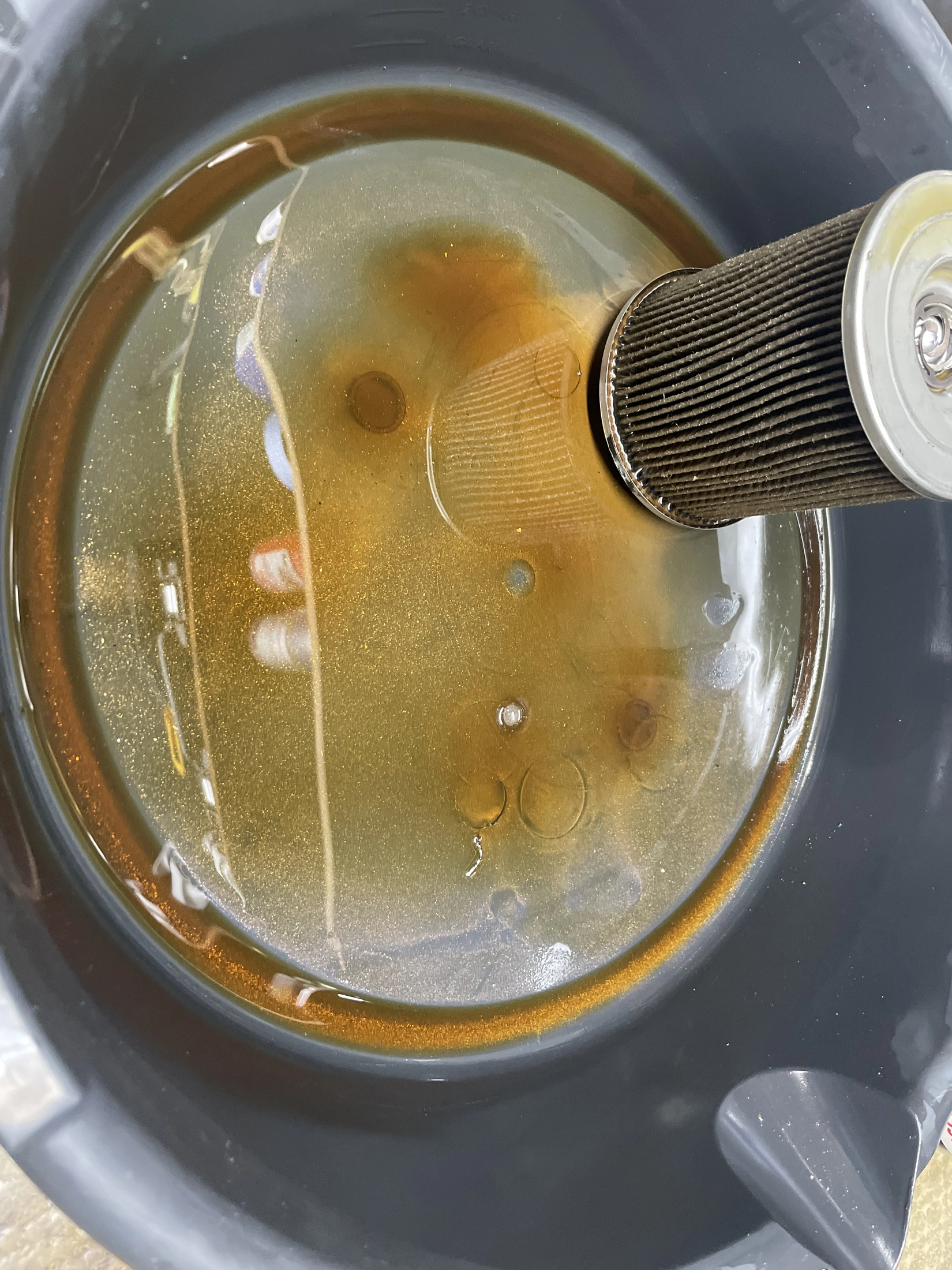

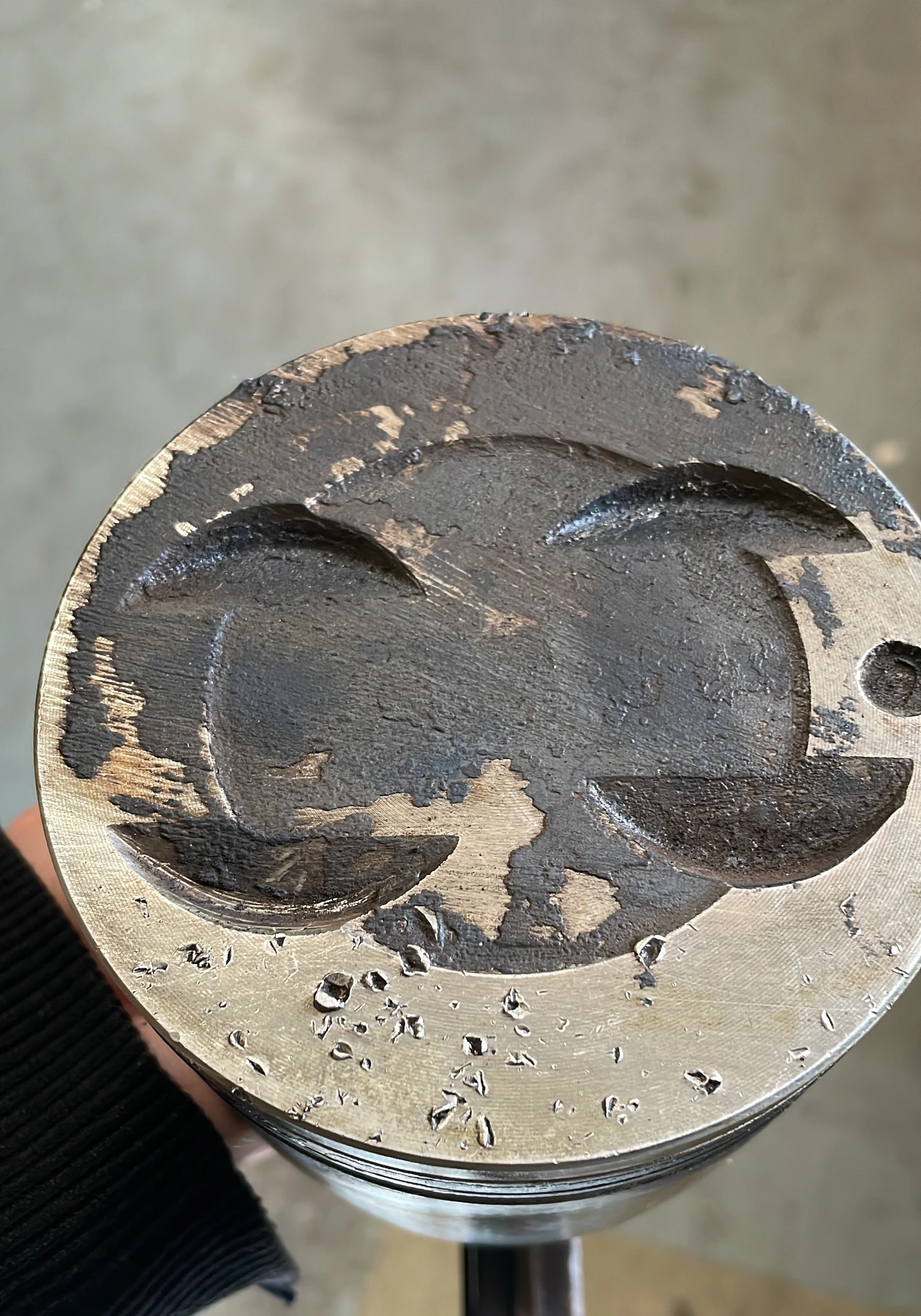

However it seems the car isnt done with me yet.. I changed the oil last week and took apart the filter.. and it wasnt good:

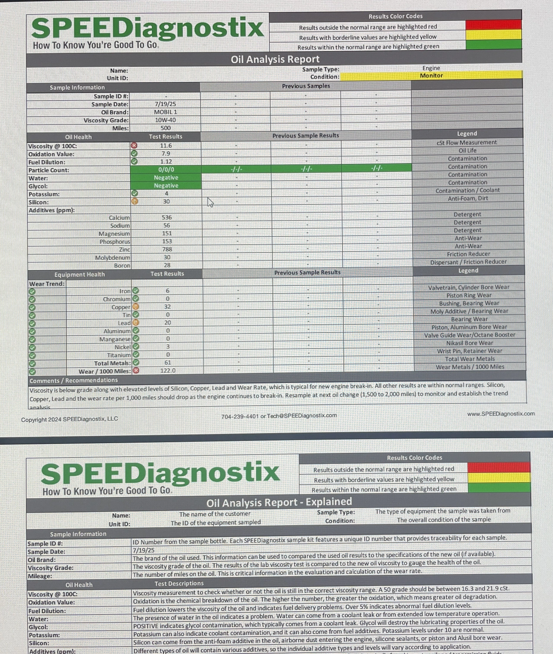

I sent a sample off for oil analysis.. and it seems like there is accelerated metals - bearing metals .. Sooooooooo back to the drawing board a bit...
Seems like the best course of action now is the install that holley system I have ...
And I might as well replace that leaking tailshaft seal and the worn out throw out bearing, so trans is out also....
For the engine.. my thinking is that I will try to drop the oil pan and visually inspect some bearings.. I remember when re-assembling that the rod bearings had a hole in them that the originals didnt have.. I didnt think anything of it, but that may have been a mistake.

Yea ive certainly tossed around tons of ideas on going to a 302 based stroker, a 351 stroker.. a coyote motor.
Im still trying to figure out if the motor really is eating itself or not yet - I started out with 10w 30 in it - ran it about 500 miles and noticed that at hot idle, the oil pressure was a bit low (~15lbs). Figured i would switch to a slightly heavier oil - so I went with 10 w 40 next time.. and the hot idle oil pressure was the exact same.. 500 miles later I figured oh well might as well try something heavier - 15w 50 .. and yet.. the oil pressure is still exactly the same at hot idle - 15 psi. Tested with 2 different senders/gauges (1 mechanical) so im pretty confident thats what it is.
Im going to try putting back in some 10w 30 and see, if its still 15 psi.. im almost wondering if its the oil pump?

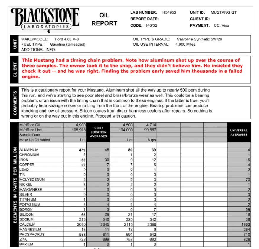

This sounds like a perfect scenario for sending an oil sample in for analysis.
There are others. This is just the first that popped up for me in search:
Oil Analysis | Blackstone Laboratories
Learn what's going on in your engine with oil analysis. Our free kits are easy to use and we explain the results in plain English! Since 1985.
www.blackstone-labs.com
Sample Report:
Gas Engine Reports | Blackstone Laboratories
Use data to monitor your gas engine's health and decide whether you can run the oil longer, what oil to use, and more!

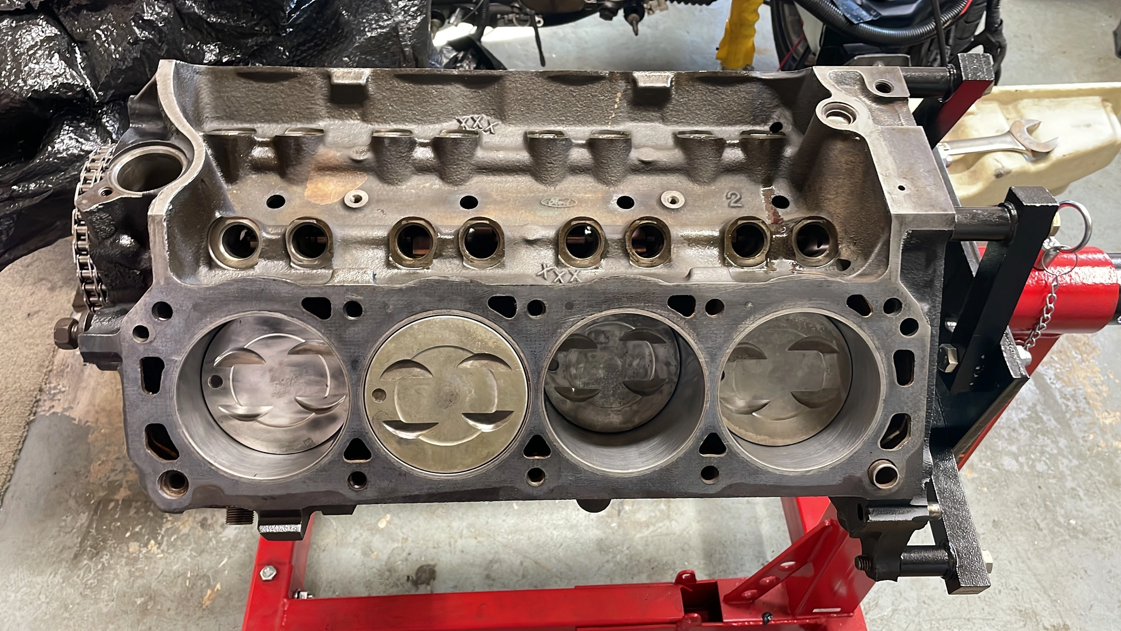

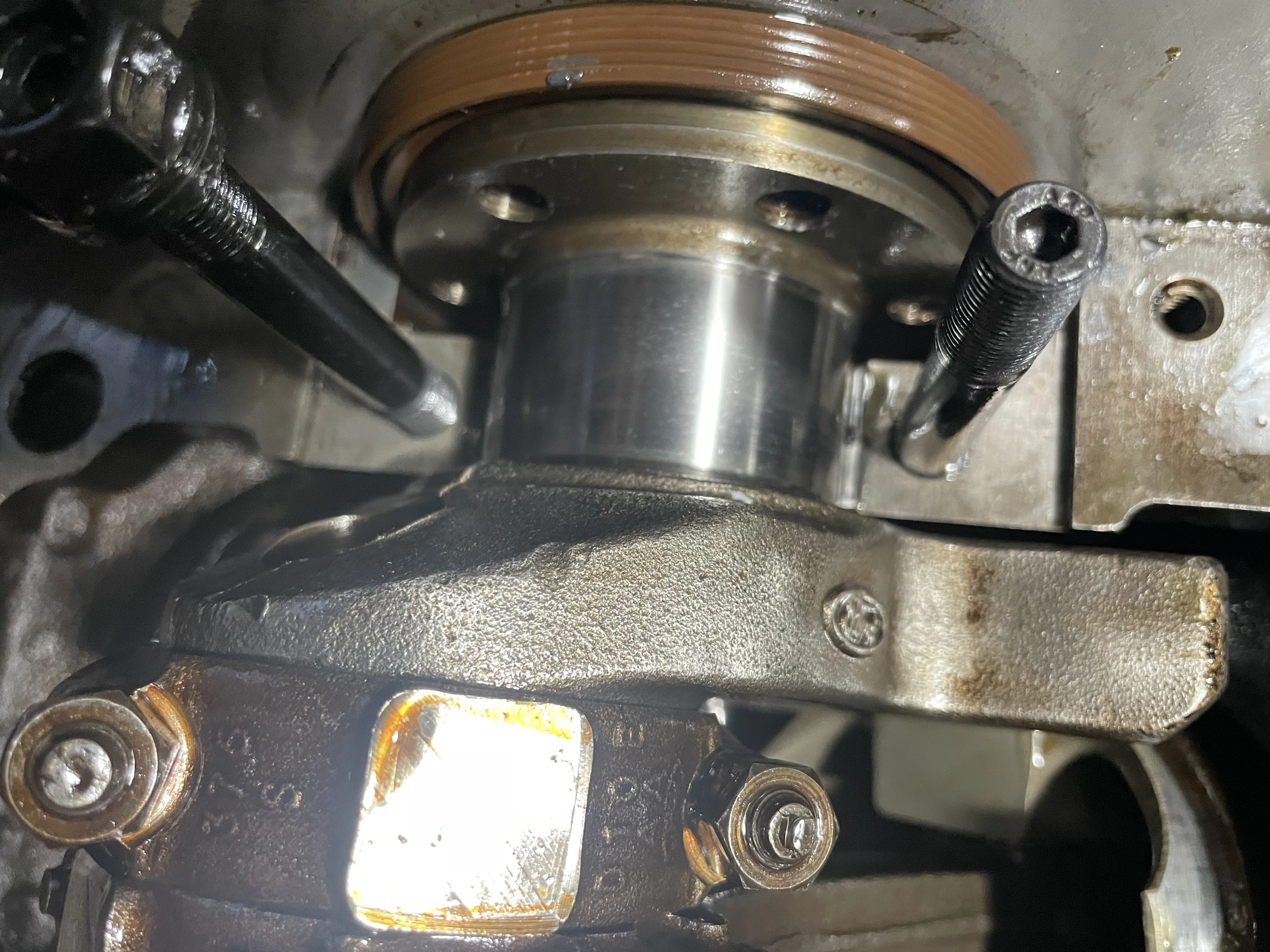

Yea i had sent in a sample actually - I forgot to post a picture of the results - that plus the dropping pressure is what caused my concerns...

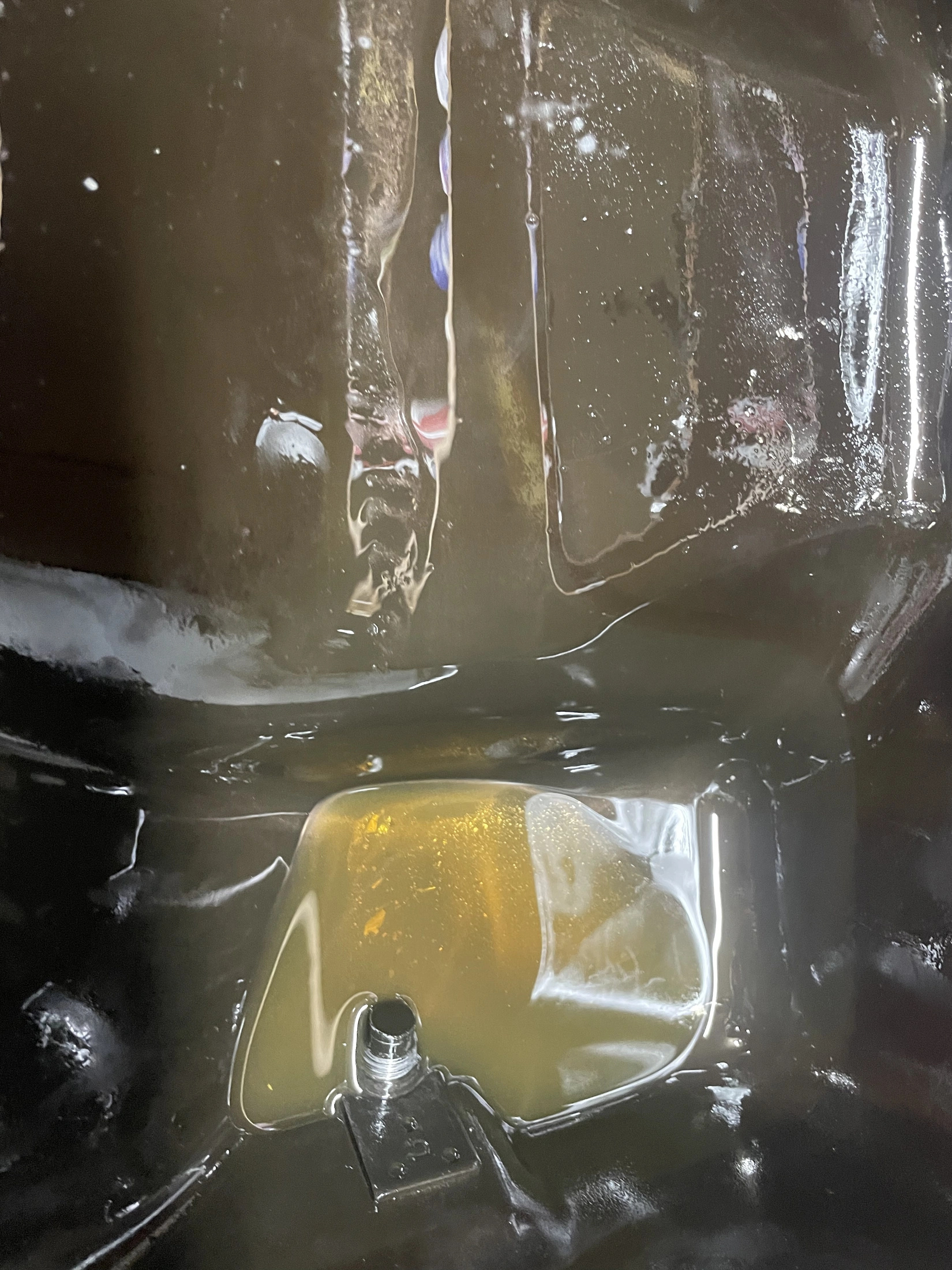

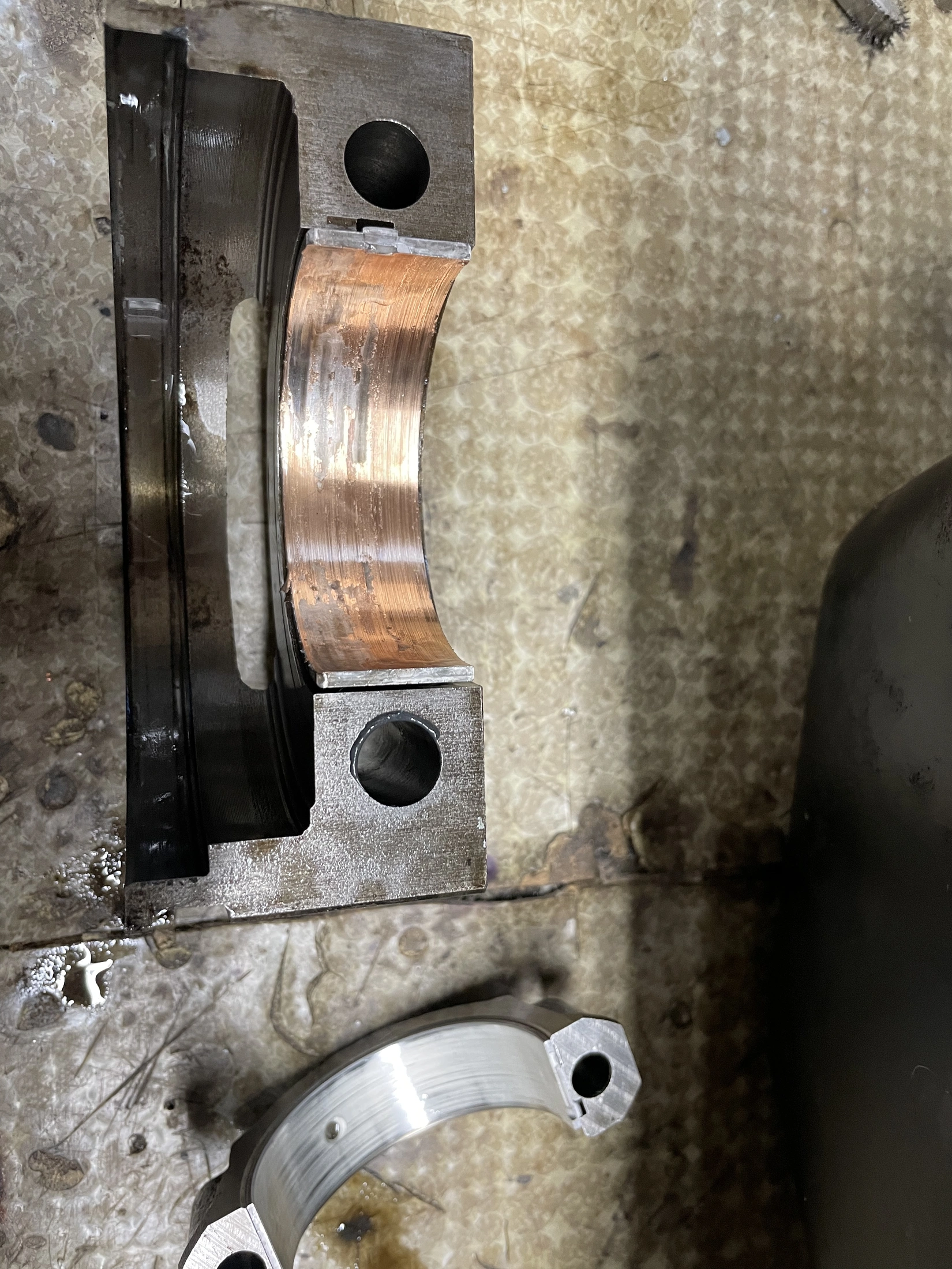

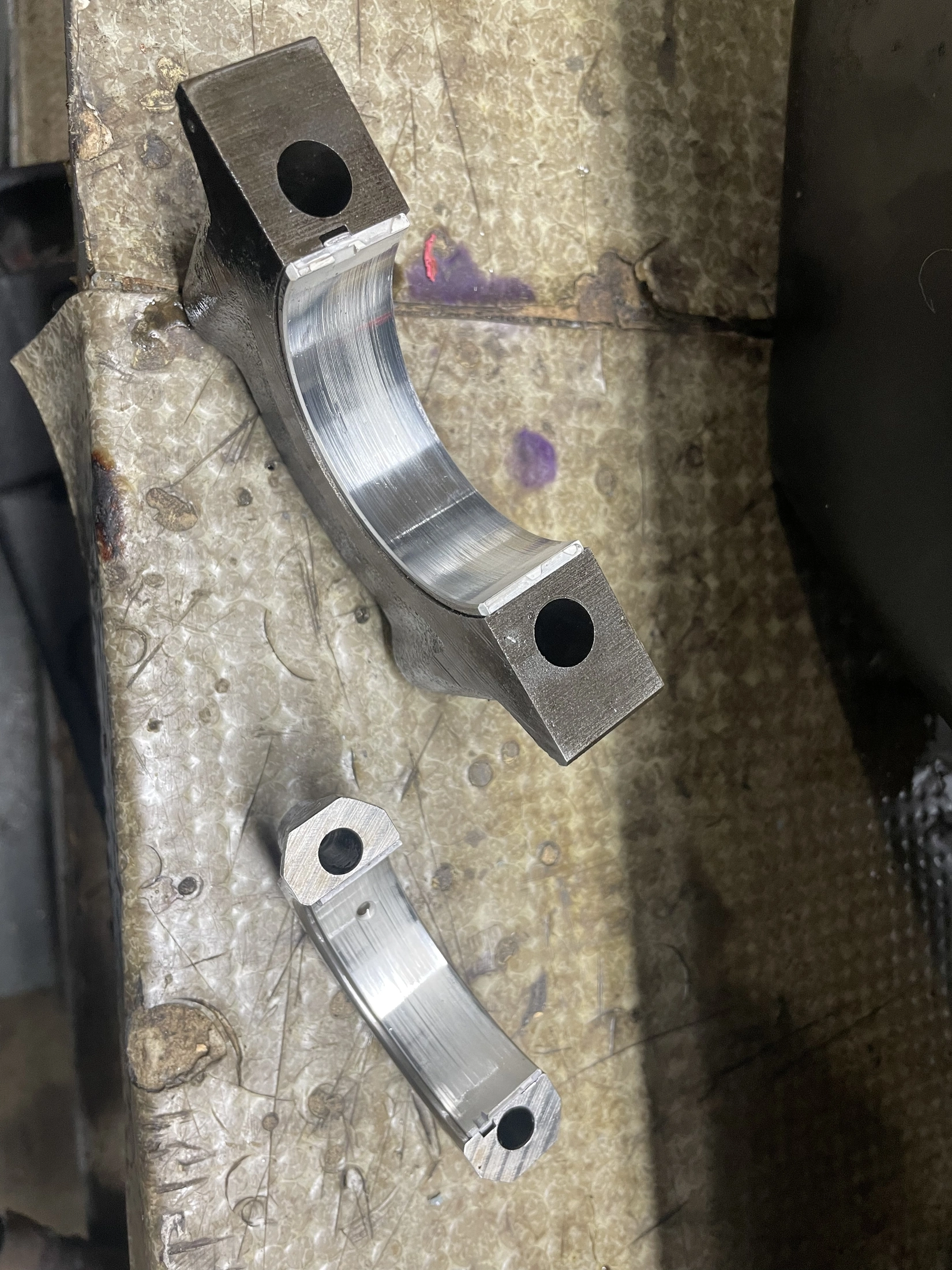

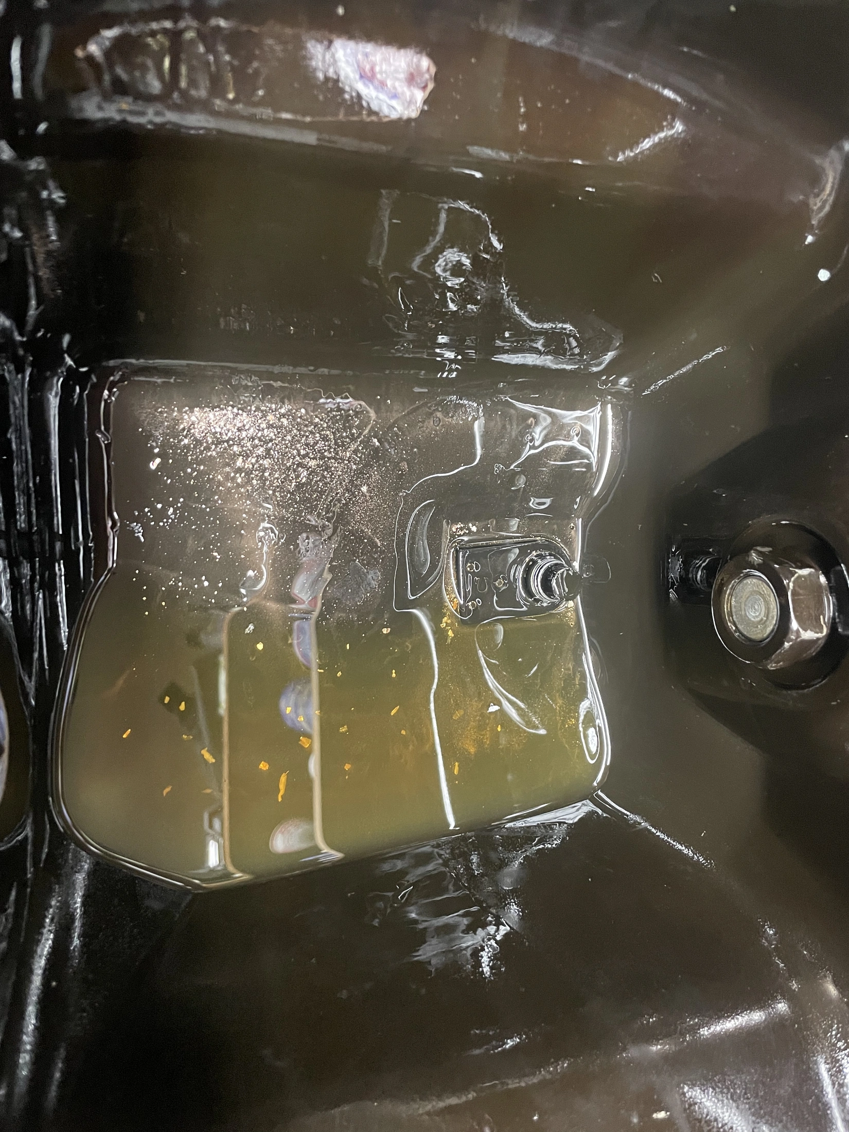

I decided to just drop the pan tonight - too more work to get it off than I hoped, but it pretty much does confirm my suspicion that something didnt go right with the rebuild:
I had cleaned the pan pretty much spotless when I re-assembled everything
I checked only 1 main cap and 1 rod so far - ran out of time, but they didnt appear to be the cause - but certainly got alot of crap run through:
Time to keep checking for the Red October.. i mean the bad bearing.

Can you feel those scratches with your fingernail?

I didnt have the block or anything machined or cut - it was just a stock rebuild in the same block - same crank/etc as before and everything was running fine.
I did check a few cylinder bores for taper etc, and did check a main or two as well with a bore gauge and everything was within spec. Same with clearances on a couple mains/rods with plastigauge - also all within spec. But I know I didnt check all of them - which I wish I had now .
On that previous main and rod cap, my fingernail doesnt catch on any of those marks - but I found atleast one main that appears to have spun and is trashed:
The crank 'looks' okay so far - but im going to pull the motor at this point so I can fully inspect everything

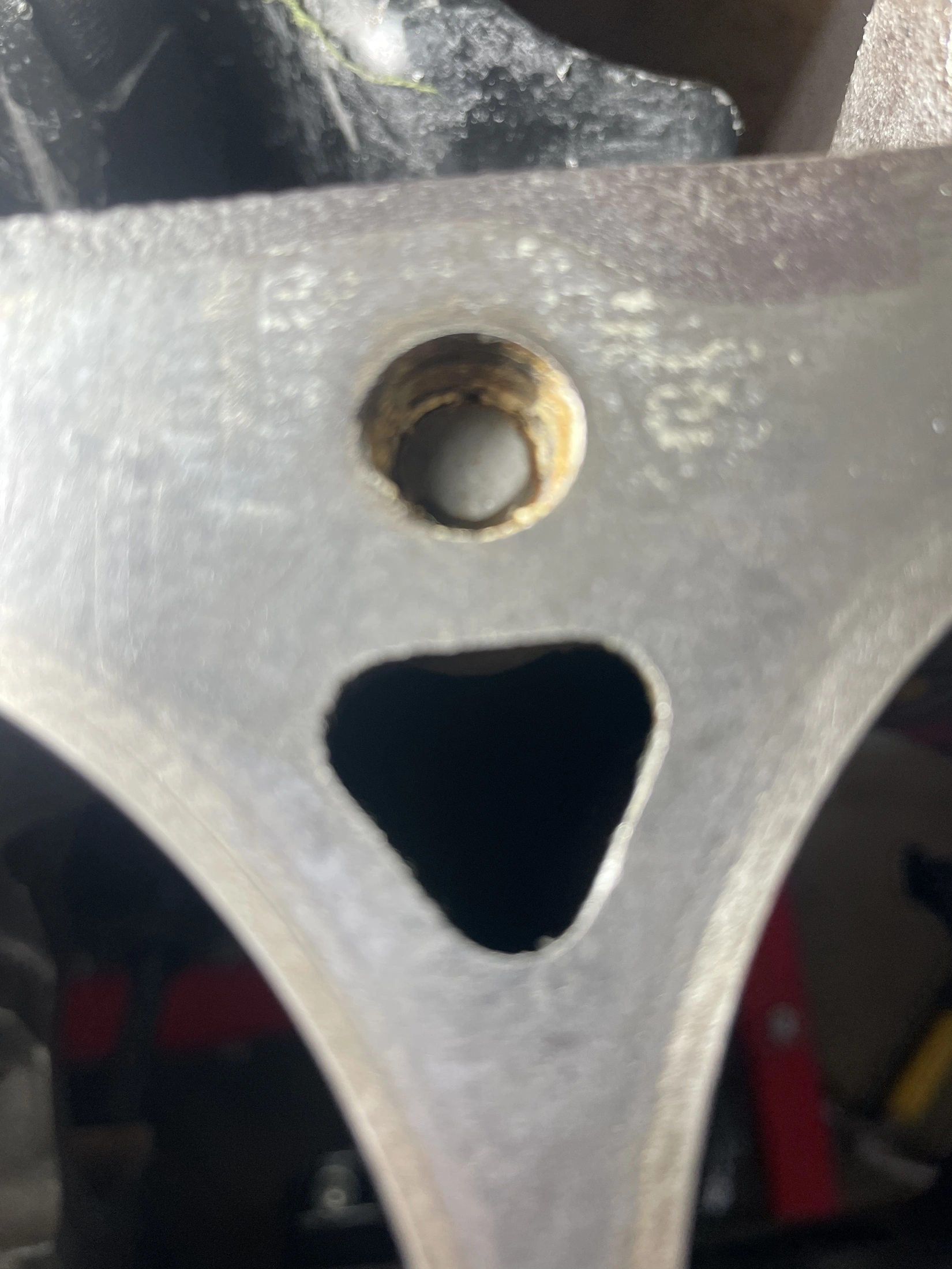

Got the crank back and cleaned on Friday, so I was able to get the shortblock back together again:
Was hoping to get it further along but I found one of my head studs was possible defective or I just broke it when removing the stud with the tiny allen key (its an ARP stud ) It came right out with an easyout so it wasnt frozen in the block or anything, but need to get a replacement one somehow....

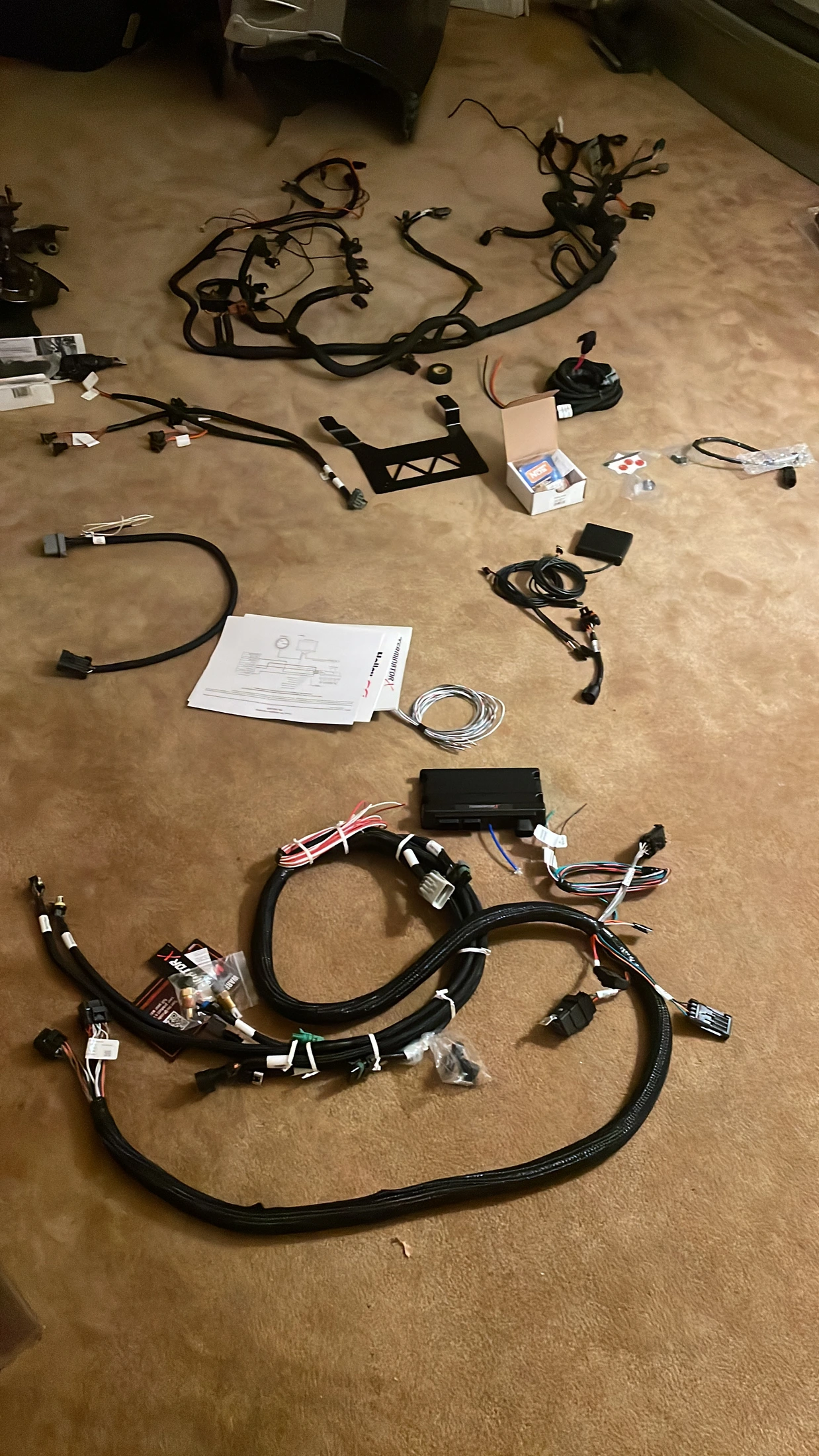

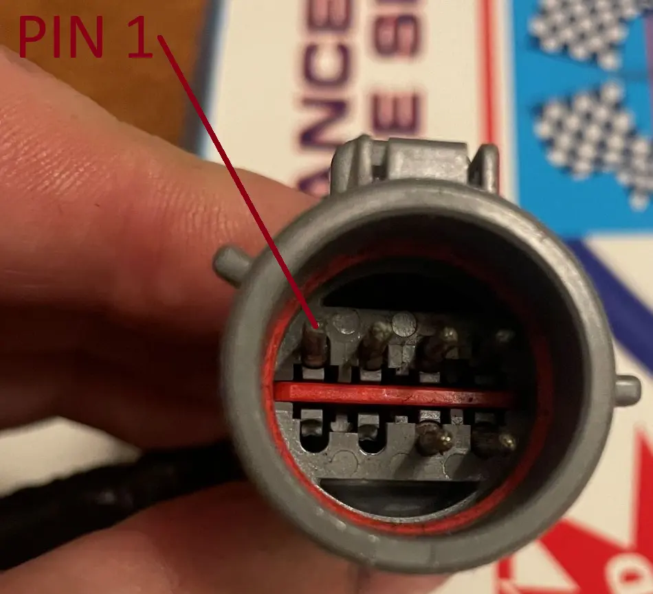

Also got the holley terminator X kit installed, and figured I would detail out the approach I used as I think it makes for a cleaner (ish) setup in the end and doesnt involve hacking any wiring or re-using the factory engine harness. The holley kit I got comes with a complete engine harness (for all the sensors the holley setup needs), but doesnt directly interface with the existing connection points in a fox. I figured that most of the connections I would need must run through the 3 main connection points from the factory engine harness into the body harnesses, so I set out to detail that out:
These are the details I found:

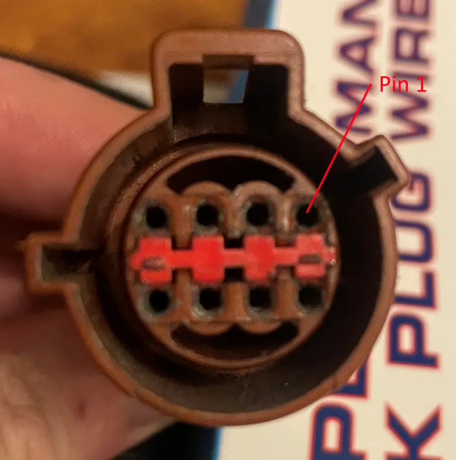

8 Pin female round connector under the hood:
Pin 1 - Neutral Safety switch (i believe just a sense for the EEC)
Pin 2 - SIG RTN
Pin 3 - Water temp sender
Pin 4 - Tach (negative side from coil)
Pin 5 - Start signal to TFI
Pin 6 - O2 harness pin 6 (looped on manuals?)
Pin 7 - 12v switched on ignition (key on)
Pin 8 - Oil pressure sender
6 Pin male round connector behind passenger kickpanel:
Pin 1 - Fuel Pump Relay 12v source
Pin 2 - Fuel Pump Relay ground
Pin 3-6 - I believe these are all Airbag sensor wires

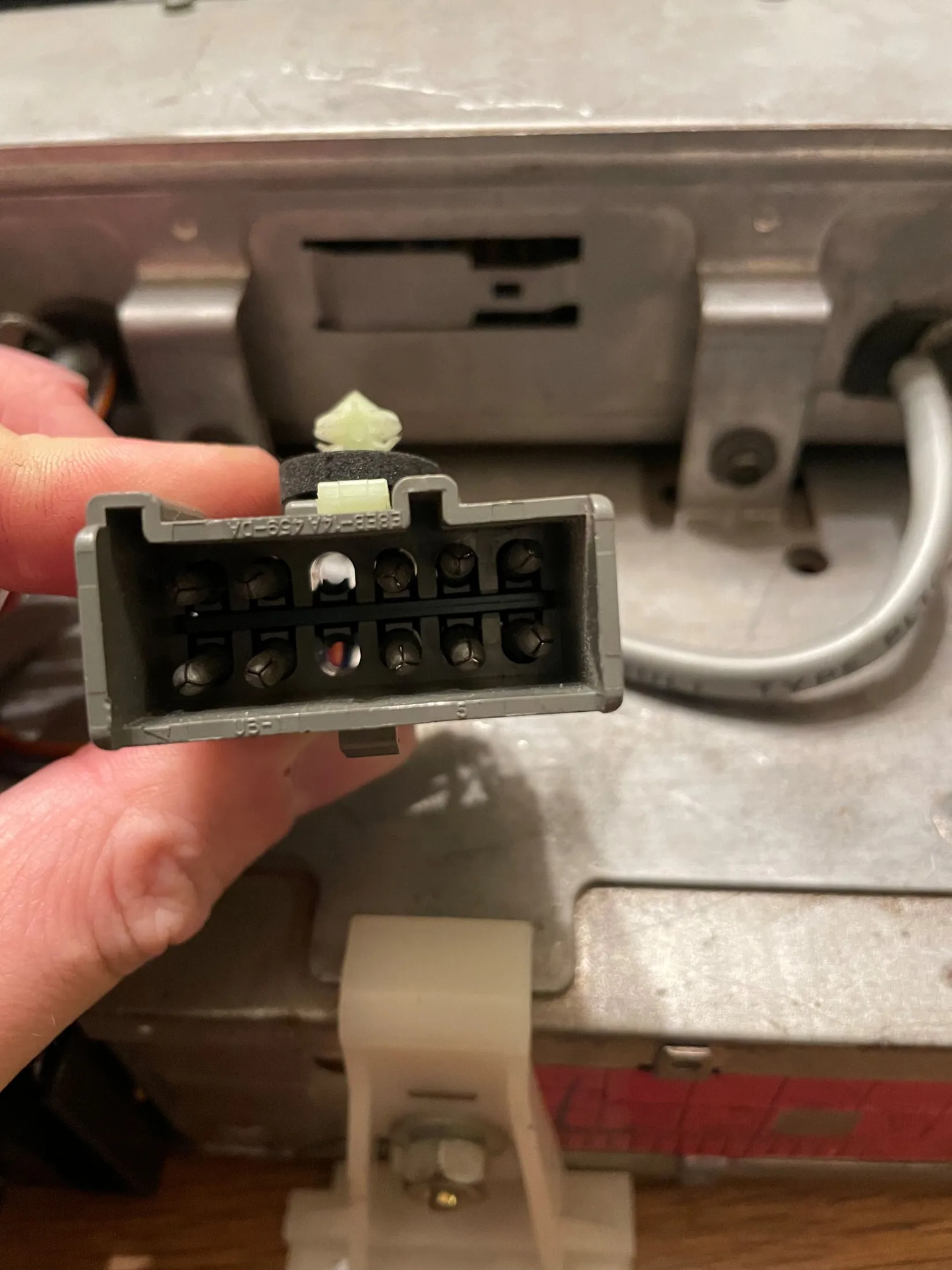

7 Pin female rectangular connector behind passenger kickpanel:
Pin 1 - Low oil level sensor
Pin 2 - VSS +
Pin 3 - VSS -
Pin 4 - Check Engine Light
Pin 5 - Oxygen Sensor 12v power
Pin 6 - A/C 12v from climate controls
Pin 7 - Fuel pump sense for EEC
With that info, I could add some additional wires to the holley engine harness and source some additional ford wiring connectors to make it fully plug/play. I figured I needed these connectors:
Under Hood:
  • Coil Connector
  • A/C Clutch Connector
  • A/C Pressure Switch Connector
  • 8 Pin Round Connector - Female
  • TPS Sensor Connector
Passenger Kickpanel:
  • 7 Pin Square Connector - Female*
  • 6 Pin Round Connector - Male*
* Both of these are actually 8 pin connectors, just not all pins are populated in our cars​
The Coil, A/C Connectors and TPS can all be got new from LMR, but the others were more of a challenge.

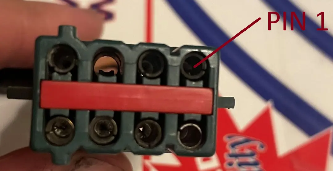

I found the 8 pin square connector is the same thats used in an excursion power seat switch, but it was also in a ton of other vehicles - https://www.fordpartsgiant.com/parts/ford-switch-asy_f65z-14a701-aa.html
I was able to find a junked seat switch and snip the connector. The wire guages are a bit different, but I only used it for the 12v A/C signal from the climate controls.
The two Round connectors are actually two genders of the same style 8 pin round connector, it appears Ford used them in all sorts of other situations. I found that they were used in rear wiper motors on 95-96 explorers, and happened to find a trashed motor and grabbed both sides of the connector
It looks like you might be able to get the male side new, MOTORCRAFT WPT257/WELLS 1P1764. I didnt have much luck finding the female side new however unless you got a replacement wiper motor for said explorer, which would have the female side...
With those connectors all sourced, I added some extra wires to the holley harness for the factory guages, coil power, A/C pressure switch & compressor clutch and a adapter harness from the GM TPS connector holley uses to the ford one. After that i just yanked the old factory engine harness and computer out, ran the new holley harness and computer and plugged everything in. I had 2 wires I ran to my 12v battery fuse box as well, but everything just plugs in with no cutting or hacking of existing wires.
Now with no engine I havent fully tested everything yet but I will update this once its all back together and I can test it fully, but so far all the basic sensor tests I have done all look correct.
Pin 2 - VSS +
Pin 3 - VSS -
Under Hood:
  • Coil Connector
Man that sucks about your main bearing! The rod bearings can be with or without the holes in them...doesn't matter. The hole is there to support rods with squirt holes. Your fox looks great!

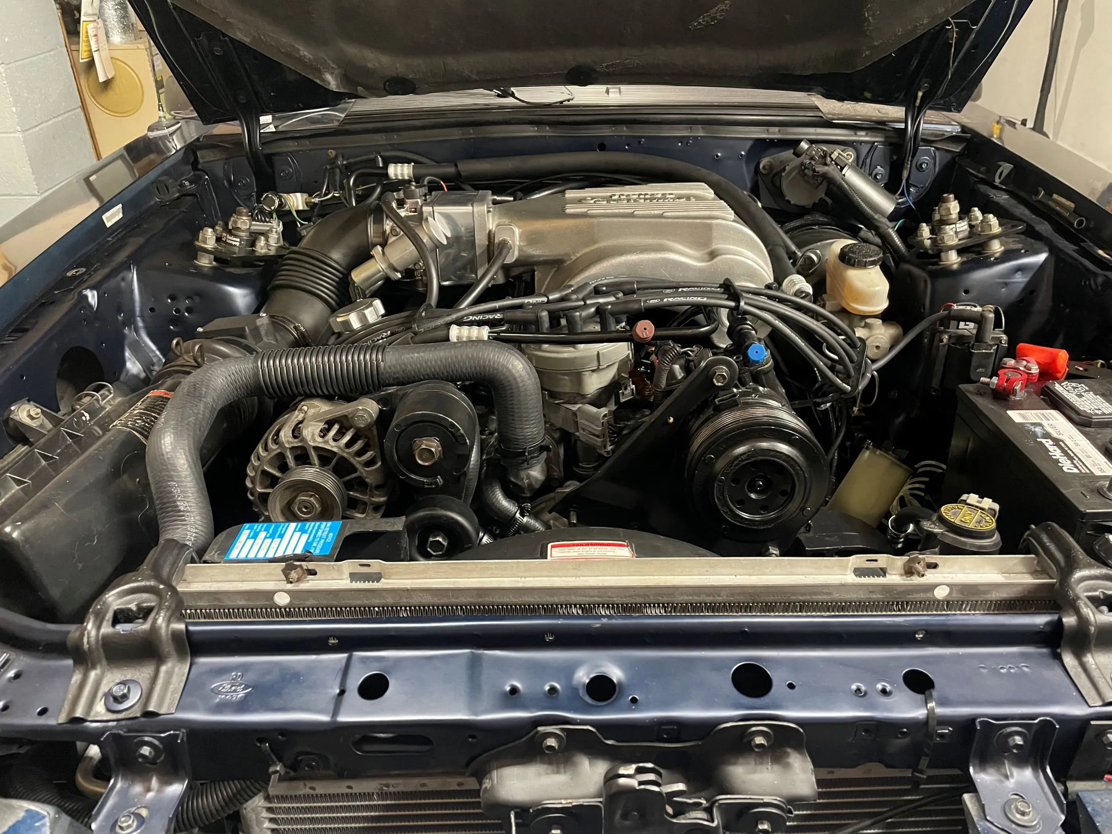

Got the motor back in the car, but found my brand new mishimoto radiator is twisted. Its not bad enough to really notice unless you place it on a flat surface, but its very obvious within the car and makes the fan not fit at all . Hopefully i can get that sorted soonish or figure out some temporary solution so i can test-fire the car.

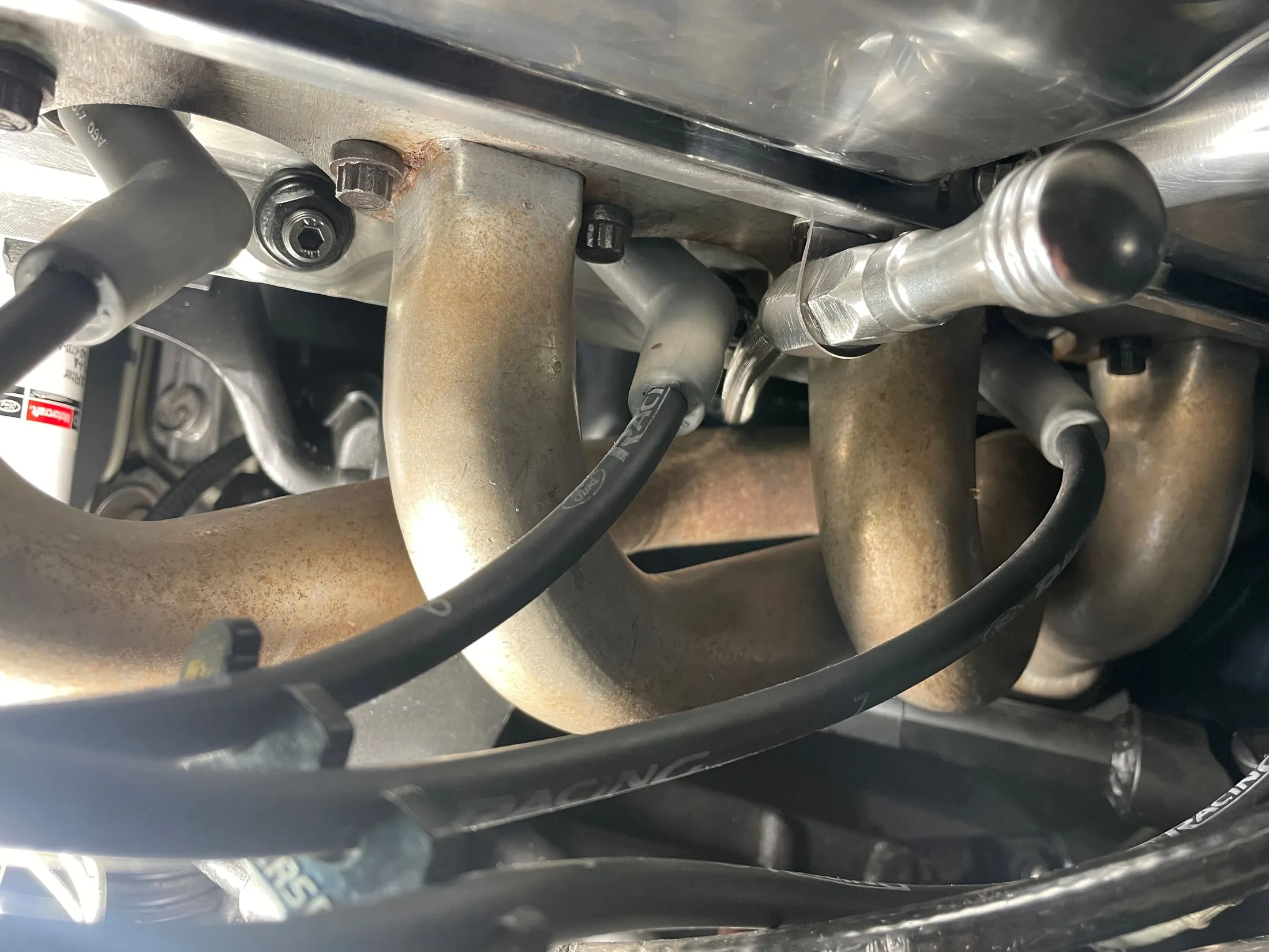

Also, the moroso oil dipstick is super close the the headers, anyone have any suggestions on the best way to route that with shorty headers?

Put my original radiator back in just to test run the engine for a bit. She fired right up and idled nice, held good oil pressure the entire time (around 60-65 psi) with the 30w break in oil. I only ran it for 10-15 minutes as the old radiator leaks and once it starts building pressure it makes a bit mess, but everything sounds good so far! Now just to get mishimoto to warranty the twisted new one

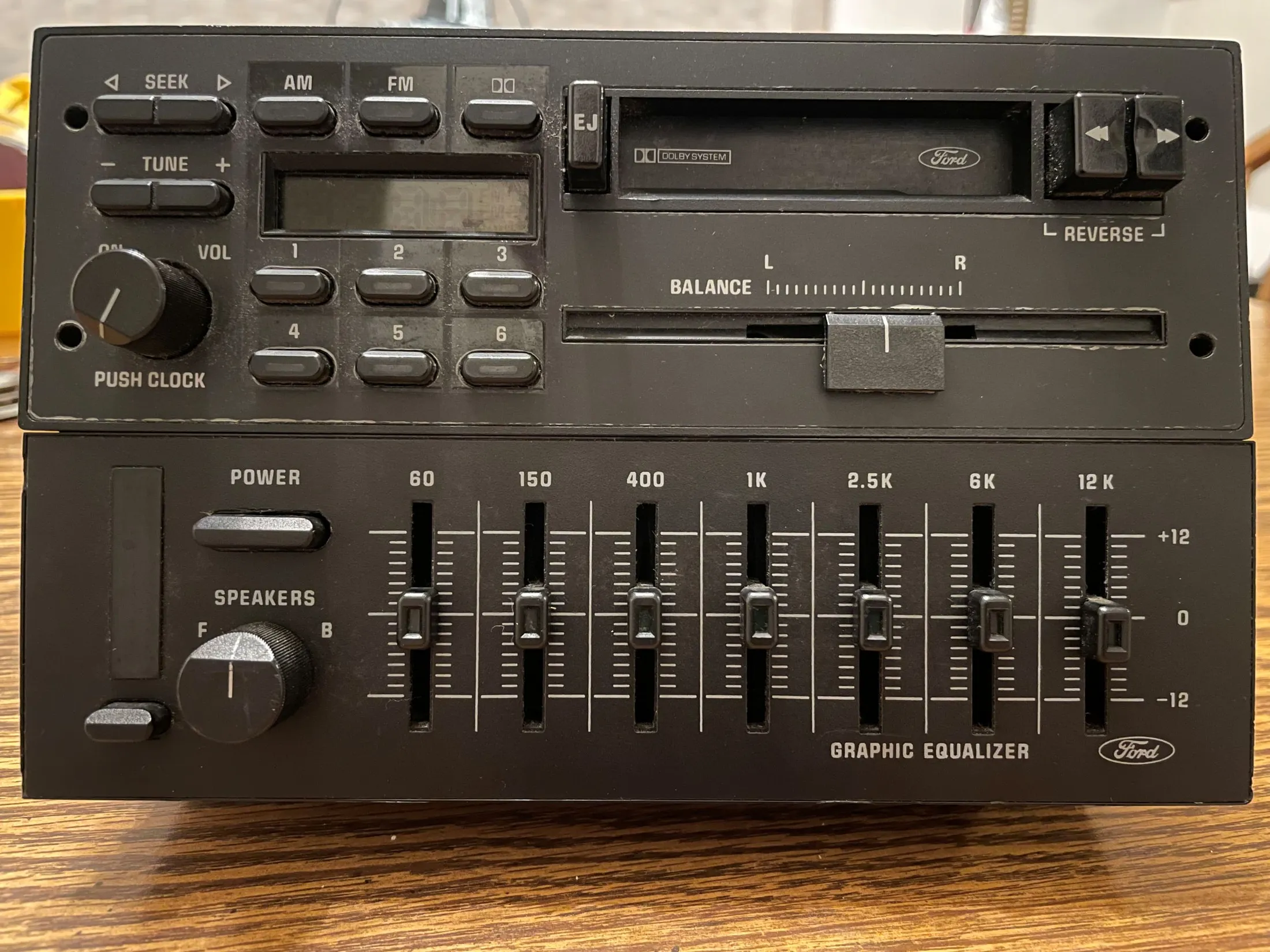

While I wait for that I figured it would look over some stock radio parts I collected, and I realized that the EQ radio must have a different harness than the standard premium sound (football amp) harness. I found a diagram so I think i can make an adapter harness, but havent been able to find a source for the female end of this plug - anyone worked with this before?
The connector part number is E8EB-14A459-DA, which i think indicates a late 80s escort as a potential original source?

Why not use a common connector with the required number of pins?
Also: Check Crutchfield. They have a host of weird adapters.
