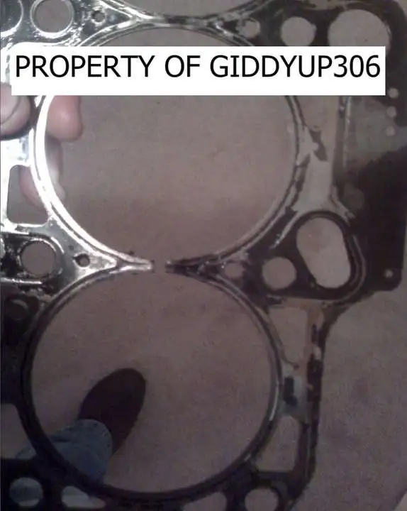

I personally would stay away from MLS gaskets. As mentioned they can be a lot less forgiving as a printoseal type gasket. Some guys that run high boost applications refer to them as "fuses".
But you CAN burn a MLS gasket. I replaced this one last weekend.
Nice Job Mike.... What happenend?
