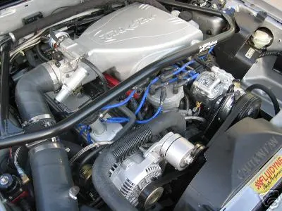

I saw this on ebay, but I'd like to see a pic with the cover off the car to get a feel for what he exactly trimmed away. It looks pretty good.

I looked at the photo. The top of the coil cover is square so he cut it at an angle maybe an inch and a half in from the corner that was in the way, and then continued cutting down from the new corner down into the engine. Simple, get a piece of cardboard and trace the top of your coil cover on the cardboard. Cut the cardboard peice out and start making a template using the cardboard to size up how much plastic you need to cut off at the strut tower. Once you find the perfect fit, get a white fabric pencil and lineup the cardboard template to your plastic coil cover, mark off the cutting points and start cutting. Real simple and you can't f#$k it up doing it this way.

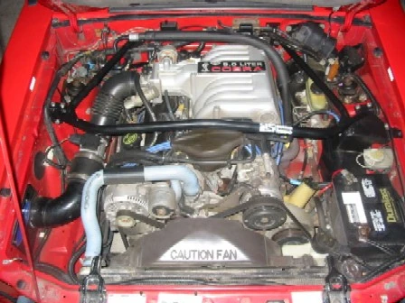

I actually bought the chassis brace kit (strut tower brace, k member brace, and standard length subframes). It was well worth the money. The quality will not disappoint you at all. The installation was pretty easy for the k member brace and stb. I had the subframes done by a shop. The hardest part about the stb was getting the vacuum hoses and wiring out of the way to install the bolt in the pinch weld on the drivers side. Other than that it just took patience. Here is what my car looks like now. Nothing is in the way of the oil filter.
