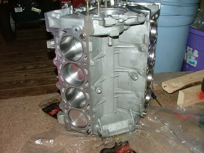

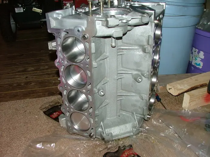

Here are the final build specs
piston to wall clearence.0035
top ring gap .025
second ring gap.022
piston weight 461
rod weight 605
rotary 442 ?
ARP main studs and rod bolts
Manley 18cc notched pistons and h beam rods
forged cobra crank.
I might go out and touch it some more.
All I have is a camera phone right now.

The base mod 900 is 2799. The notched pistons are 250 and arp's were 179 and I also got their high flow oil pump with cryo treated gears for 179 with the short block. So as litlle as 2799 for a 900 hp rated short block. I been working with Mark for a while and I saved alot of money. Almost 450 dollars. Mine came to 3346 after shipping. The shipping from Cali to here was 368.
