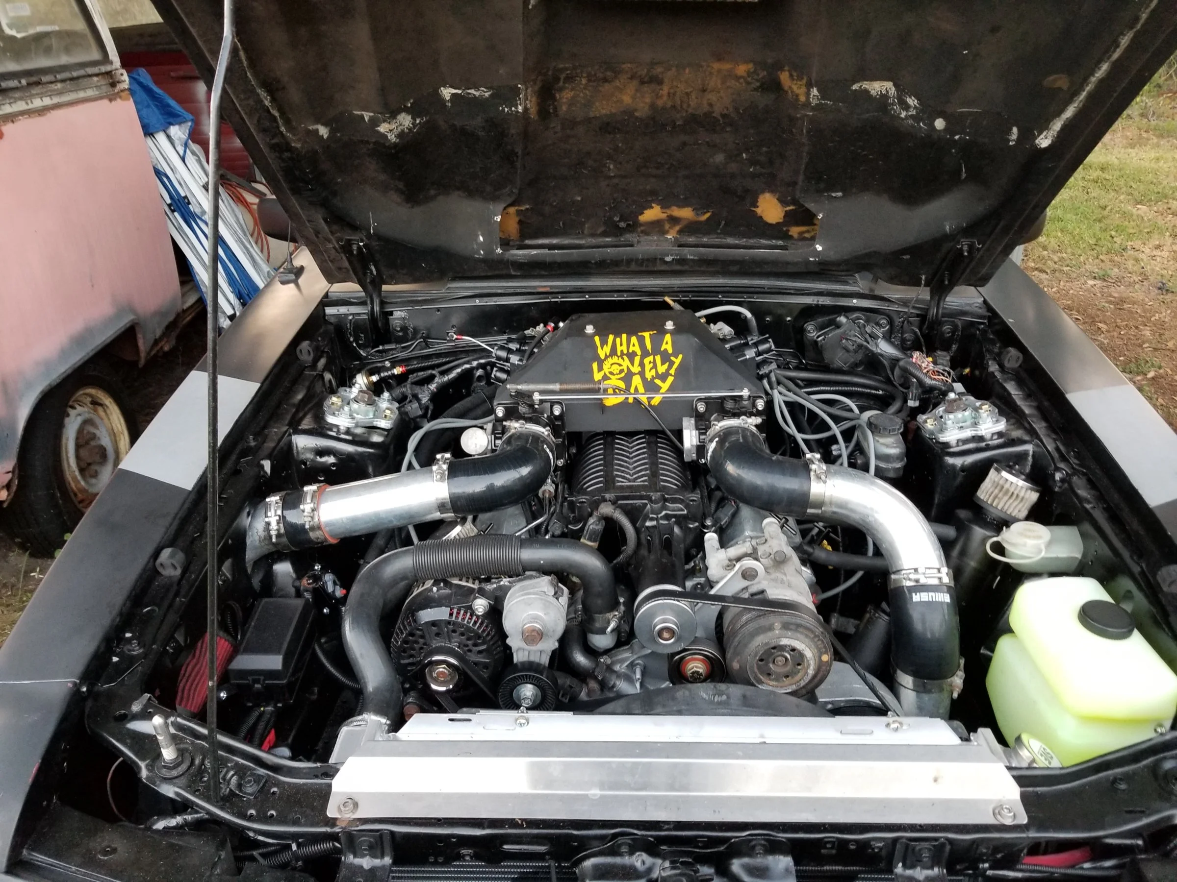

Hi Guys,
I've been looking for a used Vortech for the last few months but they are all out of my price range. I have come across a mint rebuilt Paxton SN93 complete kit for fairly cheap roughly $900. My mods are below...do you think this kit would be worth it and if so would I still be able to squeek by with the 24lb injectors? I'm roughly 315 RWHP as it sits with just motor. I'm looking to get into the 400's.
Factory 5.0 Block, Stock Forged Pistons with High Tension rings, honed bores.
ARP rod , main bolts and head studs
Stock 5.0 oil pump
Balanced bottom end
Comp Cams custom cam 218in/220ex degree .512/.512 lift/114 lobe centres
Ford Motorsports roller lifters
Edelbrock Performer Aluminum heads 1.94/1.60 valves
Chambers reshaped and blended at valve seats
Multiangle valve job
Cut for Felpro wirelock head gaskets
Intake ports matched to Felpro 1250 intake gasket
Exhaust Port walls blended from cnc port opening into runners
Extrude Honed Ported
Comp Cams dual valve springs
Crane HD pushrods
Ford Motorsports Cobra intake manifold
Ford Motorsports 65mm Throttlebody
24lb Ford Motorsports Injectors with 190LPH fuel pump
MSD Billet electronic ignition distributor
MSD 7AL ignition module with MSD wires and cap
Crane H.O Coil
Appreciate the help boys !!
