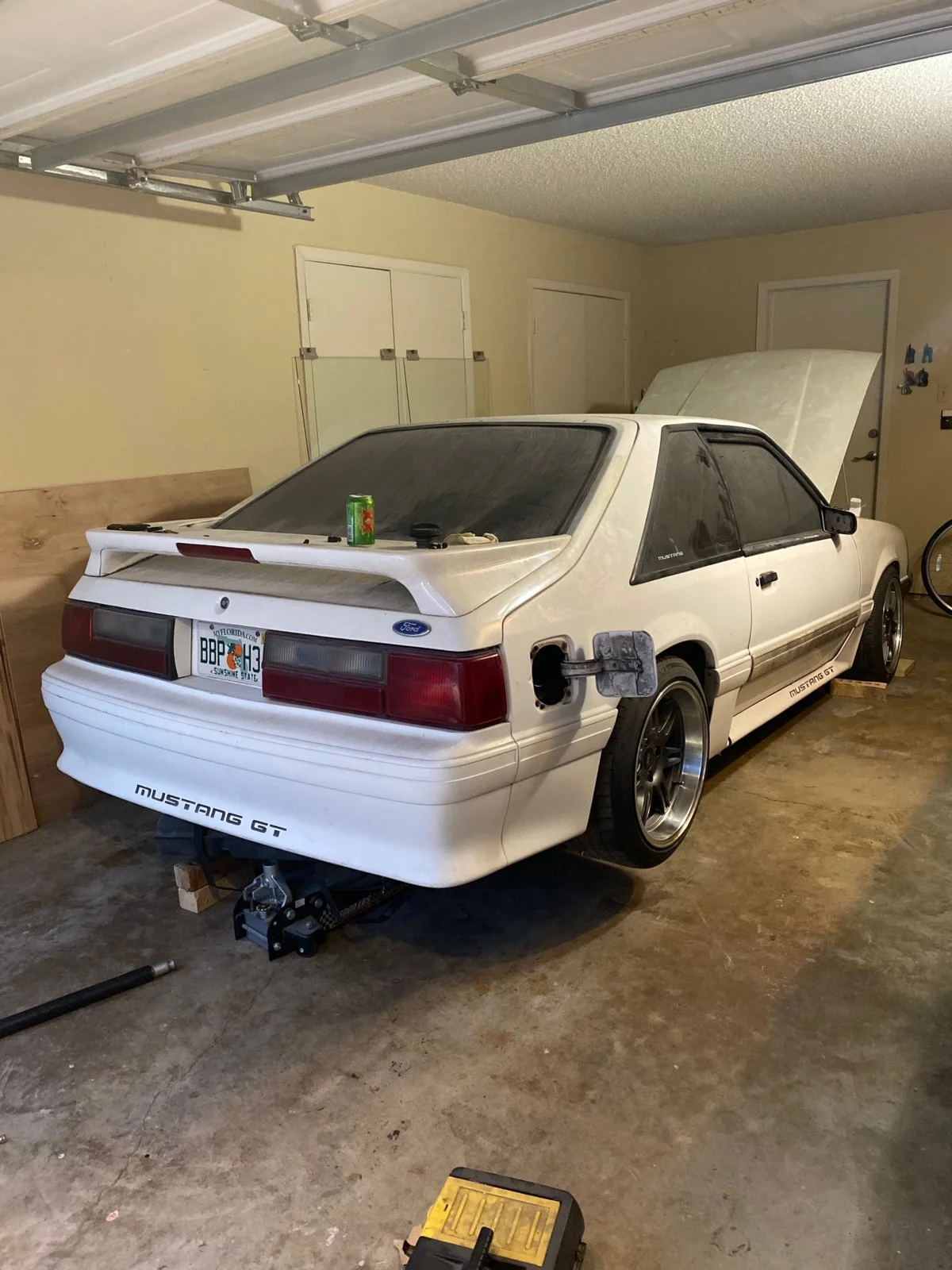

The car just stopped running a few years back, it would crank but it wasn't getting fuel, I could spray starter fluid and it would start for a second but that's it. So now that I have a little bit of money, and I have A LOT of time (COVID19) I decided it's the perfect time to start restoring her and clean her up.

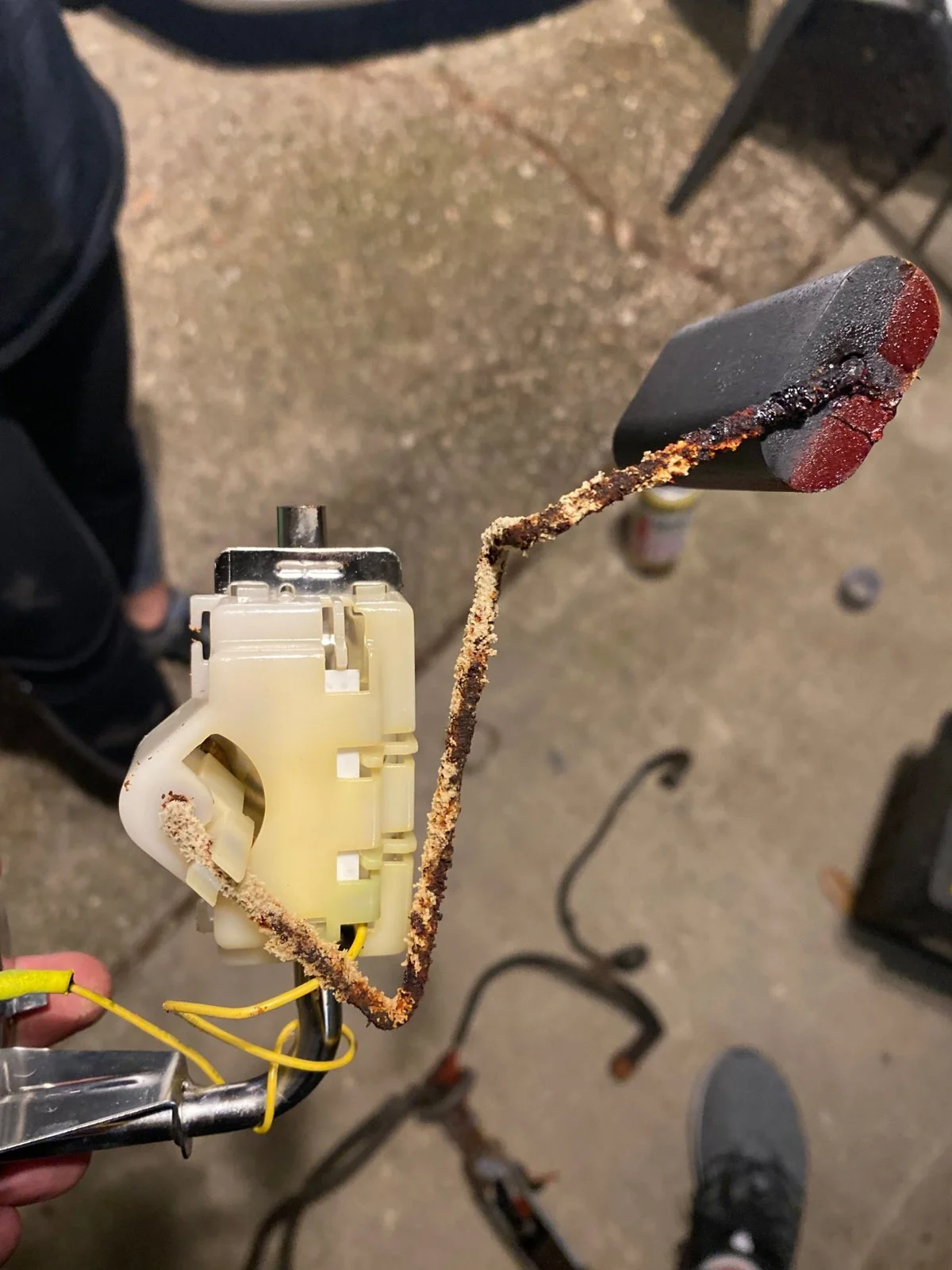

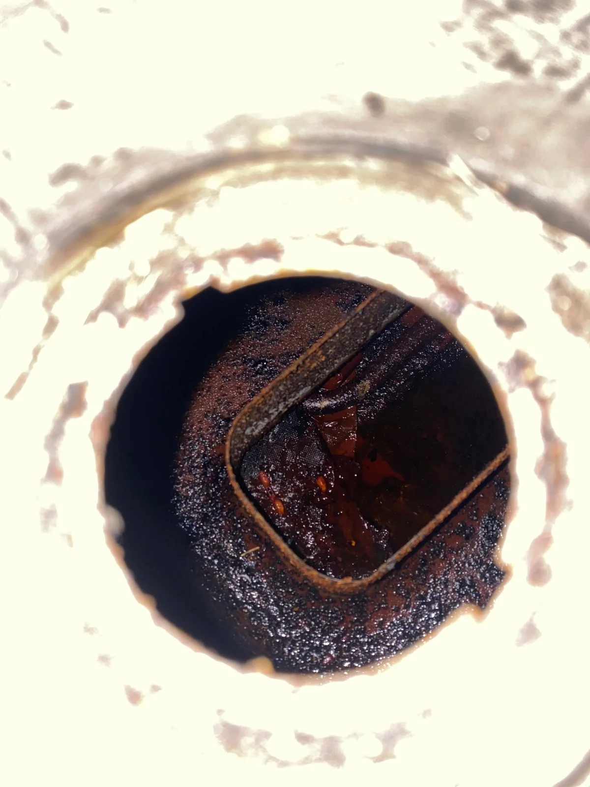

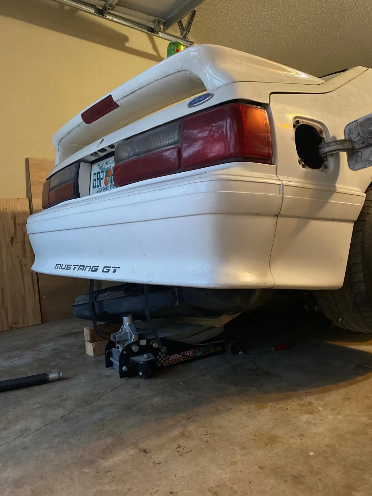

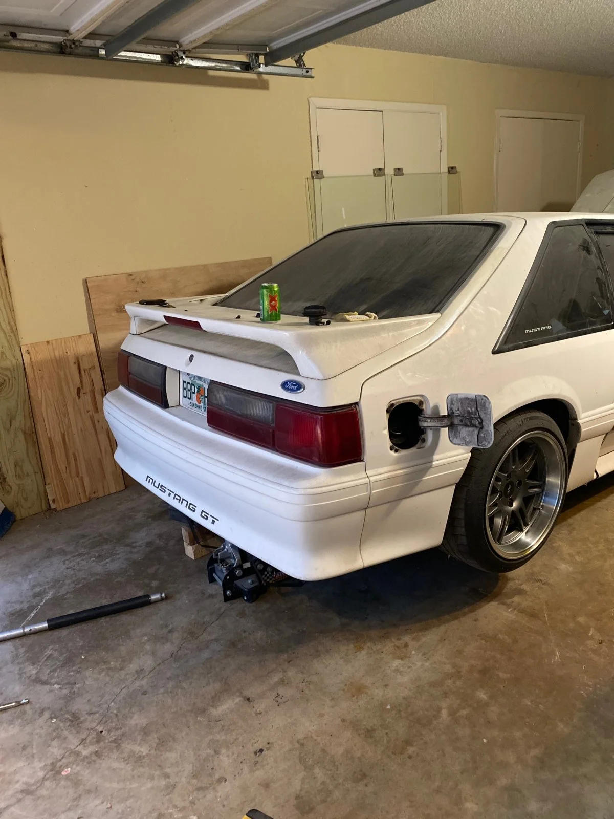

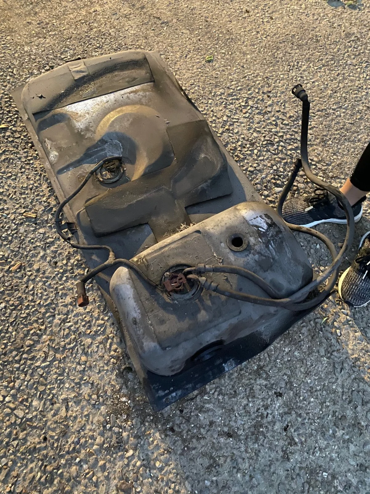

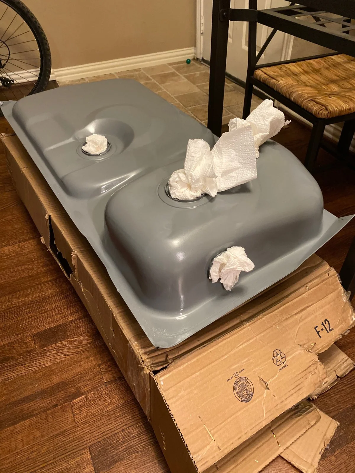

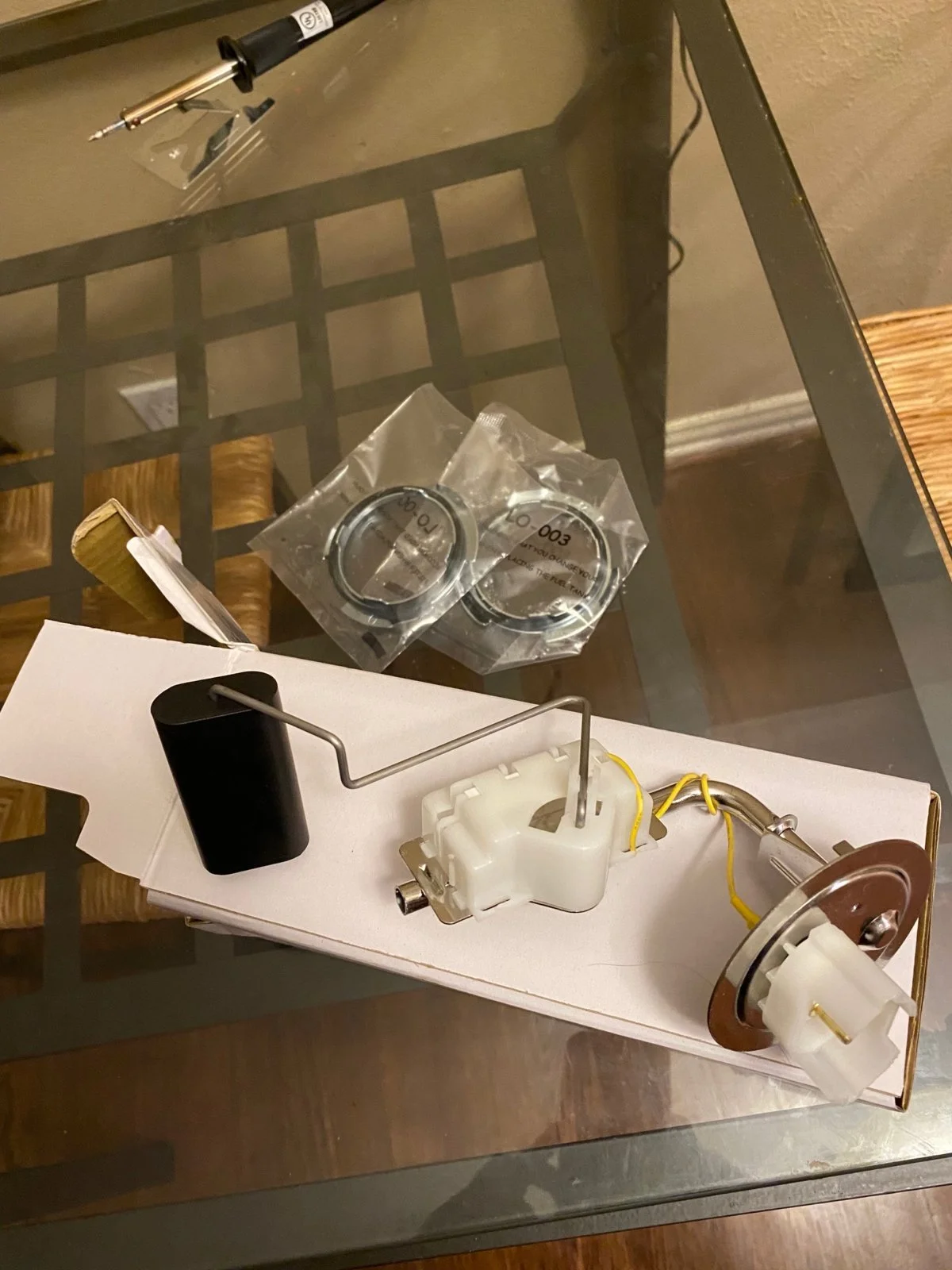

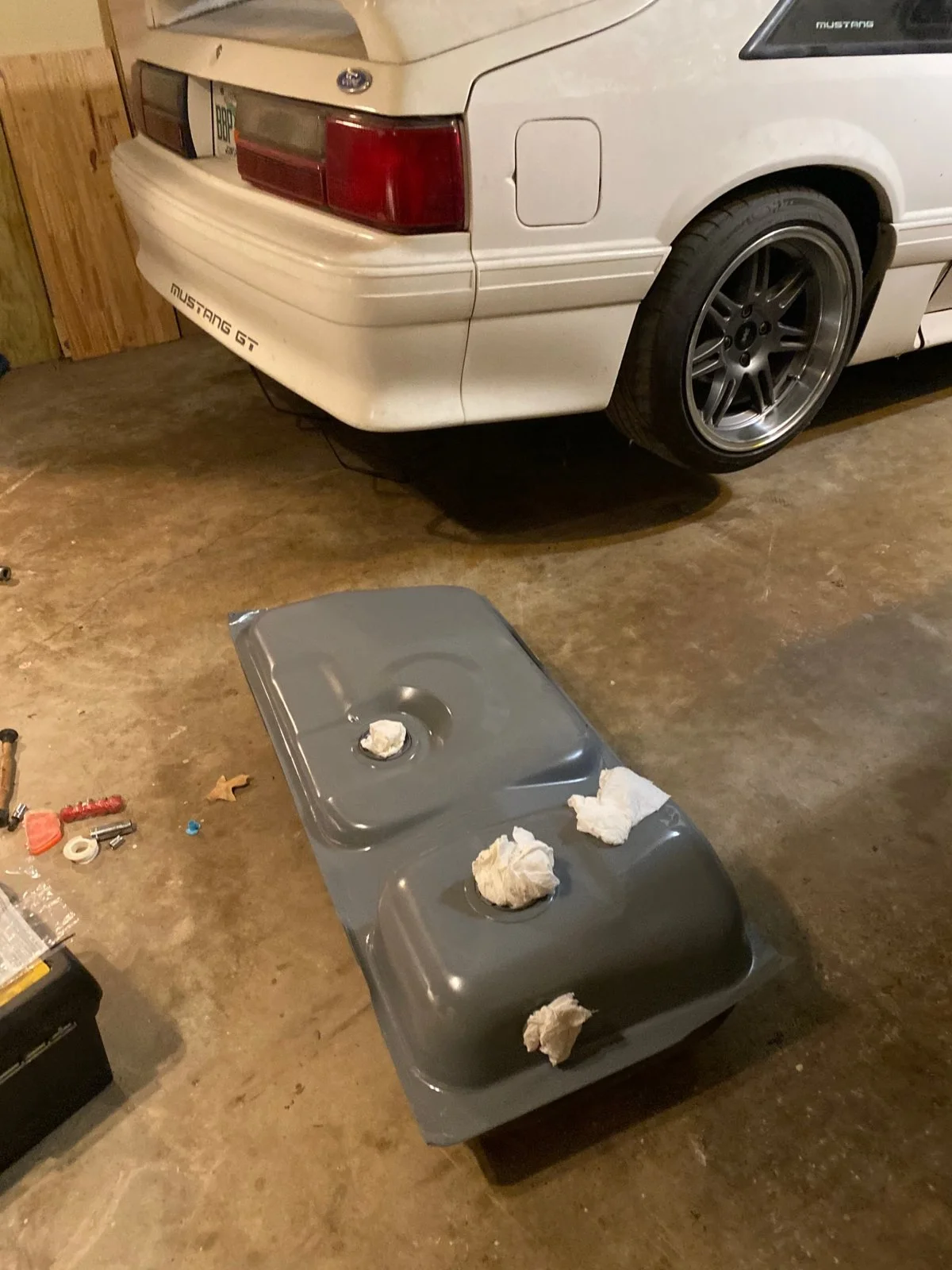

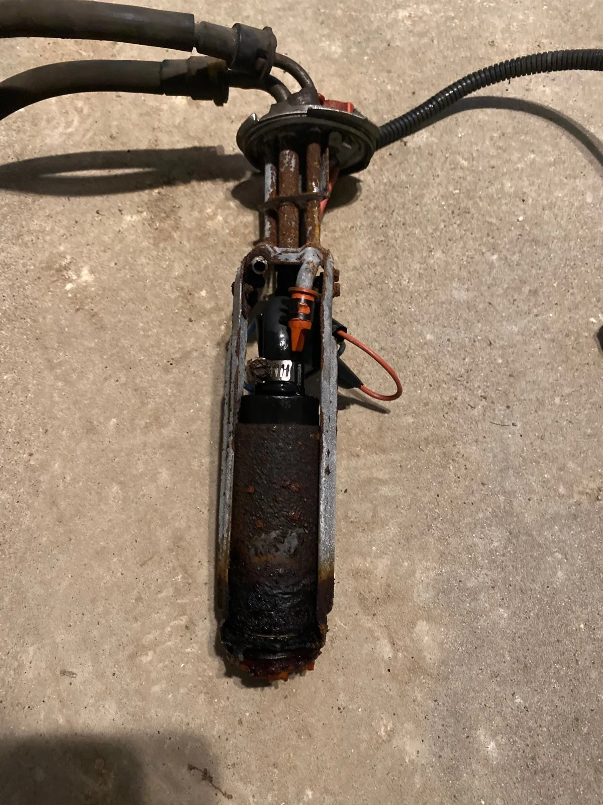

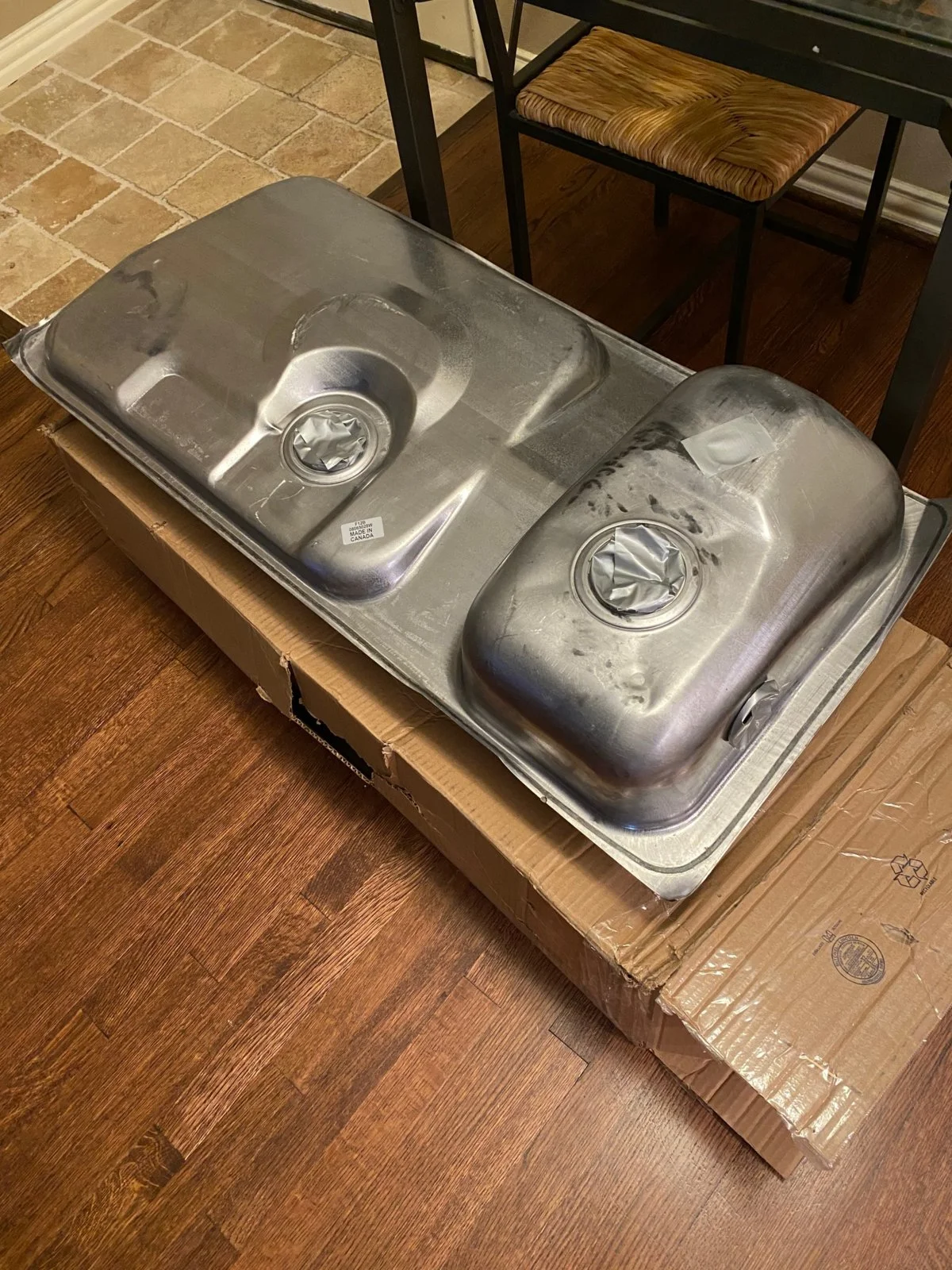

There has been gas sitting in it for about 4 years, which I now know to be exactly 2.5 gallons. I decided I needed to get the gas out and easiest way would be to drop the tank and inspect everything. I decided since a new gas tank is so cheap I might as well replace it. The fuel pump was not too old in the car so I decided I would reuse the fuel pump and sending unit. I had done some reading and saw a lot of people saying replacing the gas tank isn't necessary but it's cheap and I had the time so I said lets do it. Boy was I in for a surprise when I dropped it. You can see in the pics below the inside was rusted to s**t! The fuel strainer had almost completely disintegrated and the gas came out black. I was planning on reusing the fuel pump and sending unit but they are also completely rusted so I just ordered all new assembly, sending unit, and Walbro 255lph.

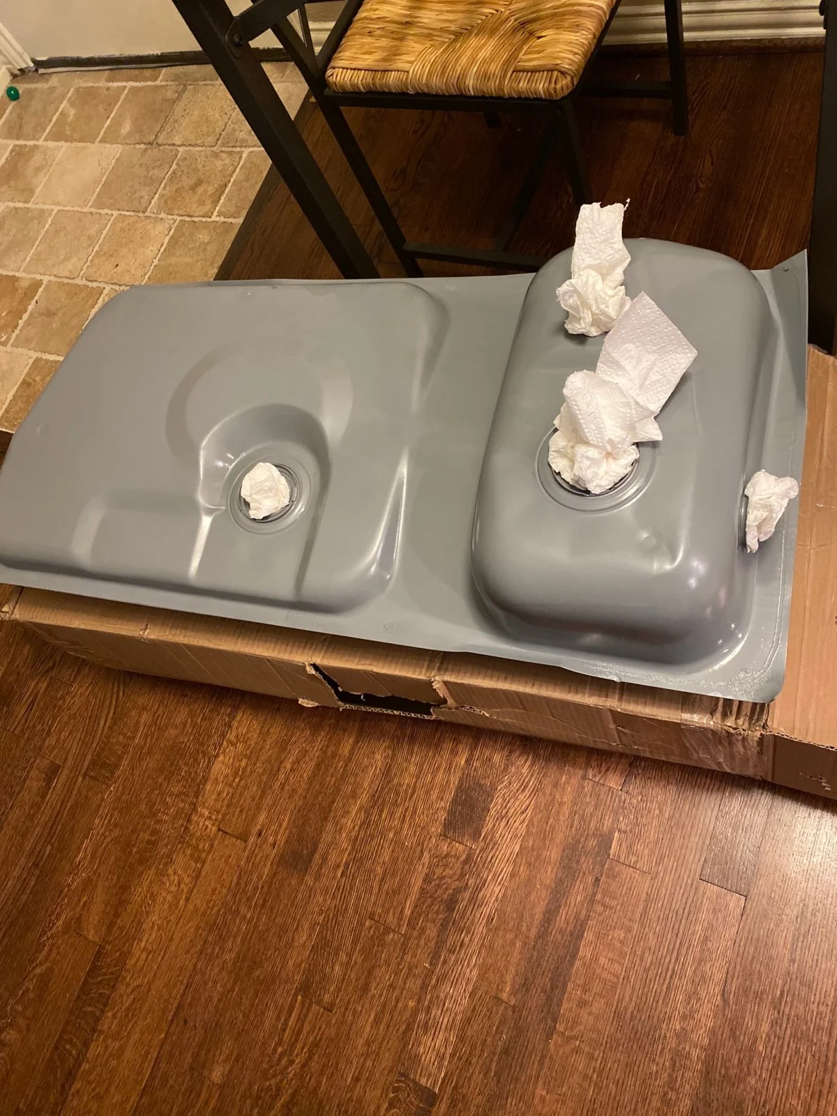

Anyways sorry for the long catch up post, enjoy the pics below of what I did this weekend. I am going to slowly continue to make more progress, next week I should have pics of the new pump assembly and the tank going back up and if all is well a startup video!

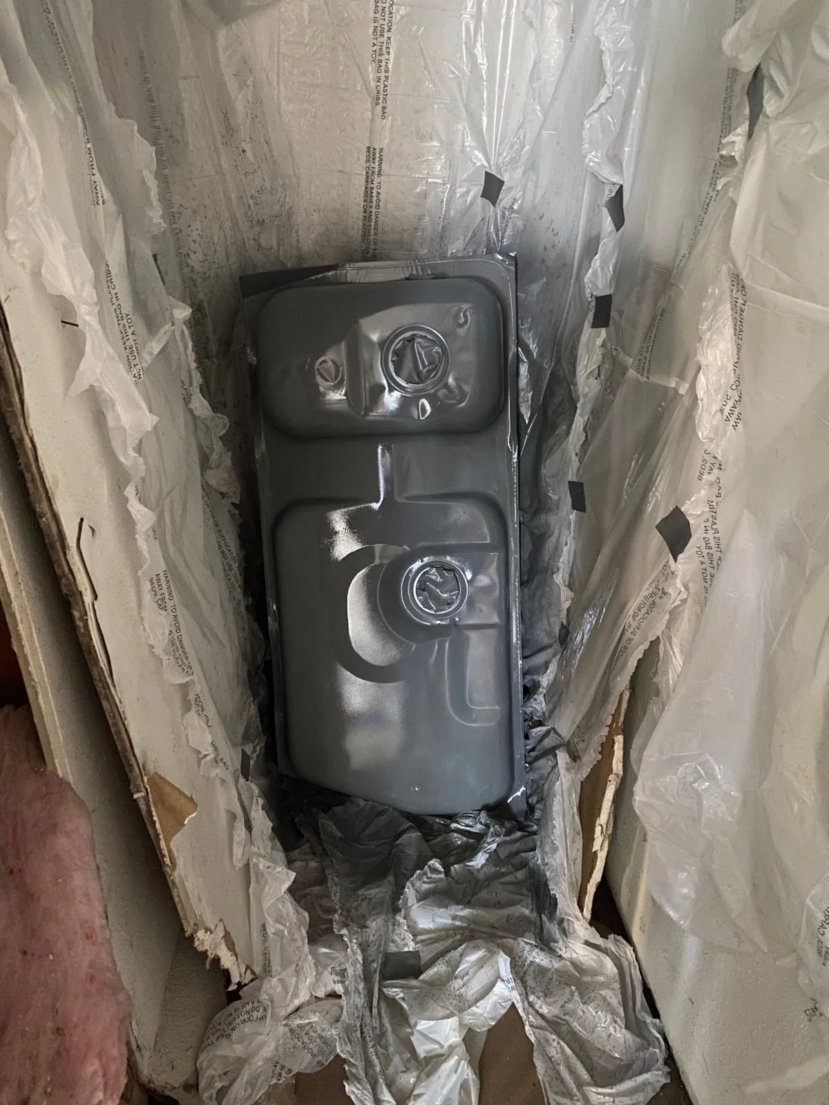

Storage closet turned into paint booth
More!
If you zoom in here you can see the mesh from the fuel strainer almost looks like its fused to the bottom of the tank.
Started to suspect someone poured something in my tank to make it corrode like this. Or maybe just crappy seals and mother nature?

Welcome back. I’m with you on replacing the tank. I did the tank, fuel pump, sending unit, filler grommet, etc on my car a few years ago. That build up is probably just condensation from years of sitting.
Hilarious using the closet as a paint booth, rather than wheeling the car out and using the garage, lol. Looks like it worked fine though! Good luck with the refresh, keep us posted.
haha well I was doing all the prep at my condo, the car is at my mom's so I had to bring everything there ready to go.

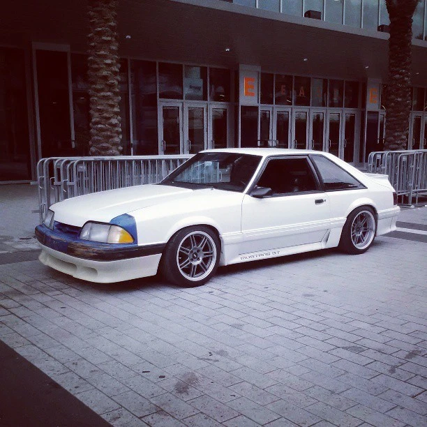

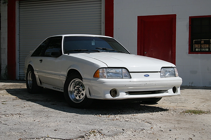

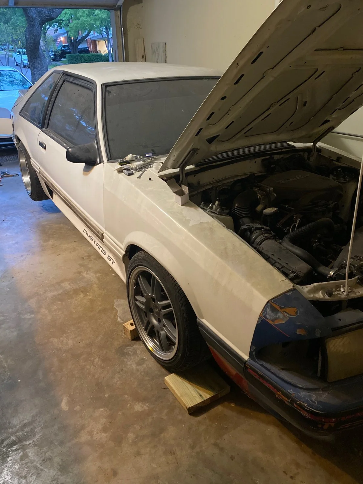

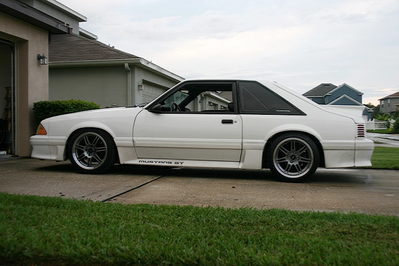

Here's some old pics in case someone doesn't recognize the current state of my car.

It's always nice to see somebody getting an old fox back on the road. I like the choice of wheels on the white! It looks good! Are you going back to the GT front or are you keeping the Lx/Saleen styling?
Thanks! I haven't decided yet, I still got the LX bumper but I sold the Saleen front piece years back when I needed the money. I have been heavily considering repurchasing the Saleen front end and doing some kind of cheap paint job to make it match. At least spray can primer white would be better. The GT bumper is long gone so I'd probably have to get it painted anyways if I went that route. I also have a new set of headlights but not ready to install them yet.

The issue with the tank was probably the ethanol in the gas. I use only ethanol free gas in my old cars. That stuff will start corroding metal pretty quick. There was a test a guy did a few years ago on YT. He used mason jars and piecs of steel. In 30 days the steel in the 10% ethanol jar was rusting like crazy. The straight gas jar looked new.
Ethanol vapor turns into an acid that eats metal.

Interesting video, I did a little research and unfortunately I don't have access to ethanol free gas anywhere near me. My plan will be to just not let it sit for so long, at least start it up and drive it around the block once a month.

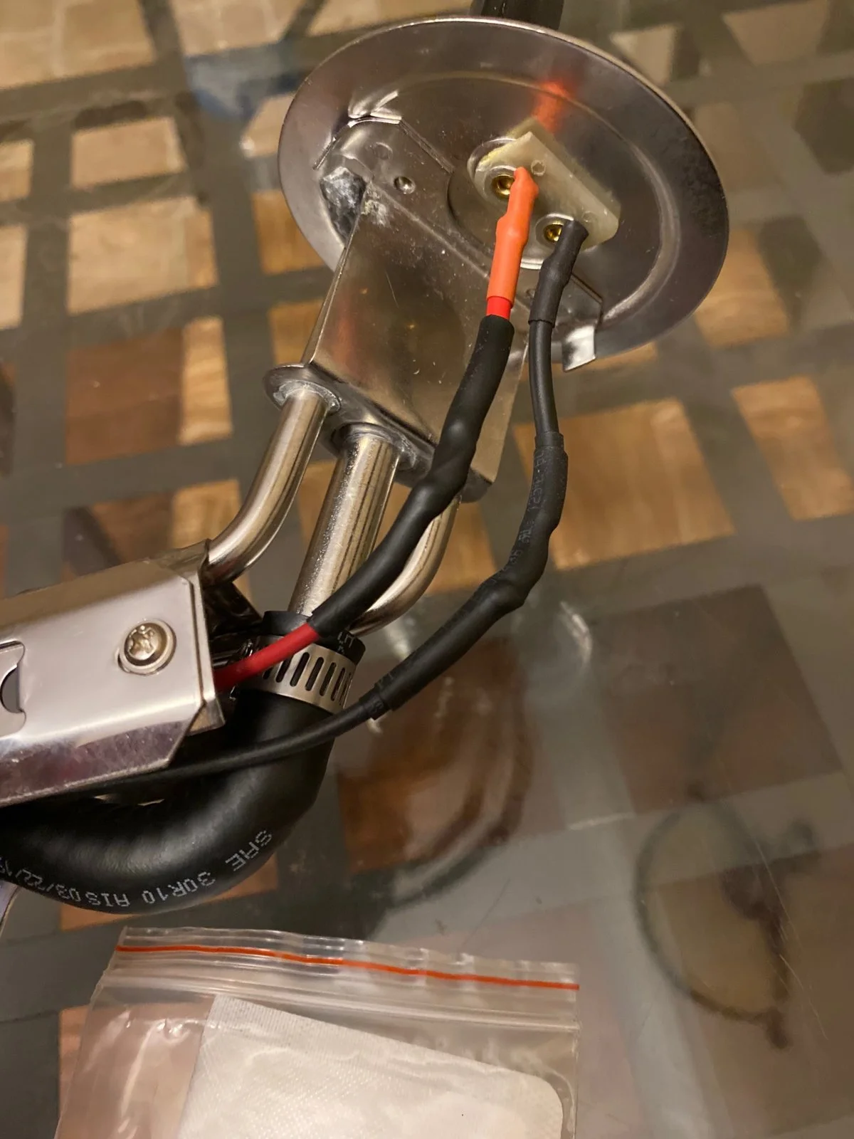

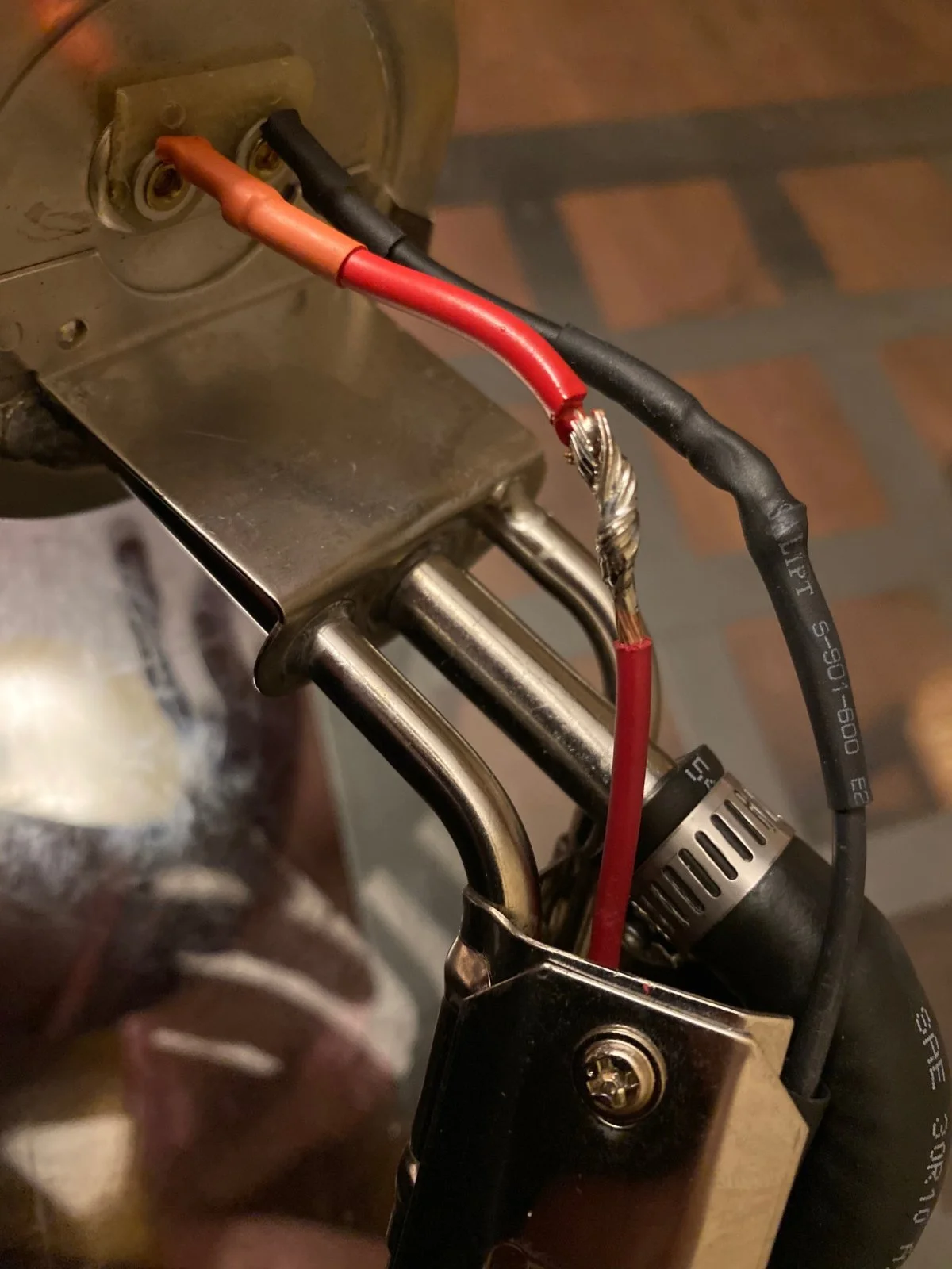

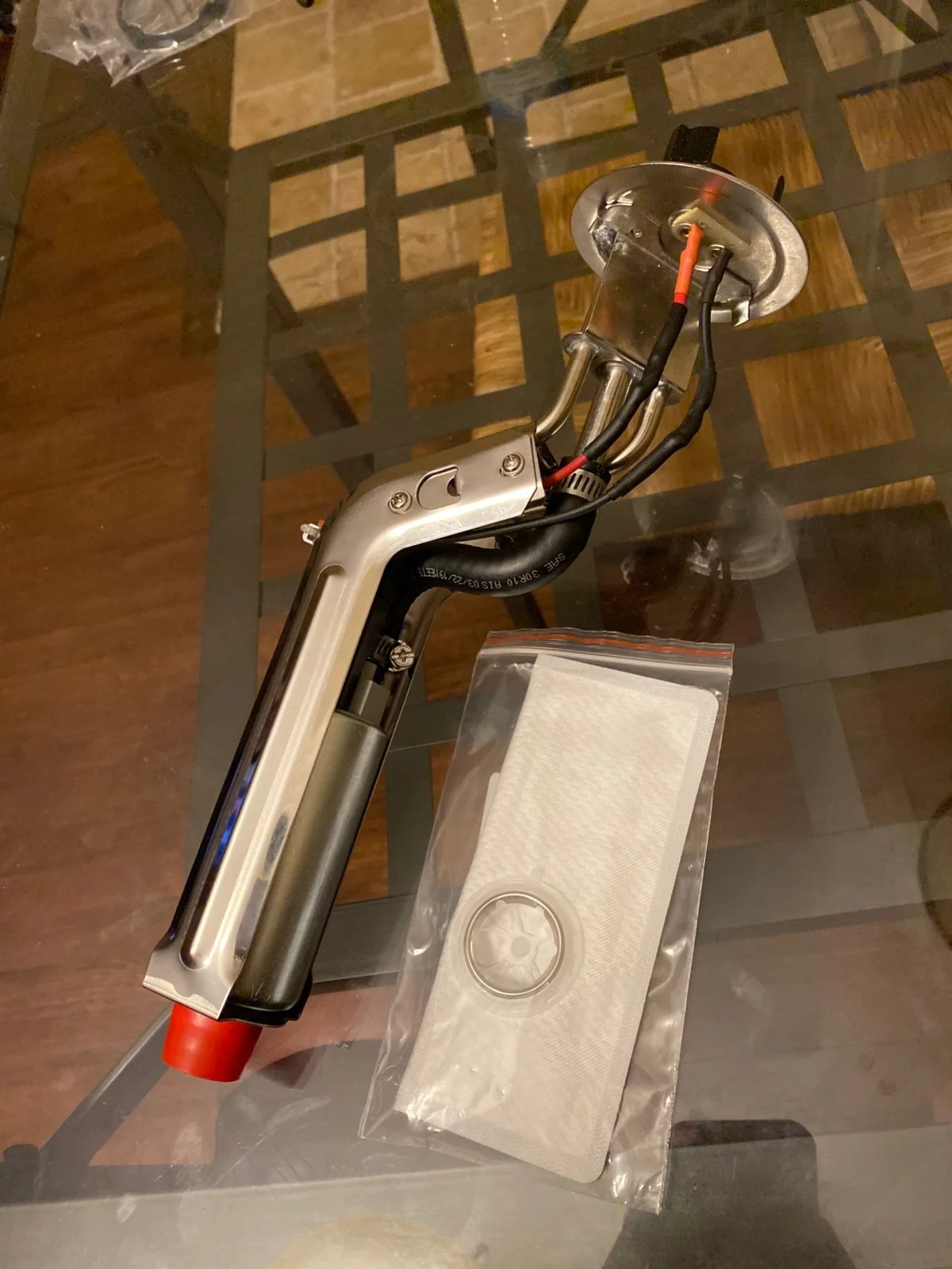

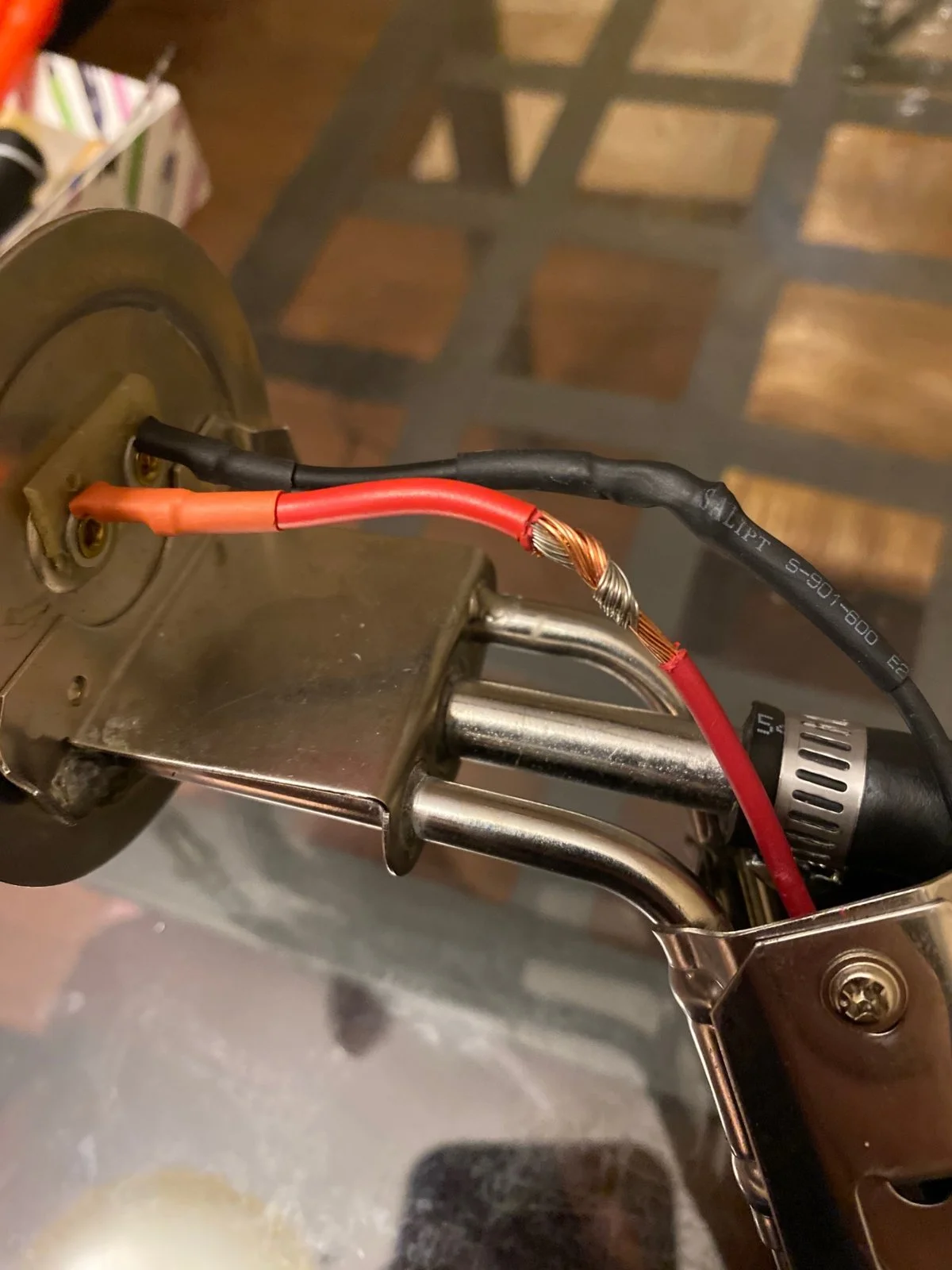

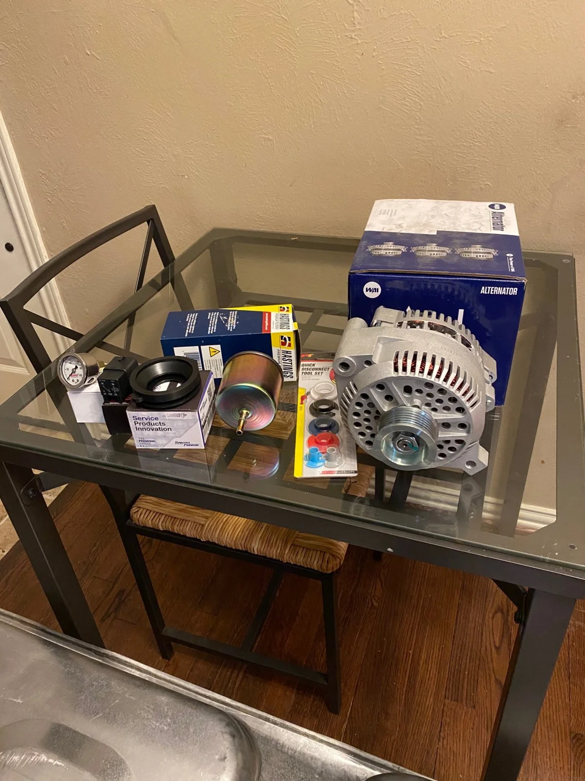

So my parts were coming in from New York, and via the USPS none the less, so my package was delayed for like 4 days and wasn't able to finish the car this past weekend. I finally got my parts in and got everything ready to go, hopefully this weekend I will start it up. Walbro 255lph & a $45 Rock Auto fuel pump assembly.
