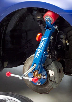

There is an issue, however. When I made my first right turn with the new setup, I did so a bit energetically. I was doing 17-20mph, and just made an absolute 90 degree turn to a greater or lesser extent. There was a horrid rubbing/squealing noise from the left rear when I did so. I pulled into the gas station/quick mart on that corner and we both got out and took a look at that side. I noticed that the tire was right around 2" from the wheel cutout on the bodywork. I opened the rear left door and sat down there (I am ~300lbs) with my feet on the door runners, and my mom leaned on the trunk a bit, and the tire was all but touching the bottom part of the "L" made by the bending of the edge of the body panel at a 90 degree angle for the added strength that gives. It was definitely rubbing bad. I was immediately shocked that Tire Rack would sell this size wheel/tire combination, since it obviously does not work in the rear.
As I sat there thinking this, my mom checked the other side, and it had >50% more clearence. We could not get that tire anywhere near as close to the lip on this side. Had for apples to apples comparison, but it is possible that this side might not rub, ever. It would be a very close thing, either way however.
Well, now we have a new warranty issue to bring to Hyundai. There is at least a ride-height descrepency in the rear, and possiblely even a suspension geometry descrepency. We will see what the dealer says about it in a day or two.
One other possibility, which I am going to ask Tire Rack about, is that I was sent wheels with different offsets for the front and the back (this was not mentioned any where, though), and I switched them. The rubbing could be the result of something like this. The ride hieght is still an issue, but if this is the case, it still would not have rubbed if the whole wheel was in about 1/4 to 3/8 of an inch, or so.
I will make some inquiries, and my mom will work with the dealership to get the issue causing the ride-height mismatch corrected (what ever is causing it), and we will see...
The dealer will more than likely not be very helpful in this situation. They will probably try to blame you tires/wheels. The wheels weren't on there when they sold it and the stock wheels had no problem so its not up to them to make your aftermarket wheels fit.
Or you could call Tire Rack and order on of these.
Problem solved for $299. Or if you want to do it "ghetto style", get a wooden baseball bat and roll the fender lips that way. It works well if you use a heat gun to ensure the paint doesn't crack. Here is a pic:
It worked well enough for that guys E46.
