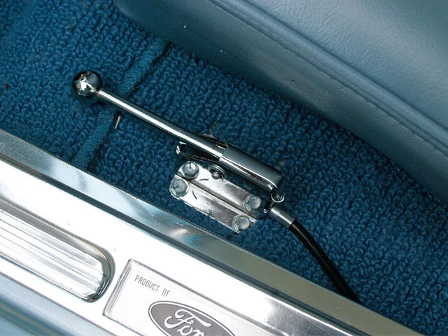

I want this setup but I don't even know where to start.
I researched this guy from Mustang monthly (Dominic Greco)
but I can't find out how this e brake system is rigged.
Anyone know how I can get a kit like this and get it in my mustang?

A lot of people use a fox body ebrake assembly to do this. I was going to use a Porche 914 setup so that it stays engaged but doesn't stay up

the cpr pull
is the earlier style under the dash thing, just a new handle for it. I plan to whatever e-brake handle I can, Fox or otherwise, that I can get to stick out of a slot in a classic console and look good doing it. I'll probably cut a slot in the classic console and put a flexible rubber rim around the slot I cut to dress it up a bit.
