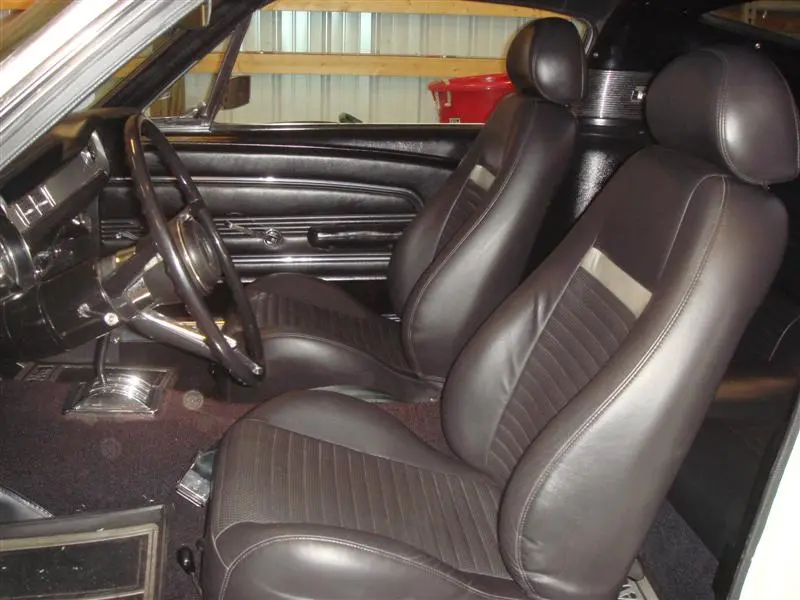

all depends on which way you want to do it. I'm 6'1, so I had to remove the seat riser from the floor to get the seat to fit the way I wanted. With it on top of the riser, my head would hit the roof with each bump.
You can go to http://www.dodgestang.com/March2003.htm to see how DodgeStang did his seats. It is simple and a good method for anyone that doesn't want to get their hands too dirty with adding late model seats.
You can also check this thread out http://forums.stangnet.com/showthread.php?t=634678 and see how PJx5x got his 04 Cobra seats in. It is the method I used and I am happy with the way it came out.
Here is a pic of my 67 coupe with 03 Mach 1 seats installed via the second method.

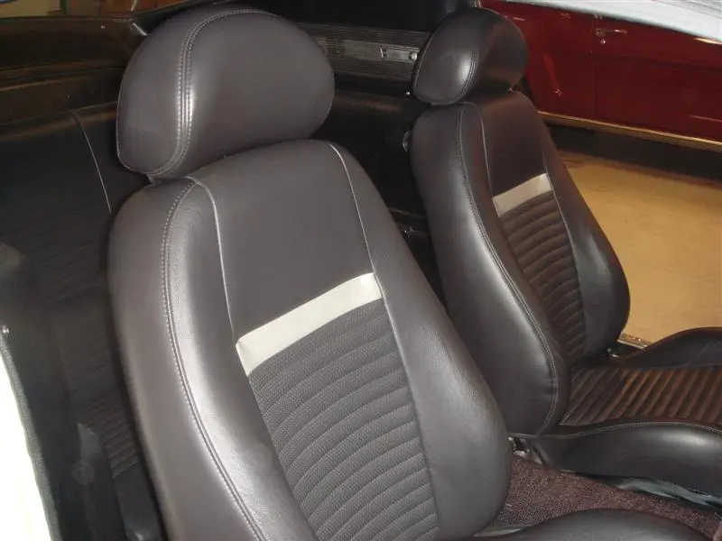

Sorry....I haven't taken any recent interior shots of the bullitts and the mach 1s aren't installed yet. This is the best I have at this time

I took all the lessons I learned from installing the bullitt seats into the 65 a few years ago and these went in like butter. Only took a couple hours to get it all changed around and both sides are adjustable. The little trick of cheating the brackets ALL the way to the front of the seat really works. I was afraid I was going to be too tight to the stock wheel...but I fit in with room to spare and with the seat all the way back...I am actually too far from the pedals!
I think the silver stripe in the seat is a nice compliment to my aluminum dash touches too.
Dodgestang, are these the Mach 1 seats your were referring to in your previous post?

Yes they are the mach 1 seats I just bought. I picked them up last night and installed them this morning

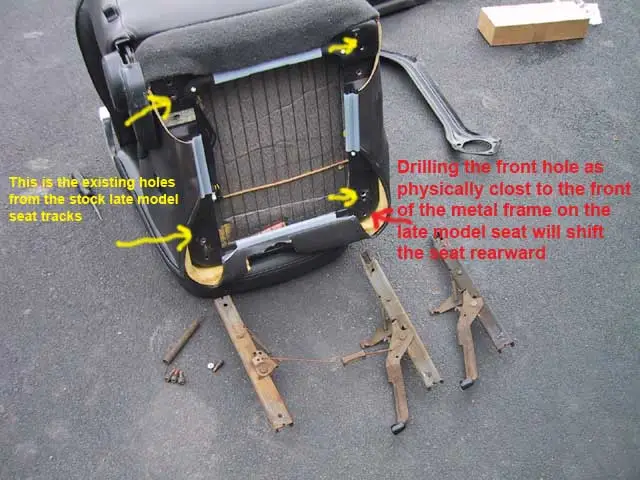

Dodgestang, I'm confused when you say "cheat the brackets all the way to the front of the seats." Could you explain further or do a quick drawing? Or am I overthinking this?

Much of the advice about installing classic seat tracks on new seats goes something like this:
Unbolt the new seat's tracks
Reuse the front bolt holes on the bottom of the seat, hold up the classic seat track, mark the rear holes on for bottom of the new seat, drill the rear holes, and bolt the track on.
If you hold the classic seats track to the bottom metal frame of the new seat and shift them forward on the metal frame as far to to front as you can (not reusing an existing holes) this will move the mounting point of the bracket about an inch and half more forward. Then mark and drill new front and rear holes. The result is the new seat will sit an inch and half or so back further.
Sorry for the typo...but I already saved the processing image here and didn't save the raw...so it will forever have a typo in it:
