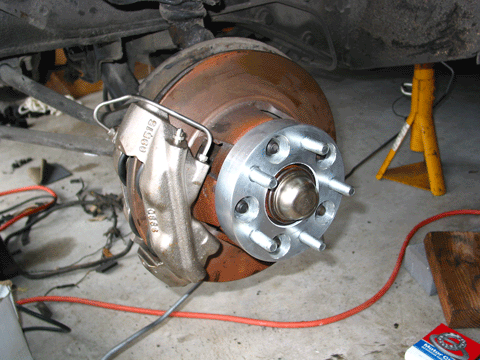

I'll third that, spacers (over 0.375 inch at least) BAD. Adapters = safe. There are track cars that can pull nearly a full G laterally with adapters, no issue.

You may want to consider the appearance also.
I don't think the adaptor version has a safety problem. And I don't think that a SMALL spacer has a safety problem either.
But you may want to look at Edberts pic and visualize the wheel/tire on it. The caliper and rotor being set back so far may look a little funny to you.
No offense meant to you, Edbert.
None taken, and you are right to some degree. You really need to consider the aestetics of modern Mustang wheels on a classic. The backset of the disc is the least displeasing of them all IMHO.
