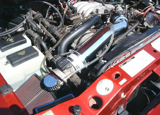

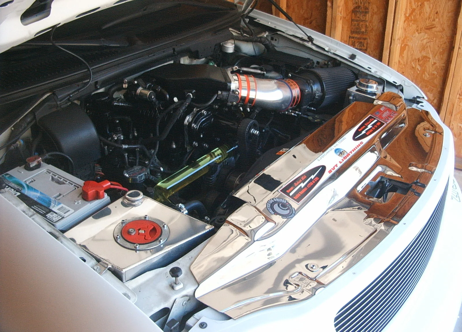

I have cais on all my vehicles. First thing I do when I buy a vehicle. The WeaponR intake on my Mustang came with a velocity stack that is mounted in the grill, and a hose that routes from there to the filter, or somewhere in close proximity to the filter. The cai on my 3.0 Ranger, I have two tubes routed to very close proximity to the filter. The cai on my Lightning is an old style JLP set up which has a scoop that mounts in the grill or below the fascia, and a hose that routes to and connects to the end of the filter.
This site acts funky some times. Cannot edit the above post. Cursor won't place. The pics in the above post are first the Ranger and second the Lightning. Much better looking than the stupid crinkly black rubber hoses that connect the MAF to the TB on both vehicles. Even though the Ranger is mostly an overly busy looking engine compartment. Too damn many hoses and whatnot.
