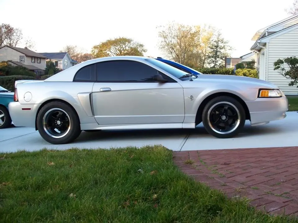

Hey guys, I figured it was time for me to start a progress thread for my 1999 GT. I know that I really need some better pictures to post, but it's about 20 degrees here in New York in February. :( You've probably all seen it by now, but I'm getting ready to do some more mods and I figured now was as good a time as any to start my thread. Feel free to make any comments and/or suggestions.
My plans are to hit a (conservative) power goal of 650/650 with this car by bringing the fuel system and supporting mods up to par, and then eventually upgrading the blower to a twin screw Kenne Bell or Whipple. The car definitely needs a street cage. I'm contemplating making the switch to E85, but I need to research how available it is here in NY. I plan on getting some Corbeau LG1's (black and grey microsuede) and having the rears recovered to match. I'd also like to do Termi bumpers, front and rear, as well as Cobra mirrors and side skirts. Wheels are up in the air right now, but all I know is those 325's I have in the back right now are WAY TOO BIG, haha.

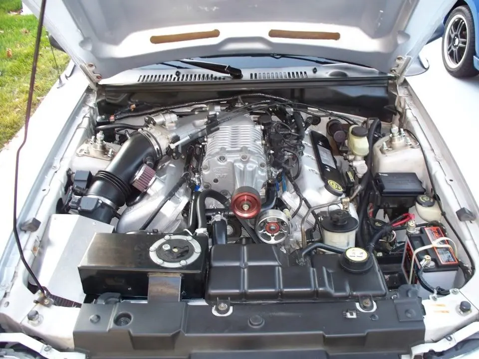

The first thing I did was remove that K&N breather the previous owner had on the passenger side valve cover (seen in the picturee above), and uncapped the nipple the stock hose hooks to (he had it taped shut with electrical tape). I sourced out the stock OEM hose that connects the valve cover to the air intake tube and reconnected it. There was some oil on the valve cover and on the little K&N filter element. Do you guys think it did any damage? I only drove the car a few times with that K&N on there.

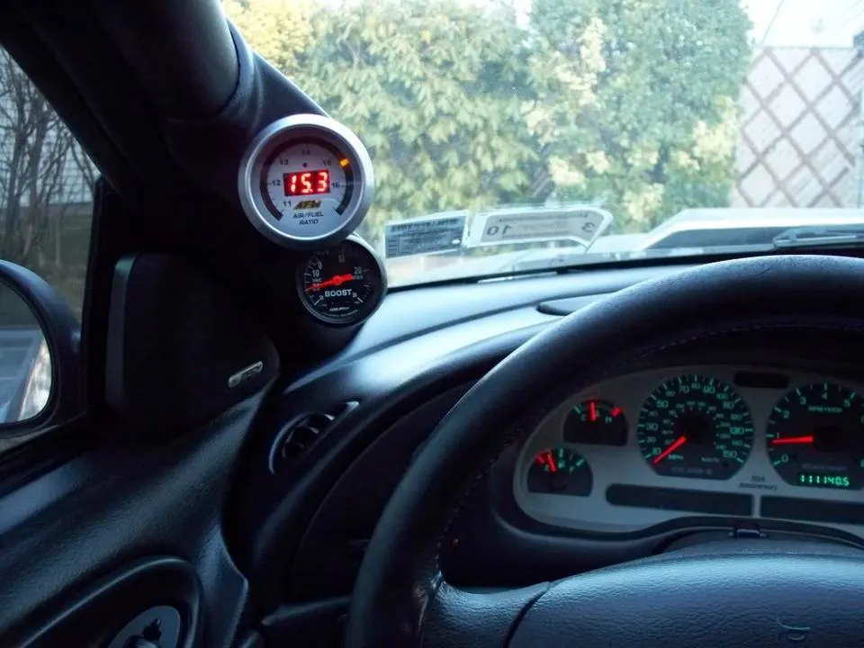

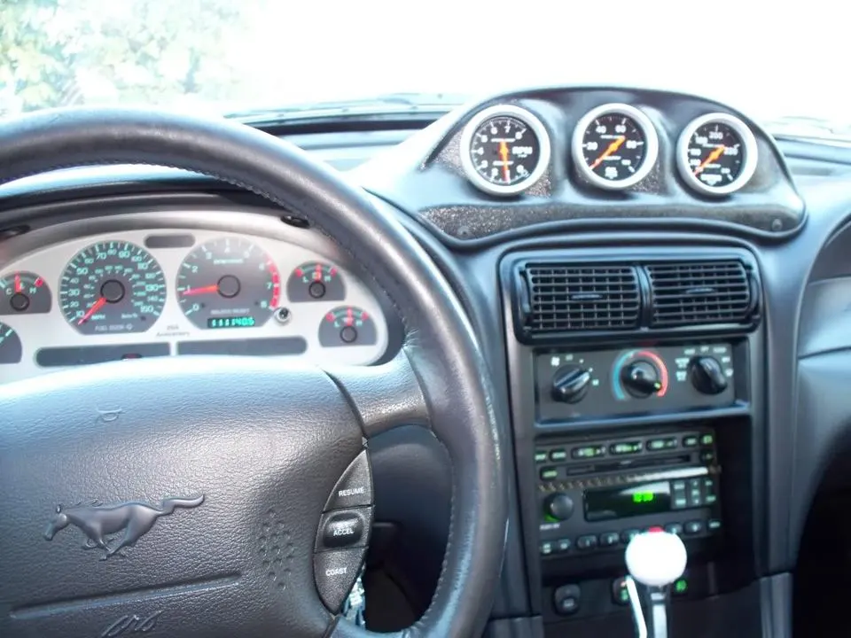

Next I installed my AEM UEGO Wideband A/F gauge on the A-Pillar, above my Autometer boost gauge.

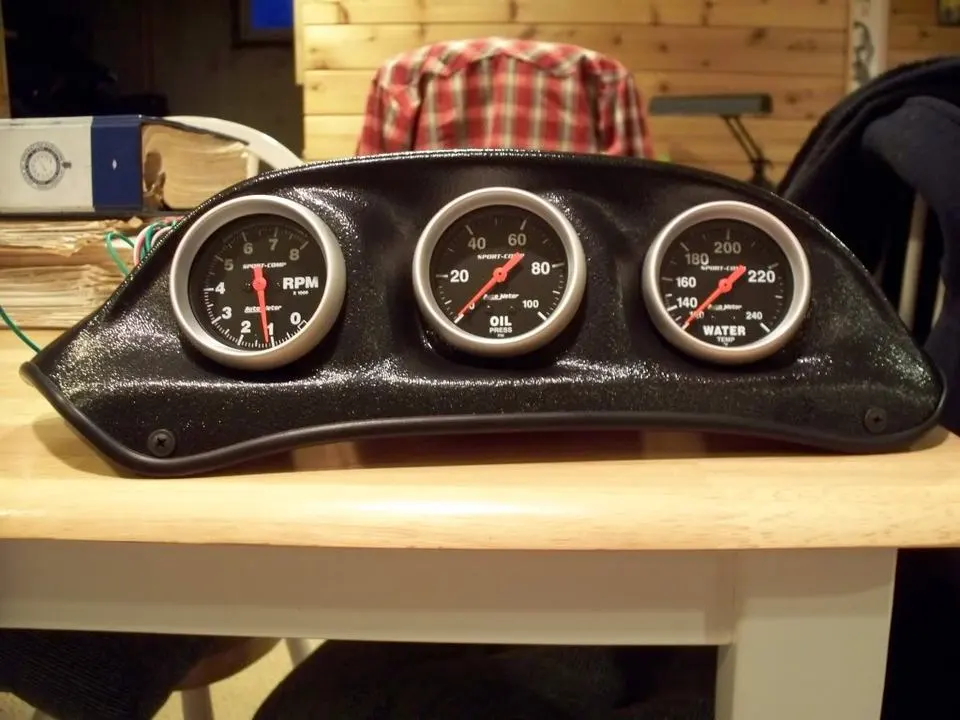

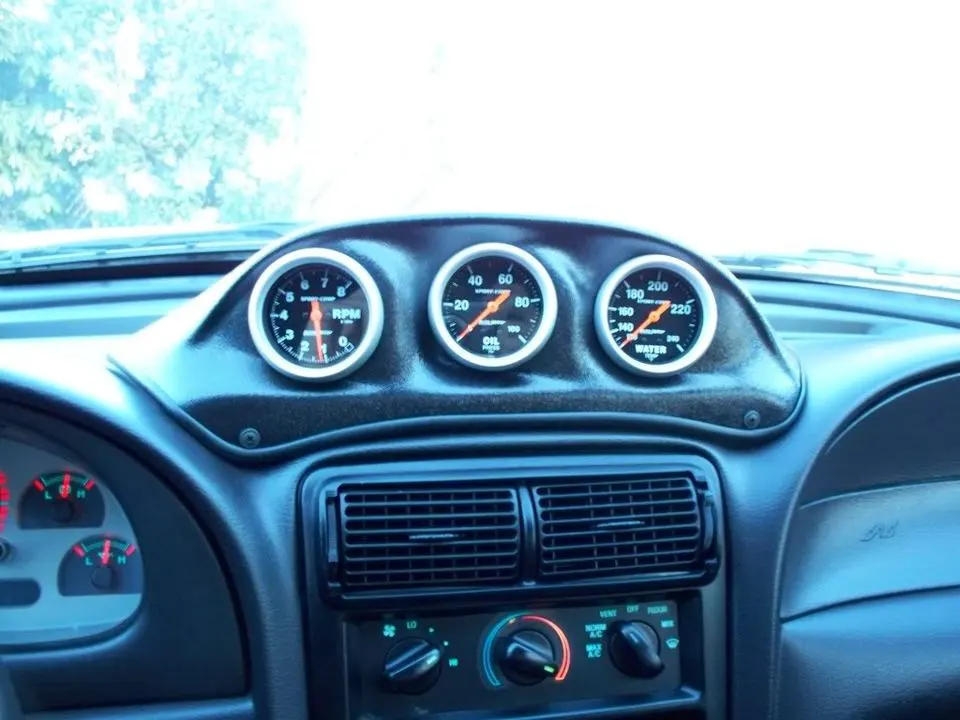

Then I set up my Autometer gauge pod with a Sport Comp tachometer, oil pressure, and water temperature gauge. The pod fits well and looks factory. New GT500s have a pod in the same location on the dash, I think it looks awesome. It is NOT installed yet, I simply set it down on the dash to see how it will look installed.
