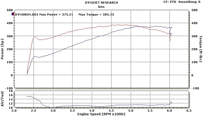

it isnt hard at all. tapping the pan IS NOT HARD!!! i worried about that and it was soooo easy!! the novi 2k instructions really suck major a*s but i got mine on in about a days time. as far as power goes mine hit 375 but the yno guy said that i could hit 400 with a little more timing. the mongoose tune is very conservative to keep it safe!
Same here, I would have been at ~375 with a bit more timing when I was running the stock 3.6" vortech blower pulley. Supposedly Tim has never lost a stock block motor with the Mongoose kit tune. With the longtubes I'm waiting to install, MPH boost pipe, 3.3"RR pulley, and 75mm throttle body/plenum as the ONLY other power mods I'm hoping for over 400rwhp/tq :flag:
