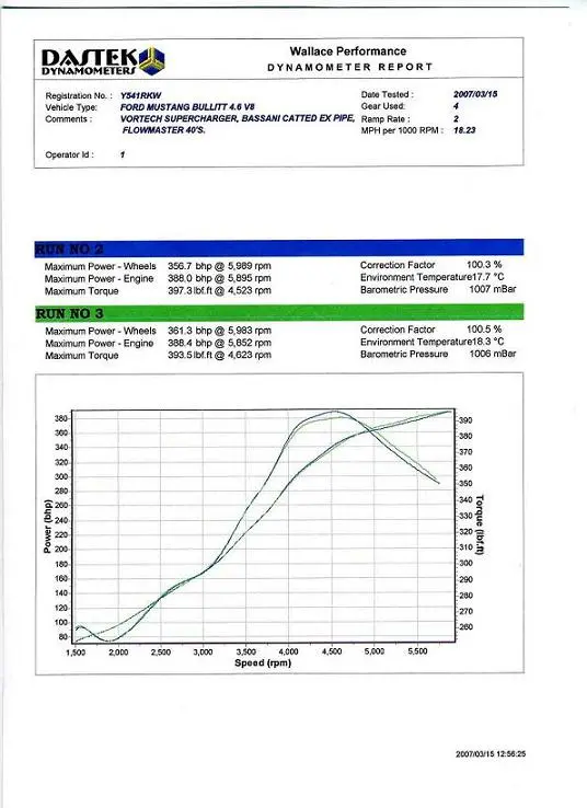

Today I finally managed to get the car on the dyno - and I am very impressed with the results! Power delivery was really smooth and the tuner was very impressed with the kit and the mapping done on the car. Peak power was 388 at the flywheel which translates to 360 at the wheels. Torque was 397 lb/ft at the fly. Boost peaked at 10 psi which was quite surprising seeing as I'm only meant to see 8 psi, a/f was quite rich (and safe) at 10.5 - 11.2 at WOT. I spoke with Tim at MPH and he said he had added a little more fuel as he was uncertain of the elevation so should be able to squeeze an extra 10 horses out! Overall really impressed, car is great to drive on the street especially with the 4.10's

Nice numbers. Another thing to keep in mind that probably should have been mentioned earlier is that the Vortech head unit requires a continuous supply of oil from an external source (fresh feed line from the oil pan). Because of this, spinning it free hand on your living room floor without continuous lubrication may have been the source of the majority of the noise you were hearing. I would imagine once the blower was fully primed with oil, brought up to operating temperature and the bearings broke in a little, it should (did) quite down substantially?
