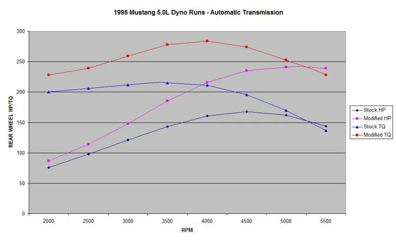

Here's my current list of performance mods with dyno results:
Stock: 168rwhp @ 4500rpm, 218rwtq @ 3400rpm (AODE)
Stock: 16.03 @ 89.4
C&L 76mm MAF/CAI kit
Summit Racing 75mm throttle body
Edelbrock Performer intake manifold (added 15rwhp/7rwtq by itself)
DIY-ported E7TE heads milled 0.010"
Stock cam
Crane 1.7 roller rockers
ASP underdrive crank pulley
Smog/EGR delete
MAC 1-5/8" long tube headers
Custom shorty 2.5" offroad H-pipe
Straight-through mufflers with stock tailpipes
Walbro 190lph fuel pump
BBK adjustable fuel pressure regulator set at 45psi
Stock 19lb injectors
Replacement 4R70W tranny with Transgo HD2 shift kit
Stock torque converter (currently stalls at ~2200rpm, stock engine stall ~2000rpm)
Ford Racing aluminium driveshaft
Ford Racing 3.73 gearset
MM rear lower and Edelbrock rear upper control arms
111lb weight reduction
Modified: 244rwhp @ 5150rpm, 284rwtq @ 3950rpm

I plotted both sets of dyno curves onto one image so you can see them side by side. Both dyno pulls were done on the same Dynojet (SAE):
Stock: 16.03 @ 89.4
Stock cam
Smog/EGR delete
Modified: 13.46 @ 104.5
Its great you provided the stock results :nice:
It is well known a stick trans GT will lay down about 185 SAE rwhp
give or take a few :)
So I guess you could say the auto trans takes about 20 in your case
I would point out you now got a different auto trans
and
I know very little about any of em
but
I would wonder if the 4R70W would be more or less efficient :scratch:
anyway
If you add 20 to your current combo
I'd tell you 264 SAE rwhp for a stick trans with the mods I see here
would be pretty good as I see it :D
Grady

Thanks Grady. From all the stock dyno results that I've seen, the T5 has a drivetrain loss of ~13% whereas the AODE/4R70W has a loss of ~23%.
I'm very happy with my combo as it is. Idle is smooth (no surging), driveability is excellent, and I'm getting very good gas mileage. I'm aware that there's still a lot more HP still under the table (~35rwhp from AFR 165's, ~10rwhp from a cam). Just deciding whether it's worth spending over $3000 for an extra 45rwhp plus a higher rpm stall torque converter so I can run deep into the 12's. So far my build-up has been fairly low cost and it's a night and day difference from stock.
