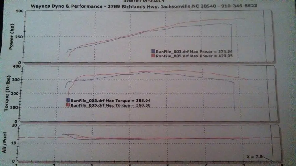

Just finished getting my car dyno'd post install of Boss manifold, Steeda CAI, and 93 tune by BBR. WOW, color me impressed
The torque curve is flat! And my car didn't lose a thing. I went from a max torque of 358.94 to 368.38 and it never dipped below the stock curve once passed 2400 rpm. And the HP 420.05 vs 374.54 with no dips, just smooth power all the way to 7500. I have my shift light set to 7000, just because I like my engine
So, the combo of Boss manifold, Steeda CAI and BBR tune gets two thumbs way up
