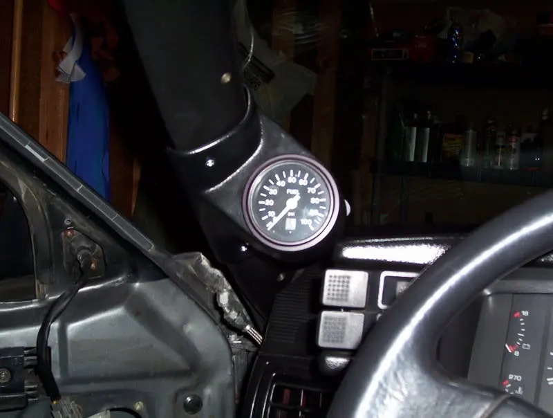

fuel press and oil. tripple pod on the way with water and oil going in the empty spaces
I like mechanical myslef easier to work with but, its all what you want to do. I had to get a fuel isolator to run my gauge. Without it I am not allowed to run at the track. It is a diaphram that fuel presses on one side and water or antifreeze on the other side. So if the gauge leaks into the cab Fuel is not getting sprayed everywhere antifreeze is. Fire hazard.
