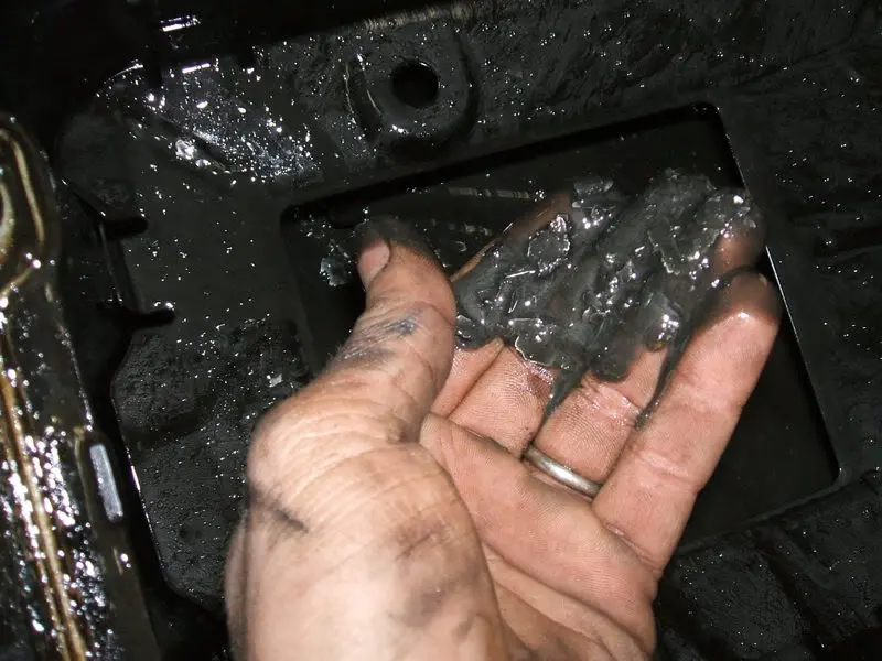

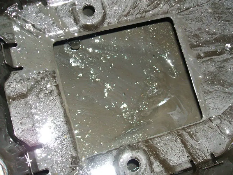

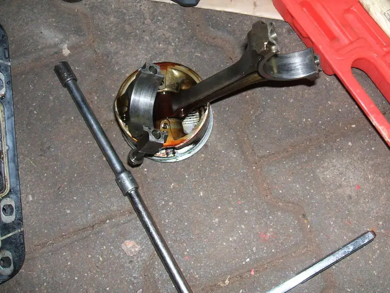

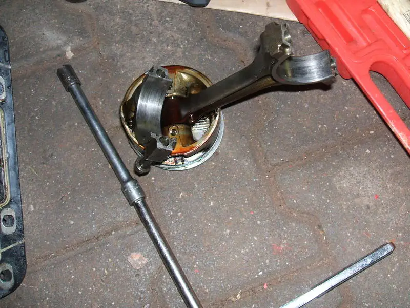

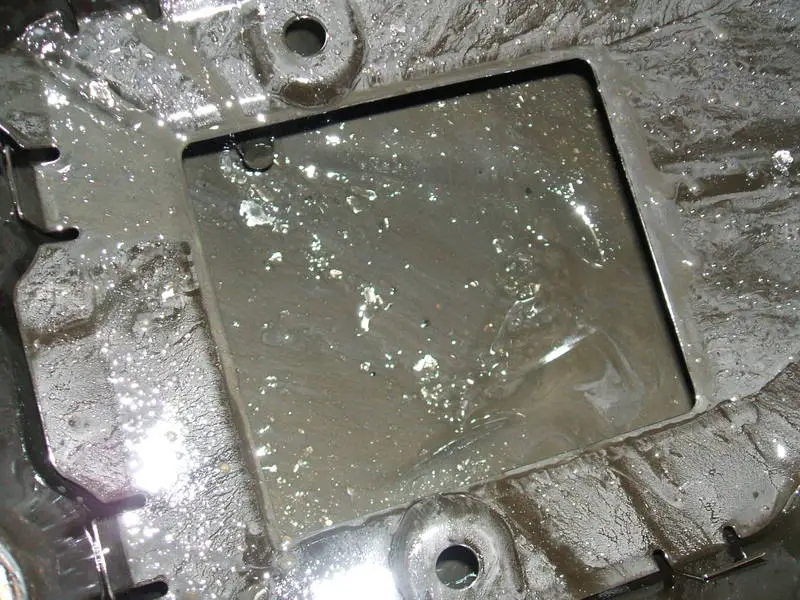

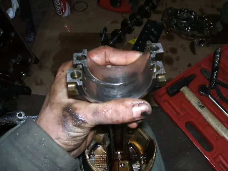

I just went thru this entire deal with a 98 GT that belongs to a friend.....here are the results.....
isn't there supposed to be a bearing in there?
I just tore into the oil filter and it looks like a spun bearing...the fram did a goo job of keeping it out of the motor though. looks like its time for a forged stroked shortblock!!
