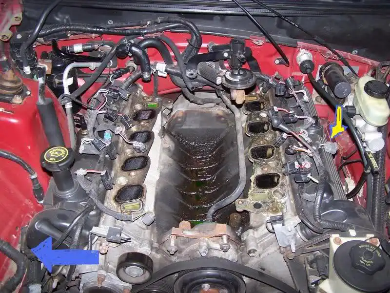

While changing my buddies intake manifold gaskets he noticed that the engine was a little crooked. It looks like the front of the engine needs to be moved closer to the passenger side. His midpipe is hitting the k-member on the drivers side close to where its connected to the manifold. The drivers side looks like its higher than the passenger side to.
The picture doesnt help much but in person you can see how its crooked.
Im thinking the motor mounts are prolly worn and need to be replaced now. Does anyone else concur?
Looks like a bad motor mount to me. My 98 looked like that.
After I pulled the old mount out, it had absolutely NO rubber left in between the two sandwiched plates.
I would try to replace both at the same time, because if one is bad, then usually the other one isn't too far behind.
