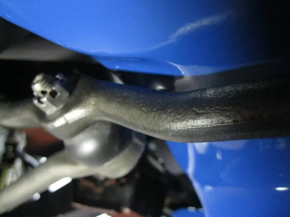

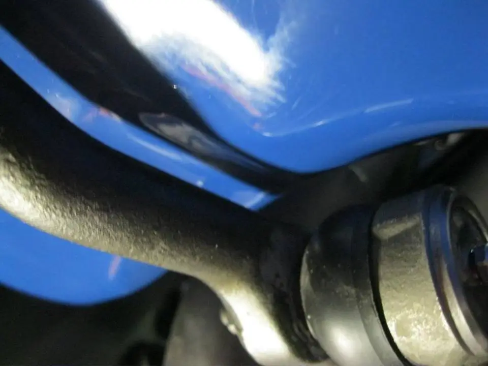

here is one area to watch out for (especially if using the drop mounts).

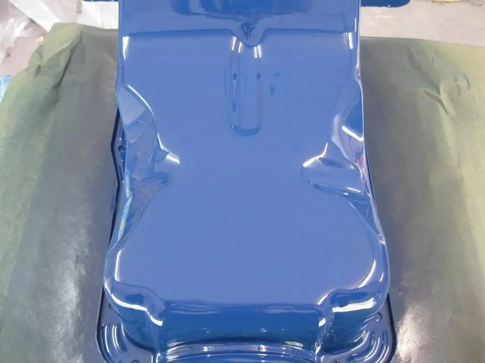

I also had to change my oil pan, I had a big 7qt pan and it hit the cross member do to lowering the engine, Im now running a moldine 5qt oil pan, wish you luck and let us know if you run into any other issues once you get the mounts installed, I'm running JBA mid-length header and have plenty of room on both sides
