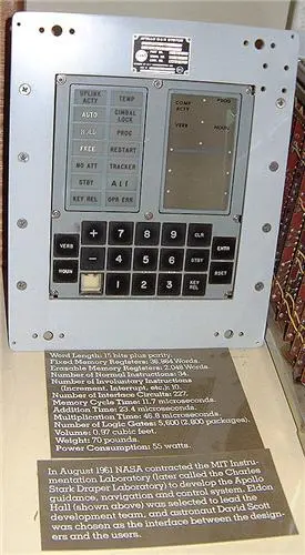

Here you go,....Apollo 11 Guidance computer......
64kb of memory, operated at .043 MHZ.
When they said these guys flew to the moon,...they actually "flew" it to the moon.
