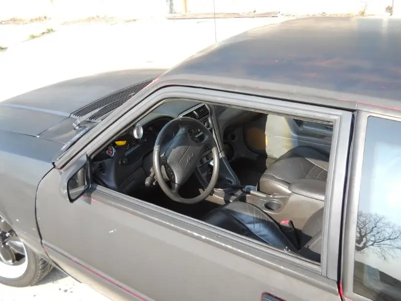

89_LX said:
Is it possible to keep the tilt wheel function with an sn95 dash/wheel setup in a fox?
Yup.
Everything from the steering wheel to the hubs is from a 2001 GT. That way there isnt anything custom that I can't get parts for anywhere.
I actually fit better in this car now with this interior then with the fox interior. I can put the wheel where I want, the seat (power) and even though I am 6'5" I have plenty of room for everything...
I cut the firewall out from the floor to right above the mastercylinder and welded in the factory booster mount and spherical bearing that the steering shaft rides in.
Plus using a 94-95 GT cluster allowed me to use a 93 GT wiring harness ( car was a butchered 4cylinder swapped carbed mess) and all the colors lined up with the connectors for the new cluster...
Alot of colors carry over, HVAC, Cruise, Radio (minus the MACH 1000 stuff) the only thing that I had to fight with was the wiper controller... they changed the resistance values in the multifunction switch sometime in 99, so using a 95 controller and the newer switch caused many undesirable effects... Had to get the 95 MFS to make it work....
