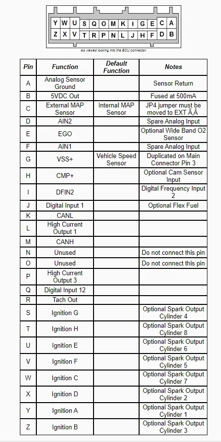

I'm looking at the Mustang specific one. If you look through the installation guide, it shows wiring pinouts
This is the additional functions plug on the top of the unit. I don't see anything here i can use as a PWM output fr fan control.
Edit: Might be able to use L or P. I think this will work

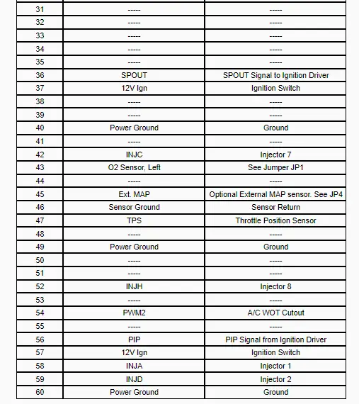

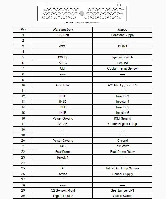

This is the standard 60-pin hookup
