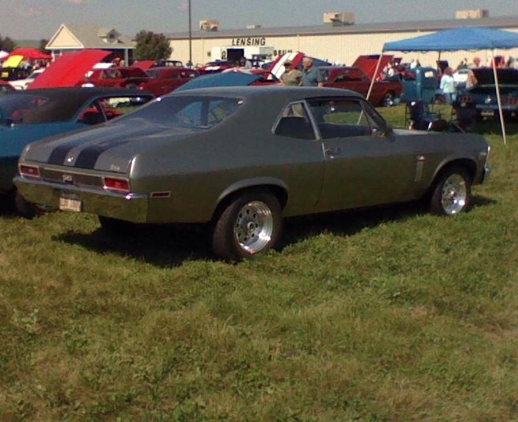

I personally ran MSD on multiple Chevys in the past. I never had a problem but the last one I had was 10+ years ago. This particular nova I had ran low 13's on radial tires with a complete MSD ign.

I had a Nova like that. 72. Wish I'd kept it.

Mine was a 70 SS. I sold mine to keep the exwife happy at the time. She wanted new furniture and a dining room set. At least I had some money left over for the divorce a year later.
