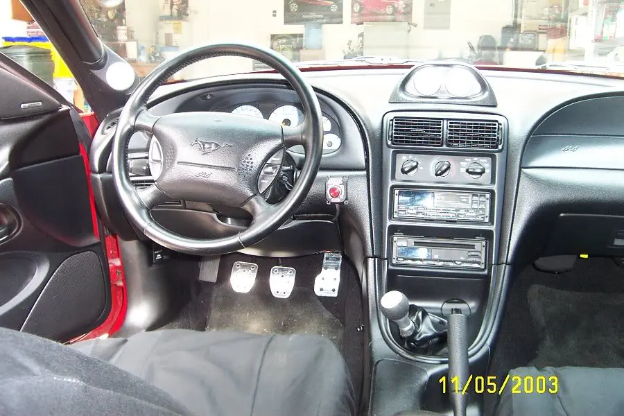

It's a good insurance policy. Like mentioned you will need the box anyway. The MSD6BTM is a combo box.
Plus you have the dial at your reach. See pic.
