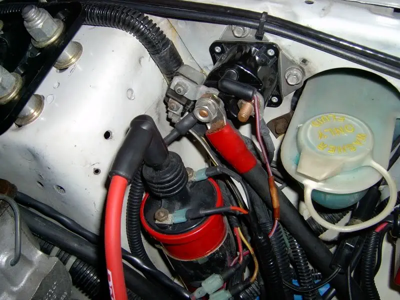

I had the same exact problem when I put a MSD TFI coil on my car. I put two of them on it and they both did it. It was NOT RFI noise, it was an actual loud buzzing from the coil itself, so a filter won't help in this case. After looking at it one day (I think it was getting dark) I could actually see the coil sparking between the body and the metal outer part, which shouldn't happen. I replaced it with a MSD tower-style coil, and it's been fine ever since.
Sorry guy's, my crane stuff gives me EFI through the speakers in the car...
Edit, I might add that I grounded the coil bracket / coil body to a strut tower with an additional piece of wire.
That is the coil i have on my 88 LX and have no noise but what did you have to do to change that over?
It's real simple. Just need the coil mounting bracket so you can bolt it in place. Then cut the factory plug off, crimp on some terminals, and hook them up
