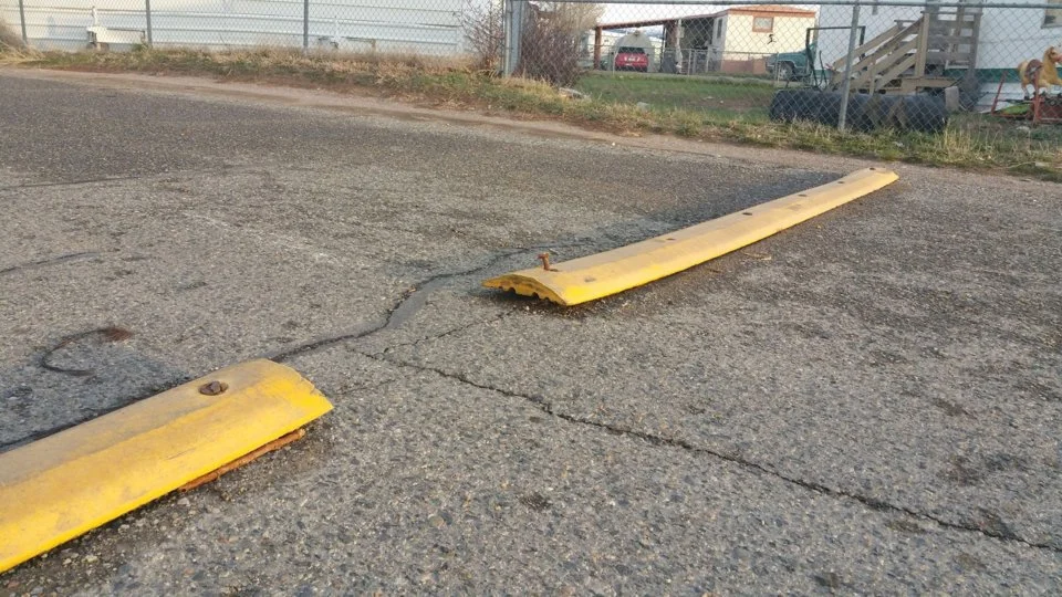

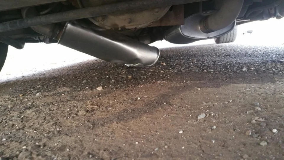

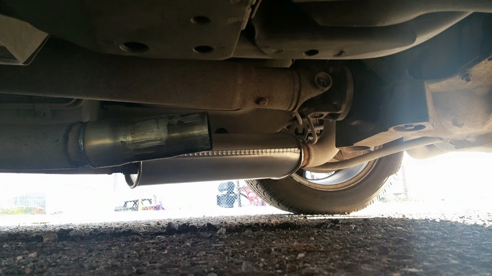

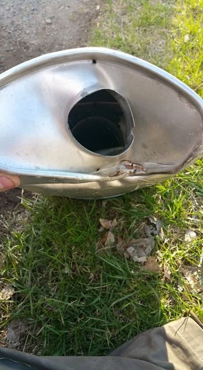

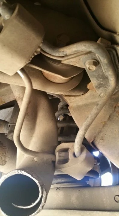

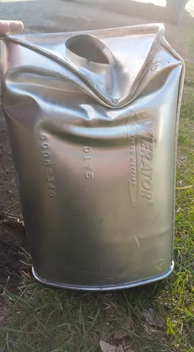

So I talked my local muffler guy, He talked with me to get an idea of what I was looking for, and he gave me some options that will fit, got them installed on Saturday....... Friday, this happened. One of the plastic speedbumps in my neighborhood has started to come up from the pavement.

Those center inlet and outlet mufflers are killing your ground clearance. You can see by the way they're mounted that there is a lot more ground clearance to be had than they're giving you. That speed bump is the least of your problems. Have him redo it with offset inlet and outlet mufflers that fit in the stock location so you can get as much ground clearance as possible.
it is an offset / center muffler, the killer in this setup is the hangers used, they make the pipe hang lower then I would like. I doubt it was ever designed to run anything but a glasspack
I think your best bet would be to either source a new catback if you have the budget for it, or piece one together using aftermarket parts, or just have the exhaust shop fabricate it if they can do it cheaper than the other two options. Either way, you're not really going to get that current setup to give you any reasonable ground clearance. The third option would probably be best if you have a skilled shop that could bend new pipes and weld new hangers to tuck everything as high as possible.
