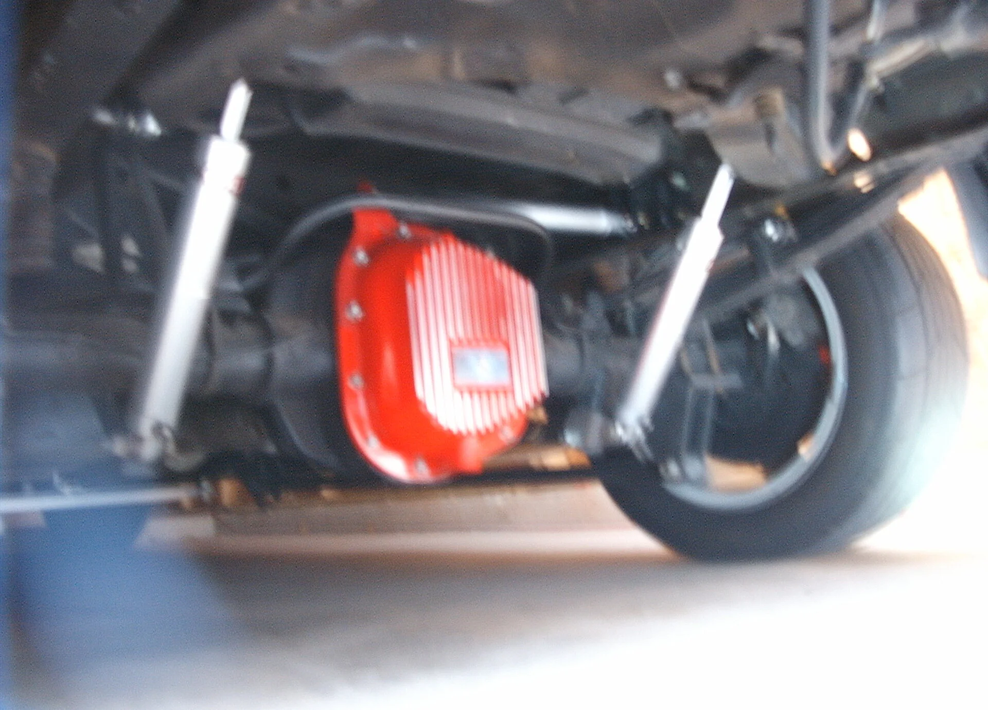

Schnazzy diff. cover? Here's my Lightning now. Mag-Hytec. Qa1 shocks, BroncoBeater panhard bar.

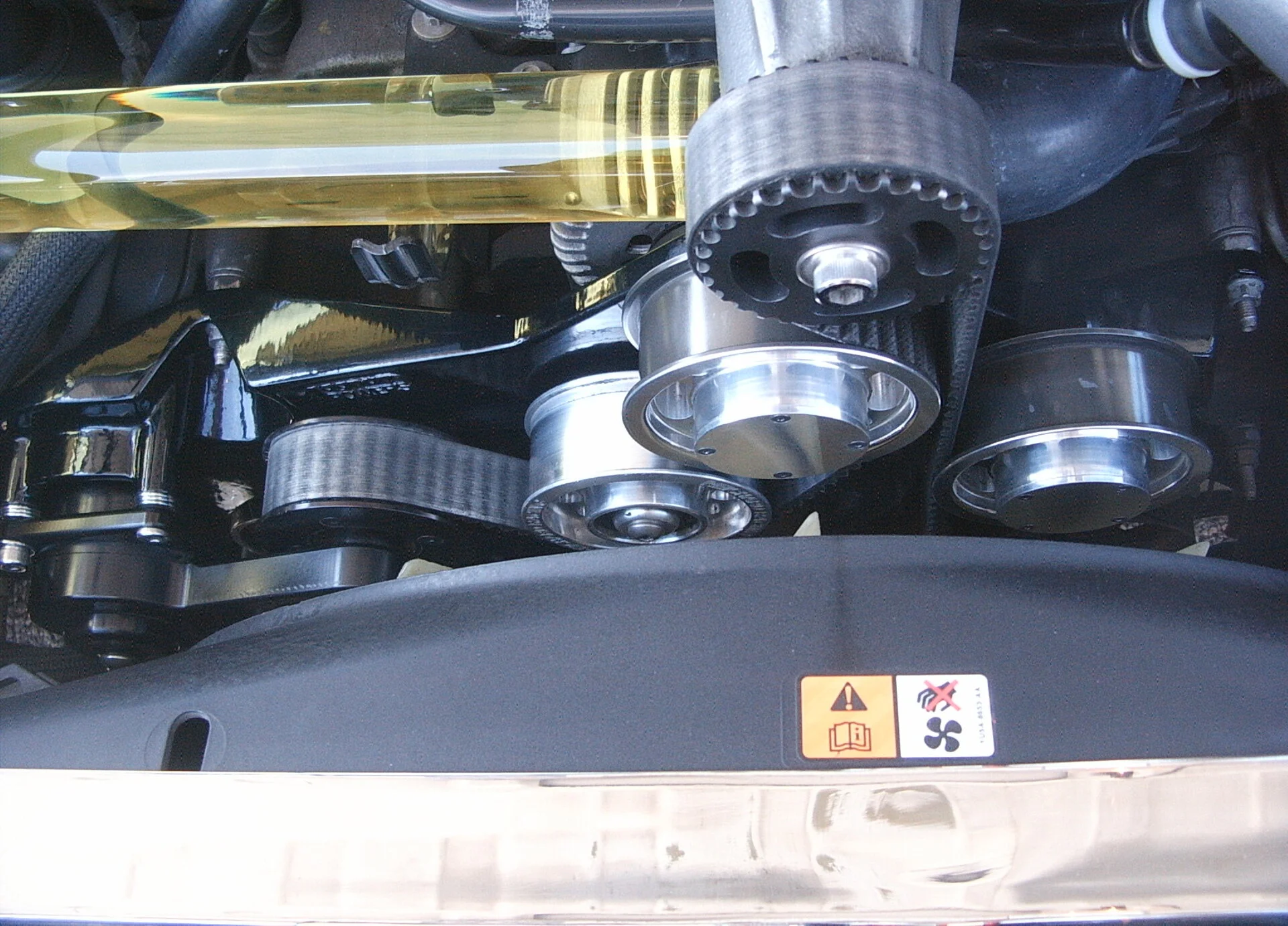

It’s KB FI upgrade & LT headers, Exhaust, Cams, Injectors, TB, CAI, lots of Suspension & Brakework makes it run stronger, safer, and launches great with slicks.
18,700miles on it, kept all stock parts, stiffening all bolt on..

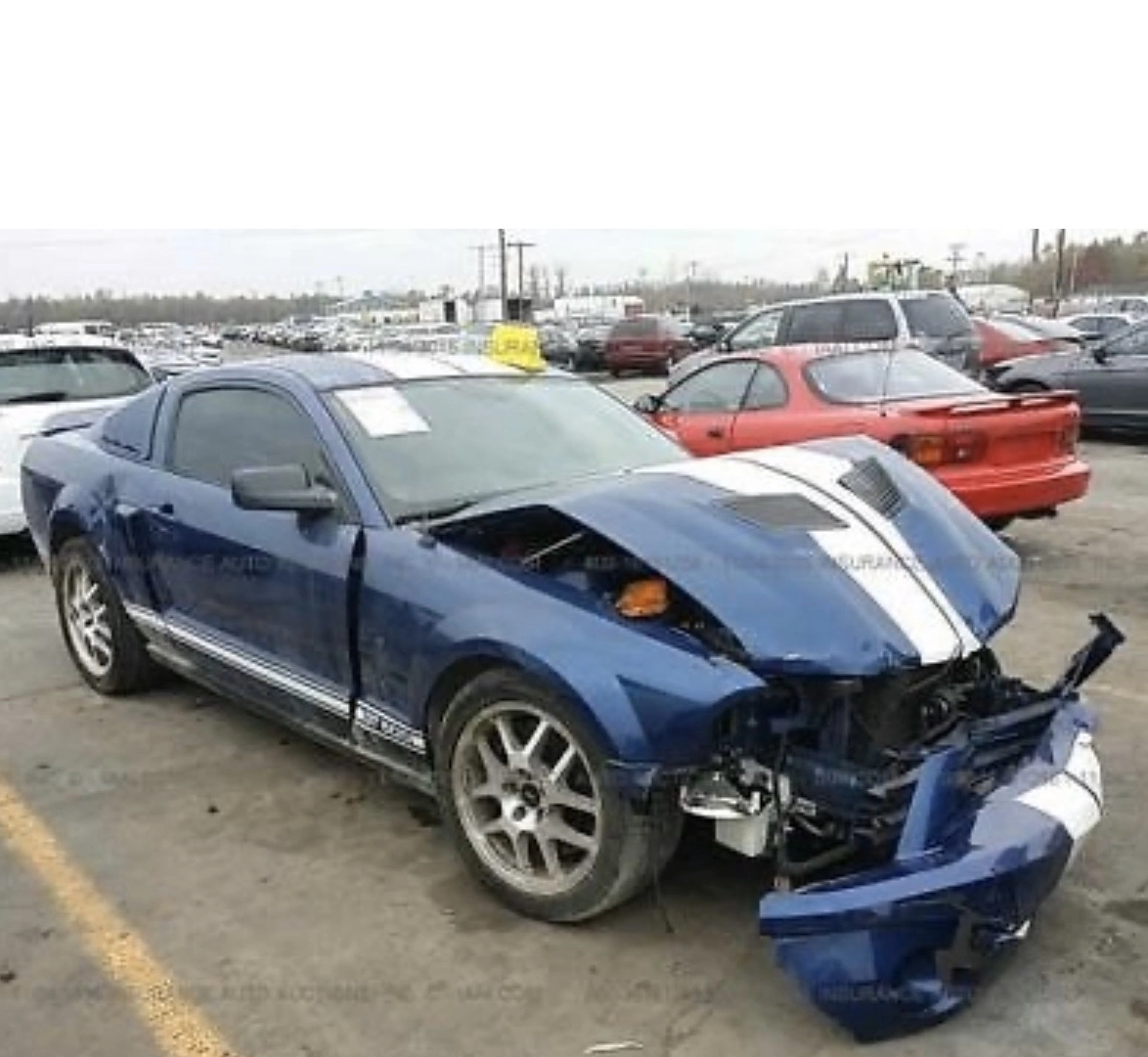

Picked up another 08’ GT500, totaled, unibody now straight, blocks at our shop.. building it when I can.
This is the build I’m basing it off of..

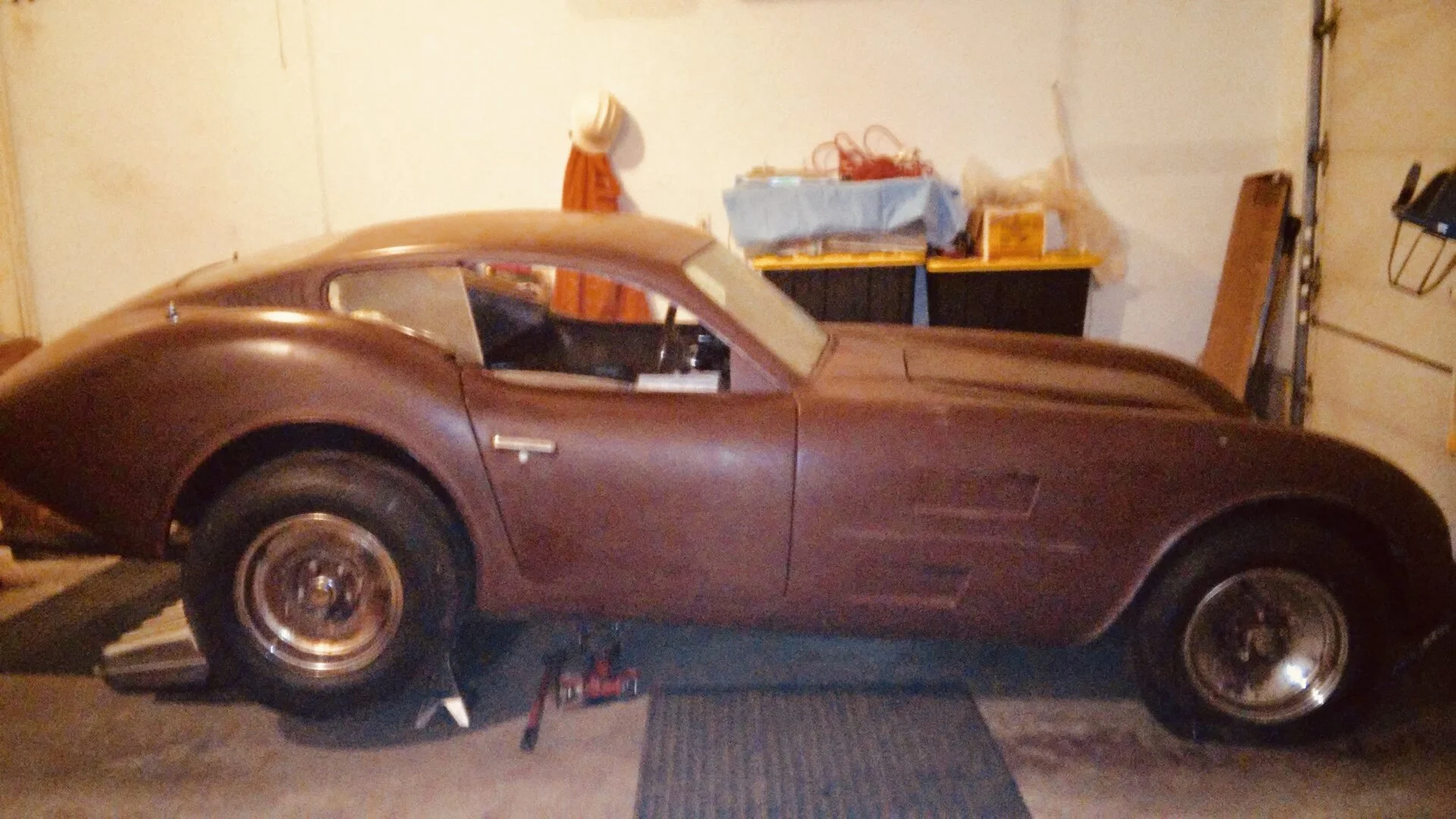

My 532CID Z-28 Has an M-22 Rockcrusher, as does my 67’ Kellison Astra X-300GT running a 4 bolt L-79 327/350. (Pic’s). Rare one there, only seen a few. Uncle started the ground up build in 68’, Retired & after all that, let it sit in an area with no ground but dirt.
So, I’m Restoring an unfinished Kitcar, lol.
Cross between a Vette’, AC Cobra, and a 280Z, see what you think.
Not to rub it in, weather here in western Mass has been >70, hazy hot & humid. But...our winters are (?)lol!
Listed some Kellison Pic’s, ever seen one?
68’ Corvette block, used for the Chevy 302, 327, 350, trying to keep most everything from the Genre’, Car didn’t even have full doors, was a shell. Almost done now, I’ll paint it late Summer, Pearl/Metal Flake Candy Apply Red.

Ass shot. You can see the long bars and the red diff. cover. Get a few comments on it when out and about.

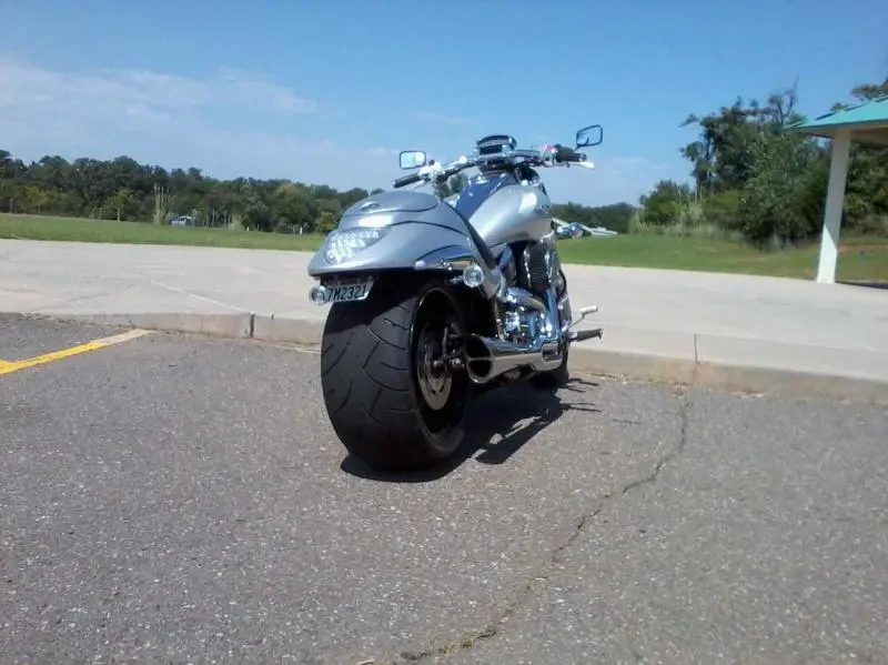

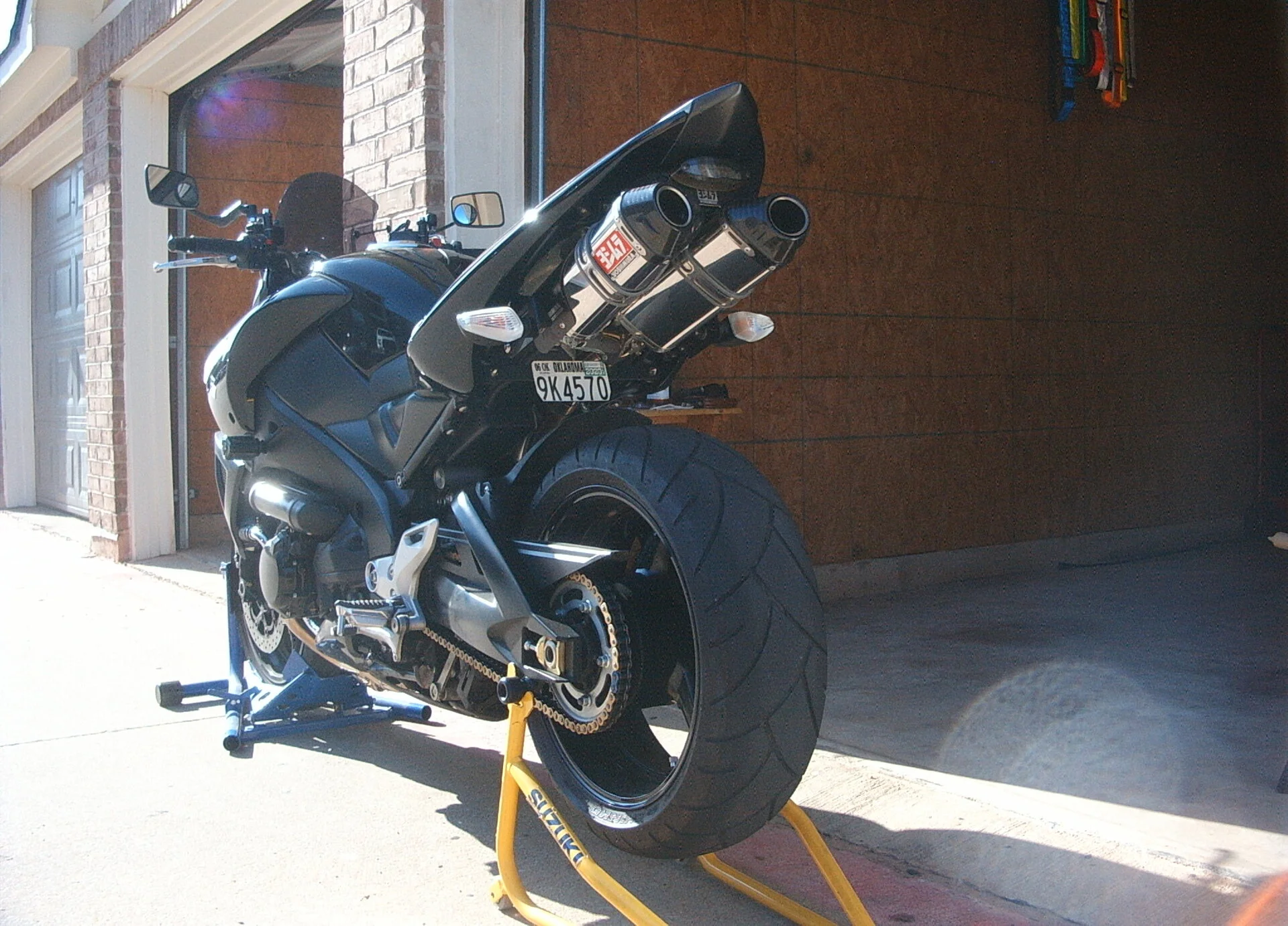

I've been more into bikes most of my life, than hot rod four wheelers. Most of them have the power to scare you senseless right out the door. I've got two at present, 2006 Suzuki M1800R and 2008 Suzuki B-King. The M1800R in it's current condition, intake, exhaust and flashed ECM makes 145 rear wheel hp. The B-King in it's current condition makes 185 rear wheel hp. It's frightening to ride. Likes to keep the front wheel in the air. Or the back if you brake too hard.

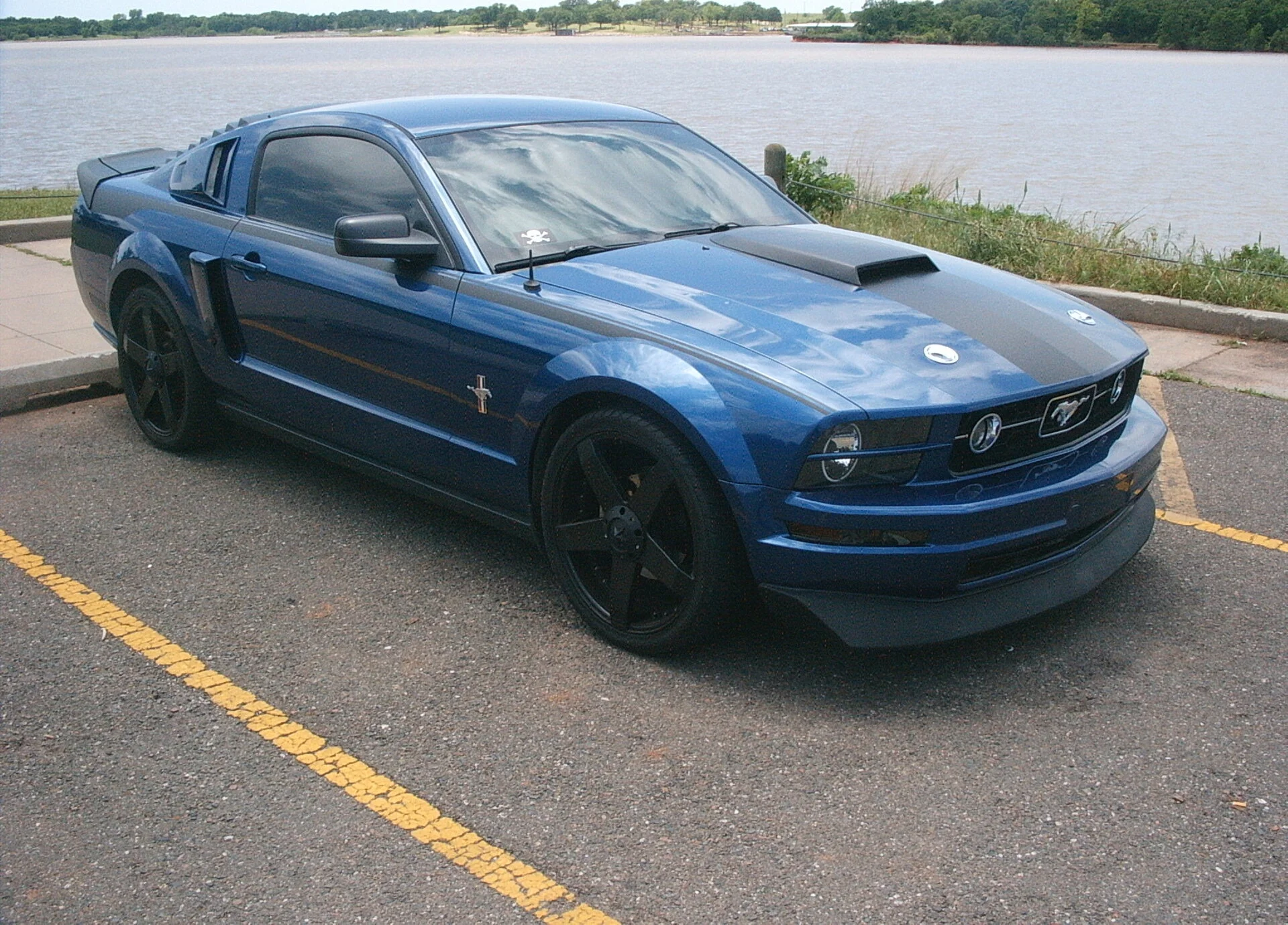

As to why I ended up with a V6 Mustang? Well, I have never intended to own a Stang period. They're all over the place here where I live. Dime a dozen. See them at work sometimes, exiting the premises, lined up four or five in a row. But, I saw this one while out driving one day and got bitten by it's looks. The color, dark blue and flat black, the hood scoop and rear spoiler. Just caught my eye. V-6 or not. And having bought it, I've decided it has to be Stang that stands out from all the others, V-6 or not. I'm more into cornering and handling than all out top speed or acceleration. I spend more time out at the local lake hauling ass around the twisty road that encircles it, than anywhere else. That road is 15 miles long with one stop and not heavily patrolled. I think the V-6 Stang has much closer to a 50/50 weight bias than any car I've owned before. This thing gets around that road so dang nice. I love it!
Two pics, when purchased and now. It's come a long way. And still going, not done yet. I get more thumbs up and nice car than I do in my Lightning. To most people, the Lightning is just a truck. Some owners even abuse them in that form. Not me, mine is carpeted in the bed and lives in a garage. LMAO!
The Pirate with the two missing teeth in the windshield, is just there until I get the vehicle into a tint shop and have the windshield tint repaired. It had a school parking sticker there, and when the original owner peeled it off, the tint was damaged. This sticker seemed the perfect "temporary repair".

As to why I ended up with a V6 Mustang? Well, I have never intended to own a Stang period. They're all over the place here where I live. Dime a dozen. See them at work sometimes, exiting the premises, lined up four or five in a row. But, I saw this one while out driving one day and got bitten by it's looks. The color, dark blue and flat black, the hood scoop and rear spoiler. Just caught my eye. V-6 or not. And having bought it, I've decided it has to be s Stang that stand out from all the others, V-6 or not. I'm more into cornering and handling than all out top speed or acceleration. I spend more time out at the local lake hauling ass around the twisty road that encircles it, than anywhere else. That road is 15 miles long with one stop and not heavily patrolled. I think the V-6 Stang has much closer to a 50/50 weight bias than any car I've owned before. This thing gets around that road so dang nice. I love it!
Two pics, when purchased an now. It's come a long way. And still going, not done yet. I get more thumbs up and nice car than I do in my Lightning. To most people, the Lightning is just a truck. Some owners even abuse them in that form. Not me, mine is carpeted in the bed and lives in a garage. LMAO!

Your Lightning has some slick radial Cog pulleys, specifically the main drive, Belt looks like it needs to be setup w/deeper Cog ribs.
What’s the U/D, O/D %, how much boost?
42lb injectors..you running a mono blade TB butterfly? Capable of so much more... Then again, if you’re happy with it, that’s all that matters.Sweet! How’s it hook up?
Hmm...my 64’ GTO pic., all I have left of it.

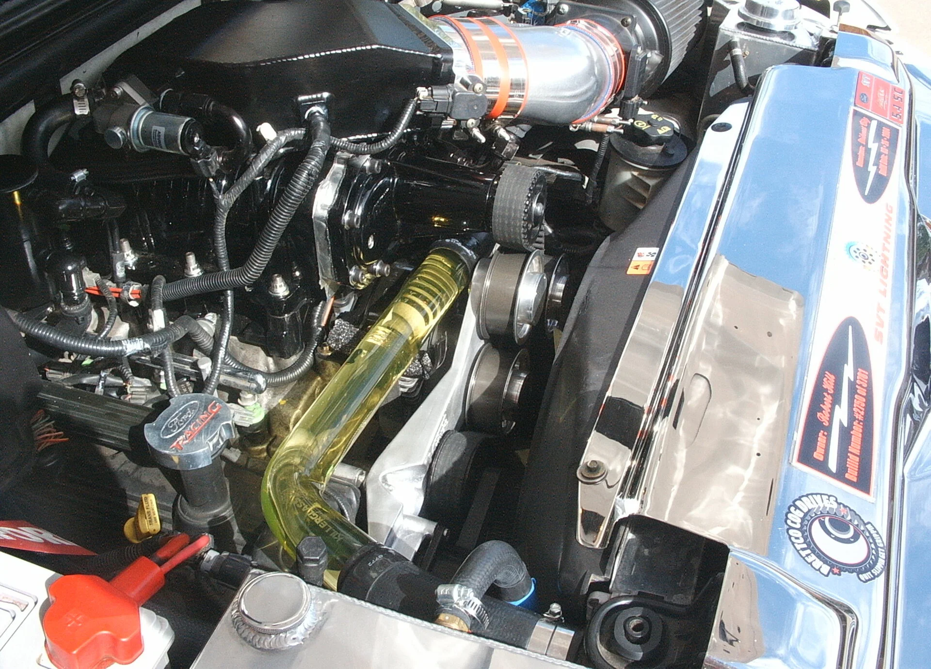

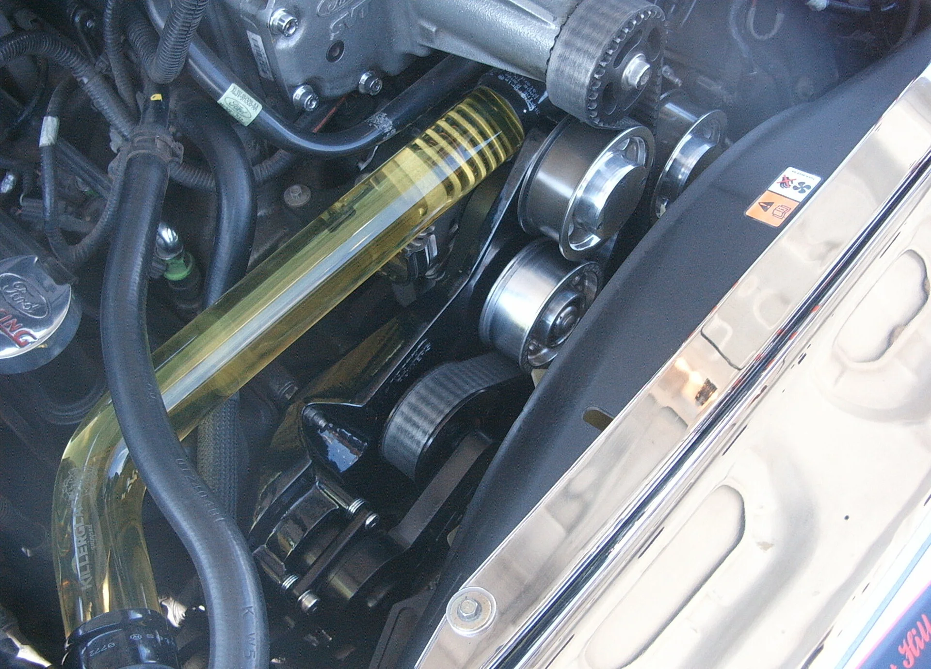

The lower is an eight inch, the upper three inch. So nine pounds boost. The belt is a Gates Power Grip. Cogs are custom made and no longer available. Thankfully I have a second set with a nine inch lower if I ever want to make 13 pounds boost.
Yes, Accufab single blade throttle body. Fuel system is totally stock so far. If I ever put that nine inch lower on, I have to go with stronger pumps and new injectors. For where it's at now, no need.
The idler pulleys were also custom made and no longer available. The pulley bracket is also Magnum Powers and features three pulleys rather than the stock two.
