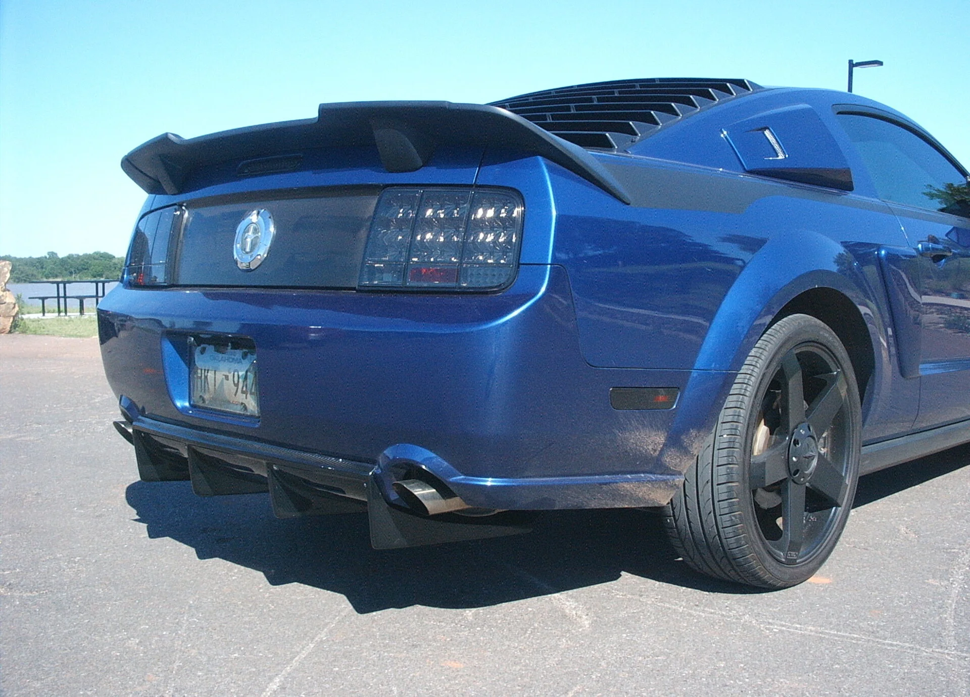

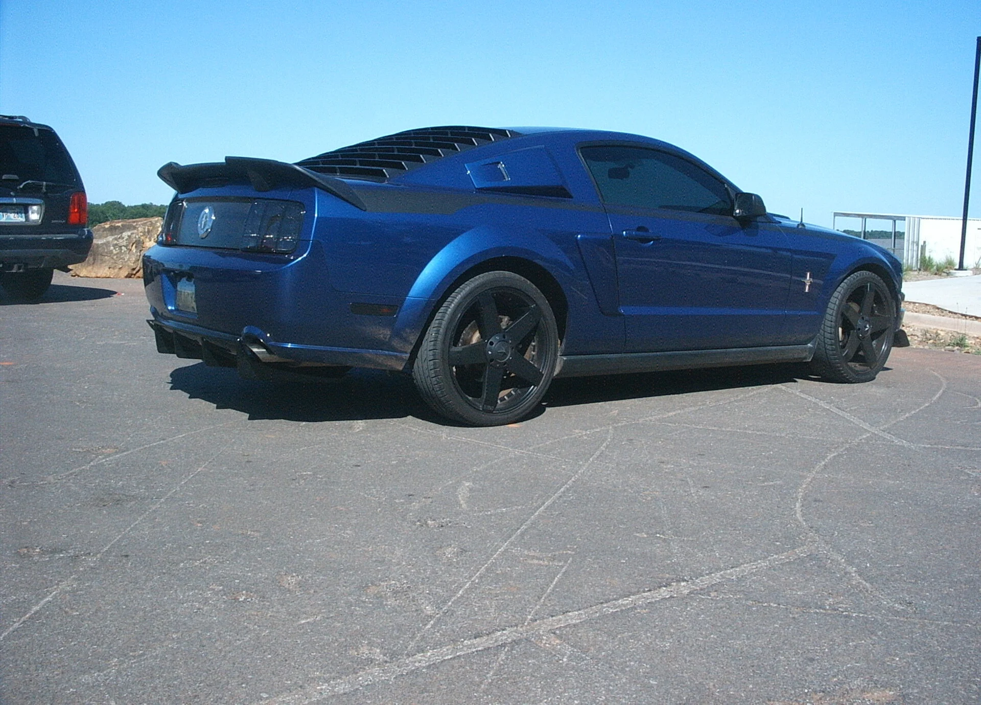

When I first bought the car, I had a very bad coolant leak one day, darn heater hose at the plastic up-pipe on the thermostat housing. Coolant everywhere, all over the front of the engine, top of it, just everywhere. I fixed it by inserting a metal pipe into the stupid plastic pipe, so the clamp can be tightened better. No more leak. But there may be coolant residue all over the (PIP ??) thing you mentioned? Other than that, the Mustang, like my Lightning, will not see rain, or snow, or salted roads. The old Ranger is my bad weather vehicle.
After putting the diffuser on under the rear end, went out driving. Around 50 miles, both highway and hauling ass around the lake. Checked the scanner, no codes. clean. Will be heading out to the lake again here shortly. Need to clean the thing and get a few pictures of the diffuser with clean fenders. LMAO!

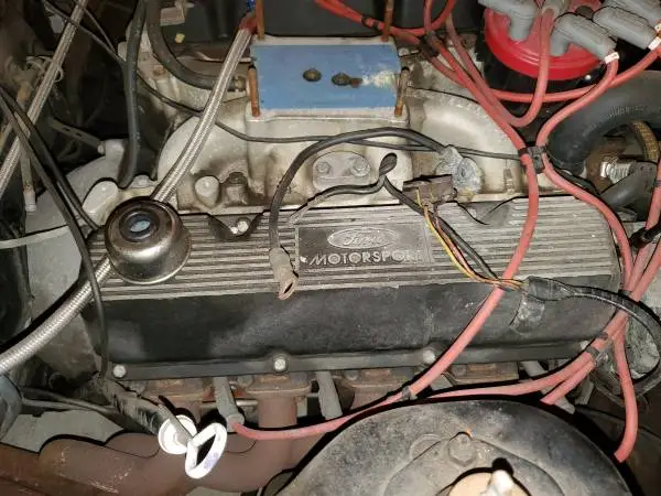

Can you snap a pic of the engine compartment? It may help.
How are your plug wires routed? They should have wire dividers on them, loom over wires where needed & routed away from any spots they can arc to.(Cover studs, Oil Dipstick, etc.).

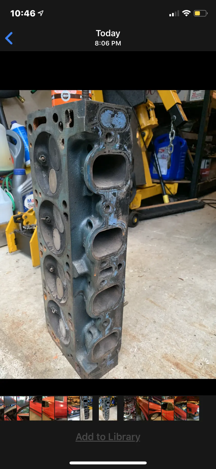

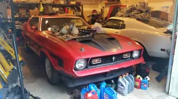

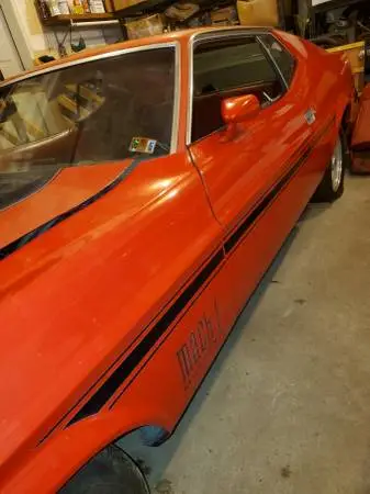

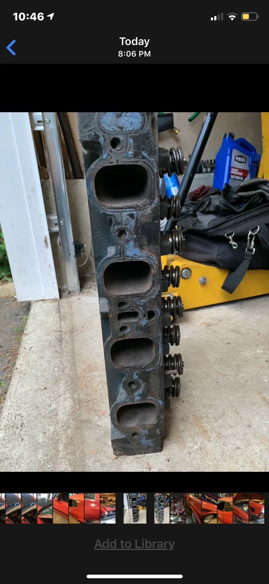

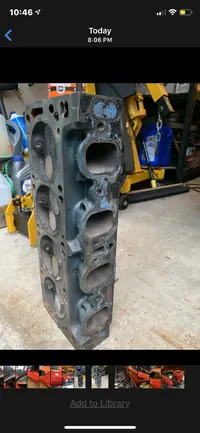

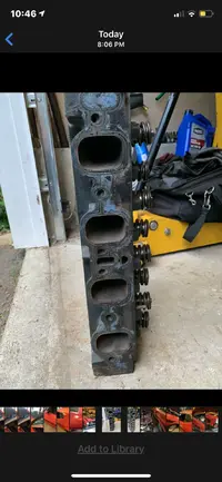

So what did you find? Interested.. You’ll like this....what Did I find.......?
I found (Another) CAR. GARAGE find, Original 71 Mach 1, 351C 4bbl FMX Trans, matching numbers, orig paint, Only thing not original is a 9”rear ::::pout(My Arse!):::. Needs floor Pan (one 1” hole with a tad of surface rust, checked for filler & couldn’t find anything with the Magnet test, then , 302 Stock ratio was 3.0:1, Yeeesh!
9”Rear is the only non AoE part, motors intake, valvecovers 'resistance finagling him down to 5.5K! Older gentleman, working on his own pony is just too much, as you can see, it’s getting in the way, know the feeling & it sucks! He wants it to be where it belongs, on the road, raising hell (within reason) and going to shows..
Holy Shiatsu I’m a Psyched individual today, my eldest daughter said she wanted it & I growled at here like a Lion fighting for the entire share of the kill.lol.
“Of COURSE you can have it, Sweetie.....once they PLANT me..”
