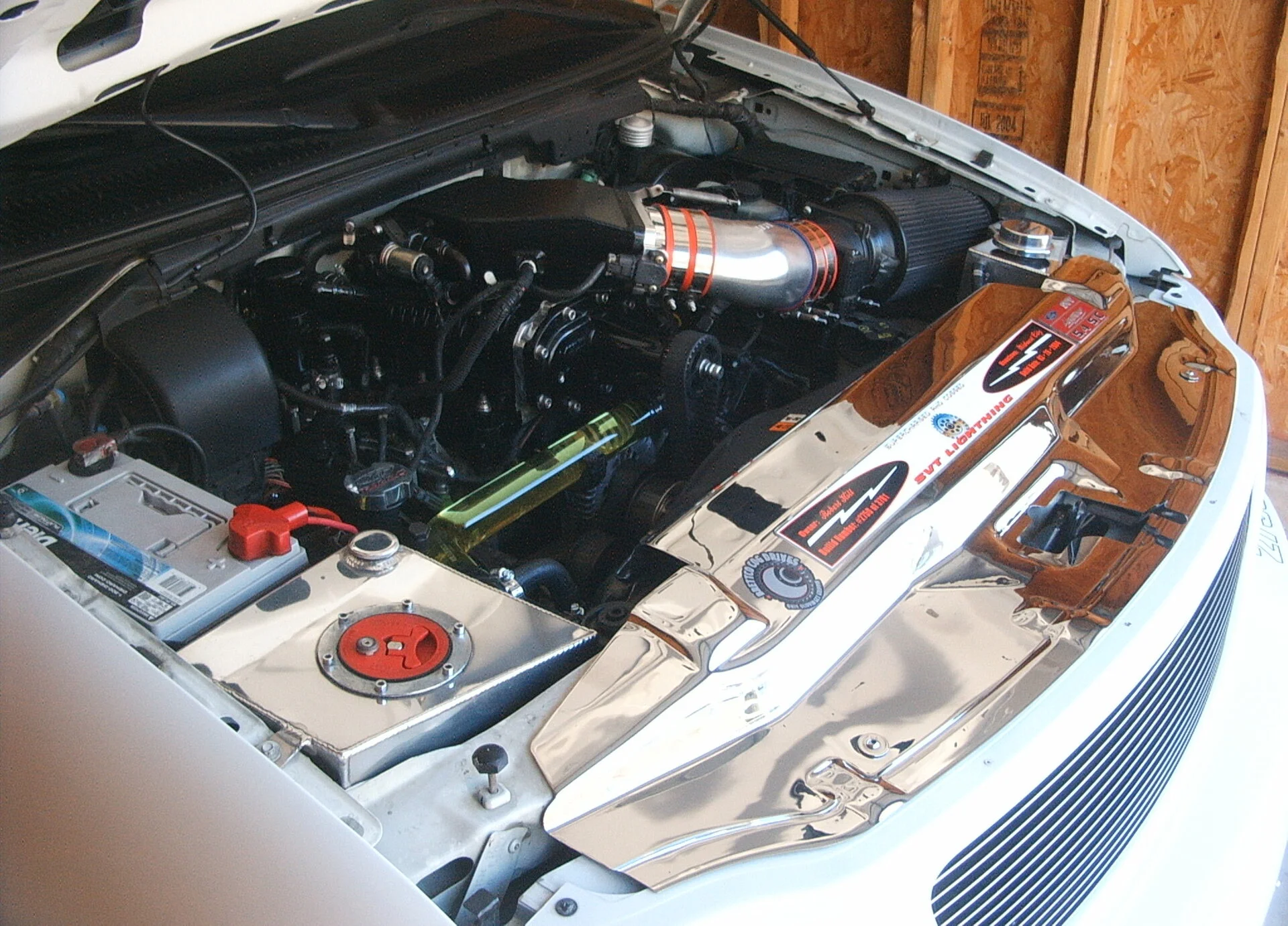

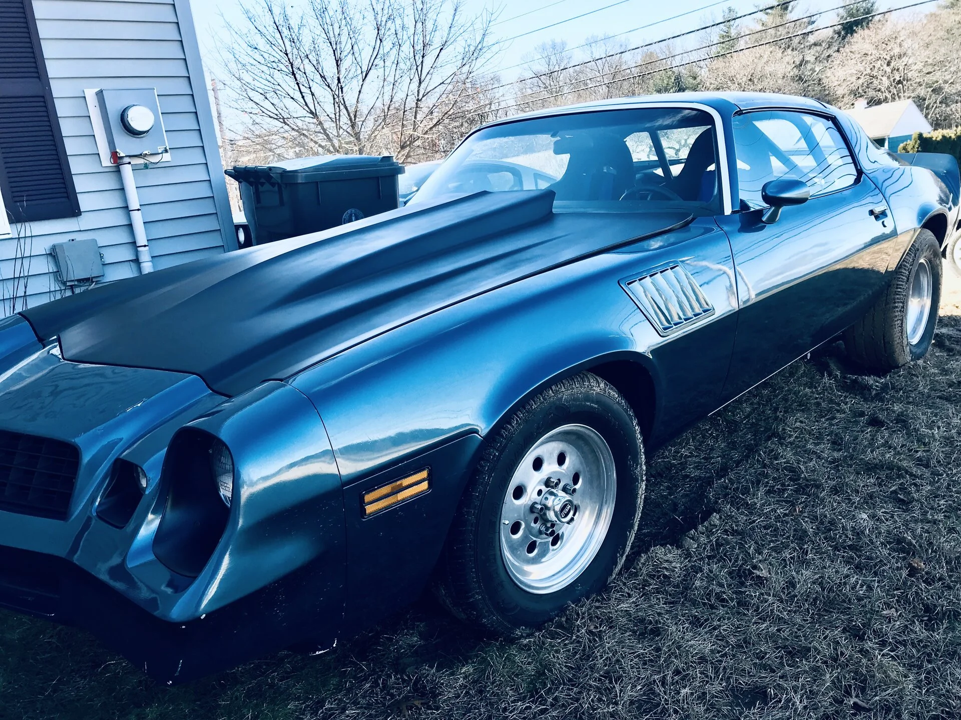

Last picture, Lightnings engine. See why it needs 93? ;-)

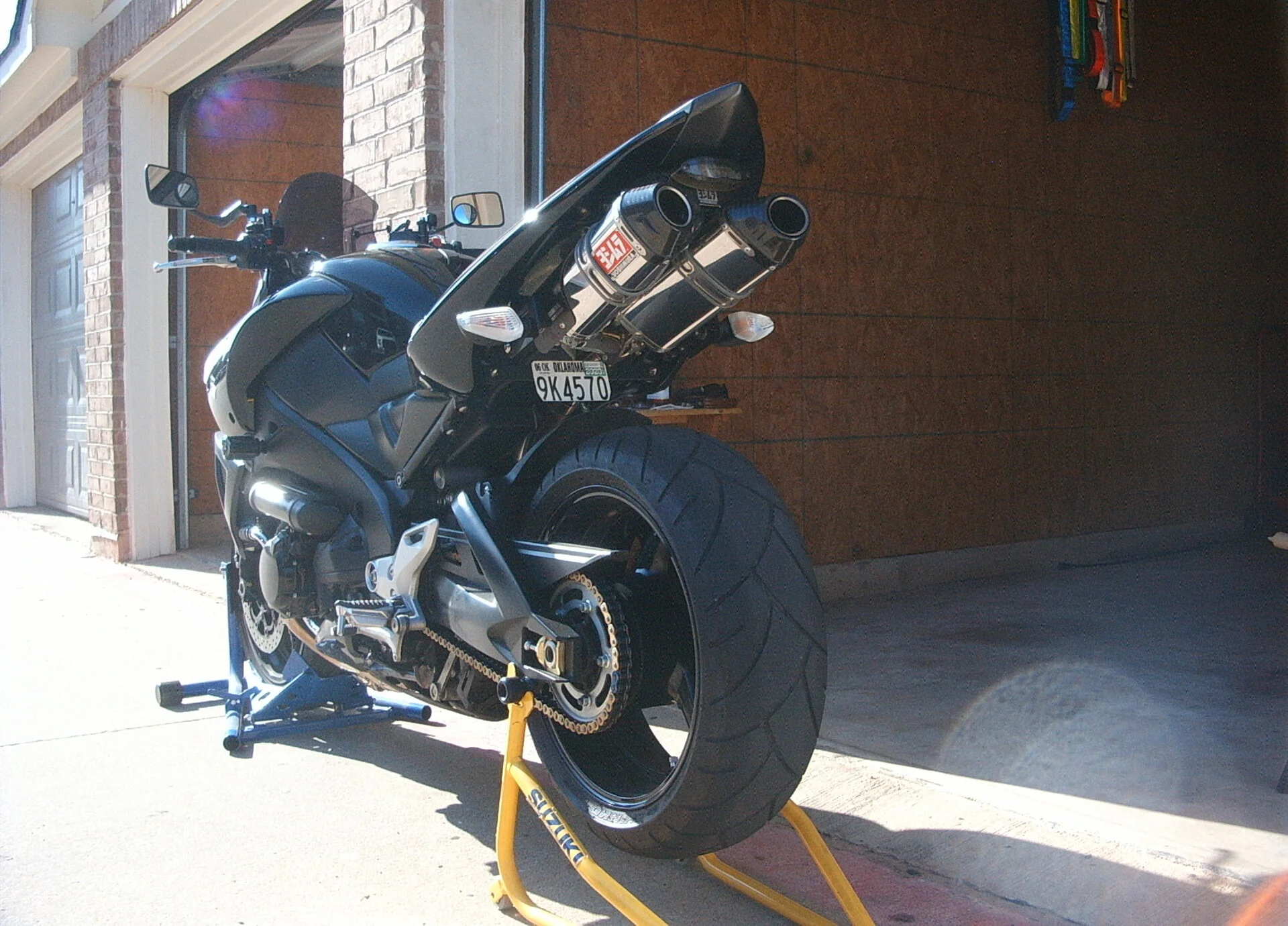

Btw, the 93 I keep in my garage is generally for my two bikes, neither of which has ever complained about it. And it's never more than a week or so old. I don't keep it for long, I know it doesn't last.

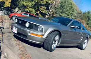

Had a guy yesterday tell me I had "one bad-ass Mustang dude!" Had two today tell me my car was gorgeous. One asked me if it was a Shelby? I said, "yeah, if they come with a V-6." LMAO. The other, while I was putting in the 89, asked me what year it was. Told him 07, his eyes got bit. He really liked the front spoiler, commented about it quite a bit. Something about having to be careful of driveways and such. I'm like, "yeah, hit it yesterday." LOL! First time for everything.

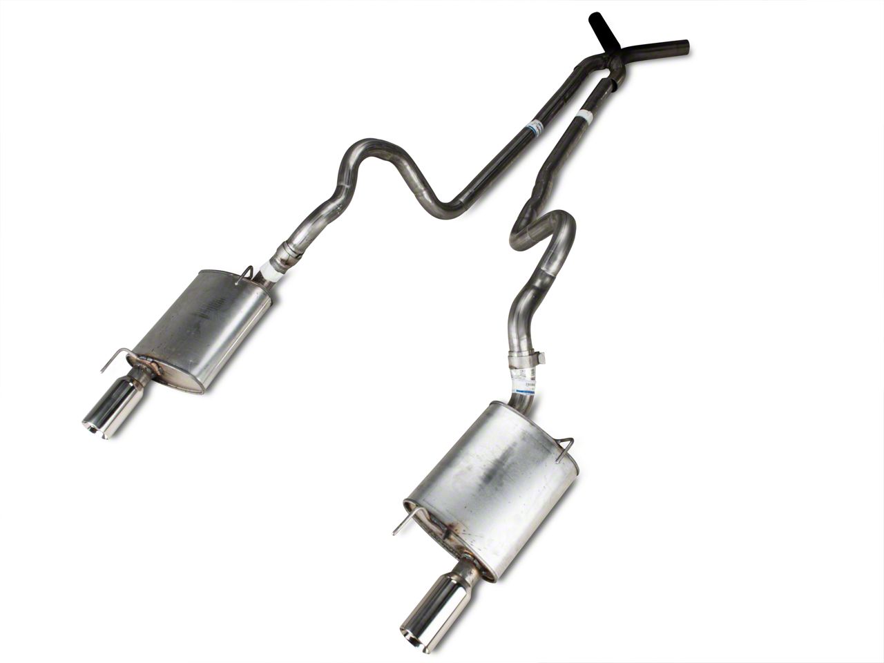

4.0 Exhausts from Ford- yes, they made a dual X conversion, used the 08’ Bullitt’s mufflers, for instance, below...
If the OE Cat’s /mid were swapped out, would also sound much deeper.take a peek.

Yeah, lots of comments on the GT, same with buddies of mine that own S197’s- and this all seemed ramp up around 2014- 2015 out of the blue, “Such a nice Mustang”.. “is that the new Mustang?”..or..”God, Ford has really outdone themselves”, etc.
I tell them it’s an 08’, and they have this look of disbelief. “Reeeeally? Wow!”.
Landmark comment on the GT500...”That a SS or Z-28”?lol!

I posted this earlier in the exhaust thread, but I'll repost it here.
So, here's what I see looking at my exhaust. First off, my Lightning had four cats, now has two high flow, my Ranger has four cats. The Mustang has two, bolted directly to the manifolds. Don't know if that's stock or not. Then at the bottom of the cats, a piece of three inch pipe is welded to them and bends them 45 degrees to be parallel with the vehicle. Then two pieces of three inch pipe about 2.5 feet long welded to those. Then two pieces of three inch curve around gracefully and form a Y under the passenger seats. Then a piece of three inch runs straight back and arcs gracefully over the axle to a three inch "T". Then two pieces of three inch depart the T and are welded to the Ford mufflers. Then two three inch tips welded to the mufflers. When you look in the tips, you see the forward face of the muffler, and the internal pipes are perforated wit ha bunch of holes.
It all looks fairly recent, not a lot of rust on any of it. Looks recently done and speaks of custom work. IMHO, three inch pipe should be plenty sufficient for a 240 cubic inch V-6.
Assuming this isn't the stock exhaust, I am going to go to my favorite muffler shop and have them replace the two three inch tips with four inch tips. That'll meet my needs just dandy. It sounds really good, so I am fairly certain it isn't stock. But yet it's not rip-roaring loud either, which is fine by me.
