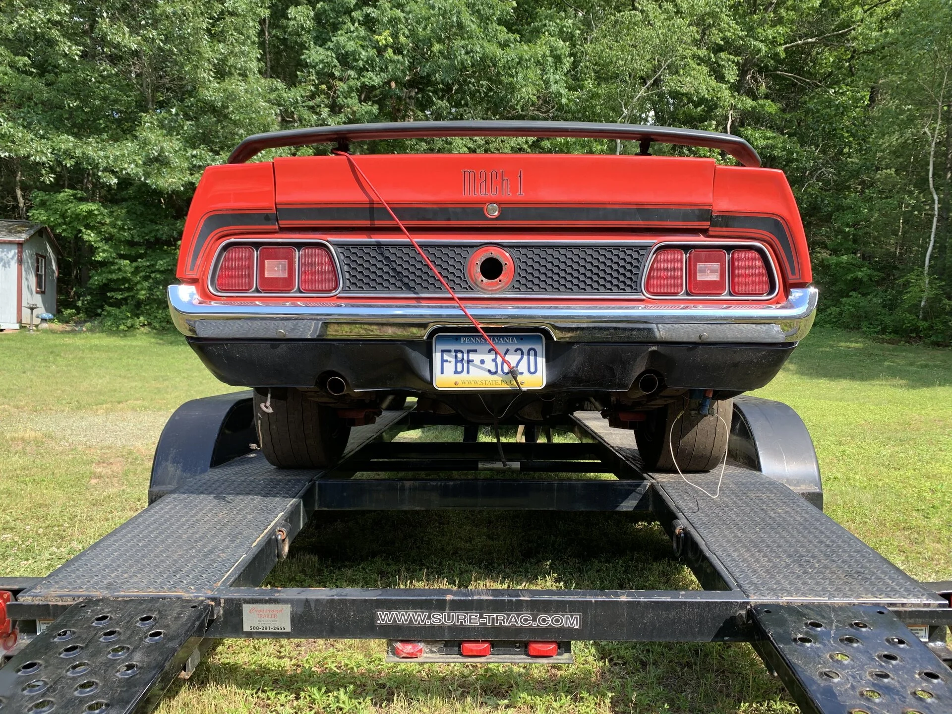

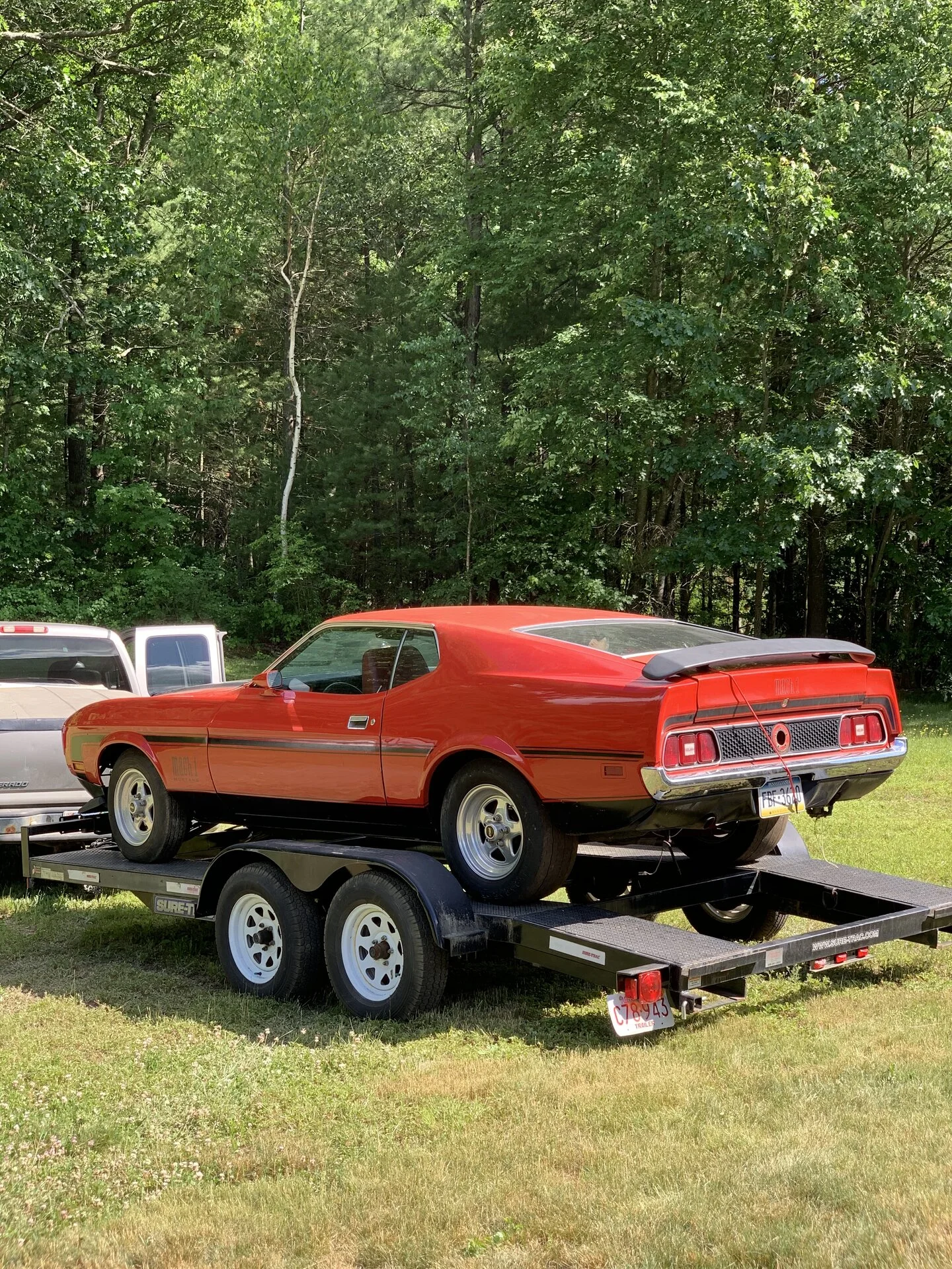

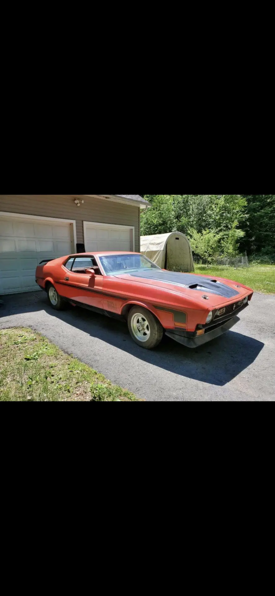

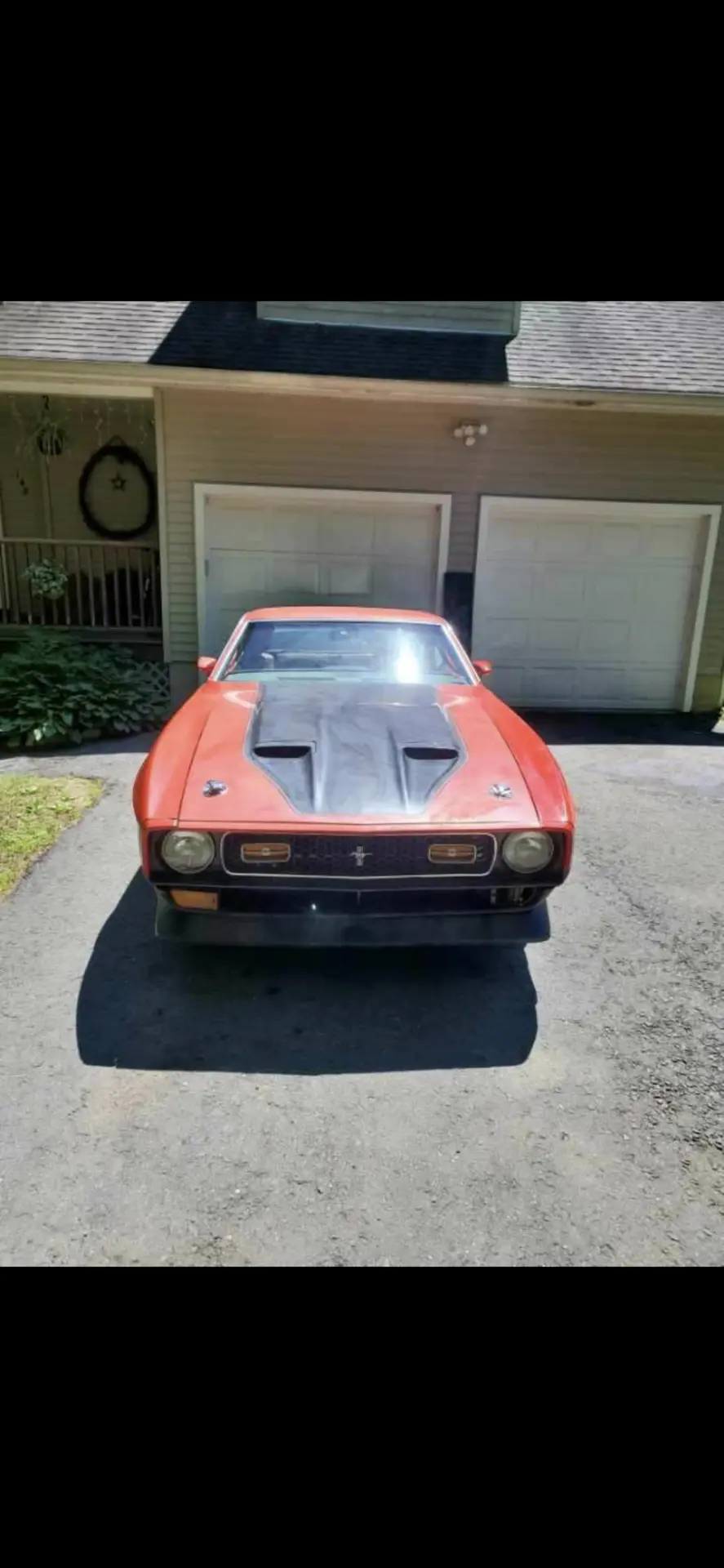

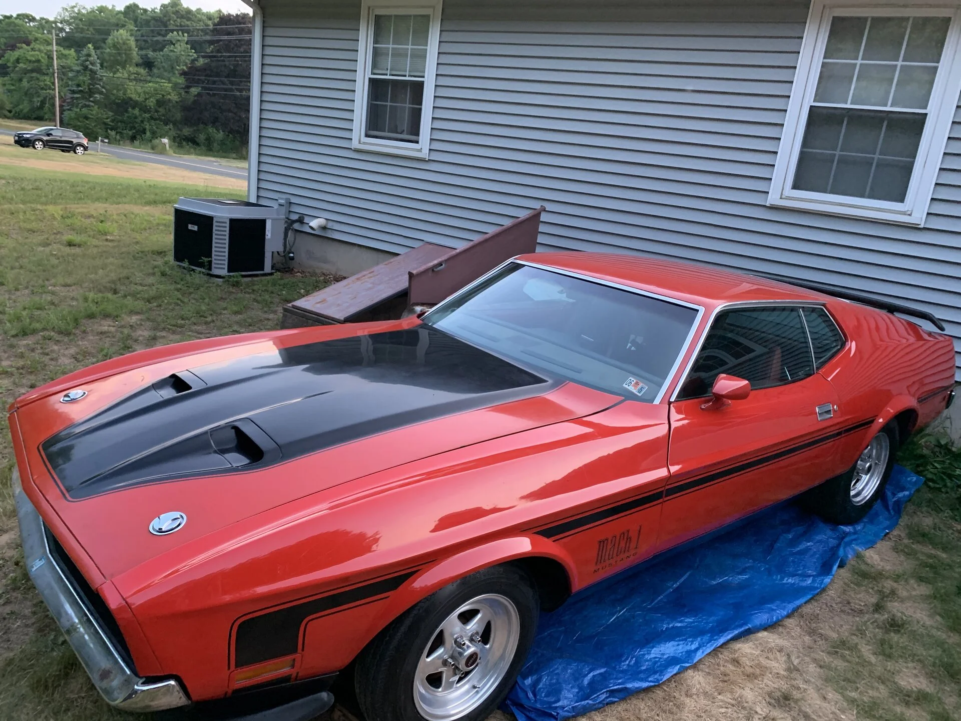

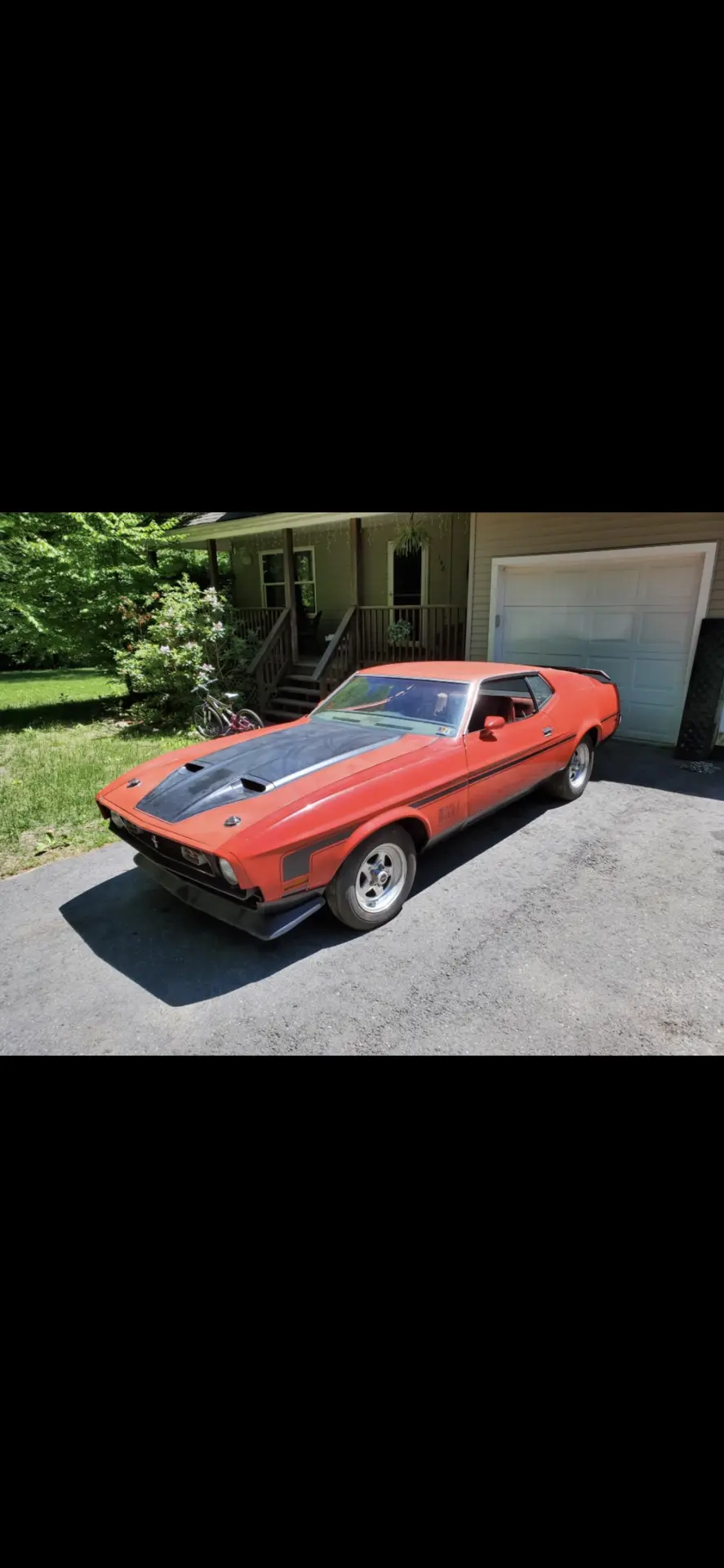

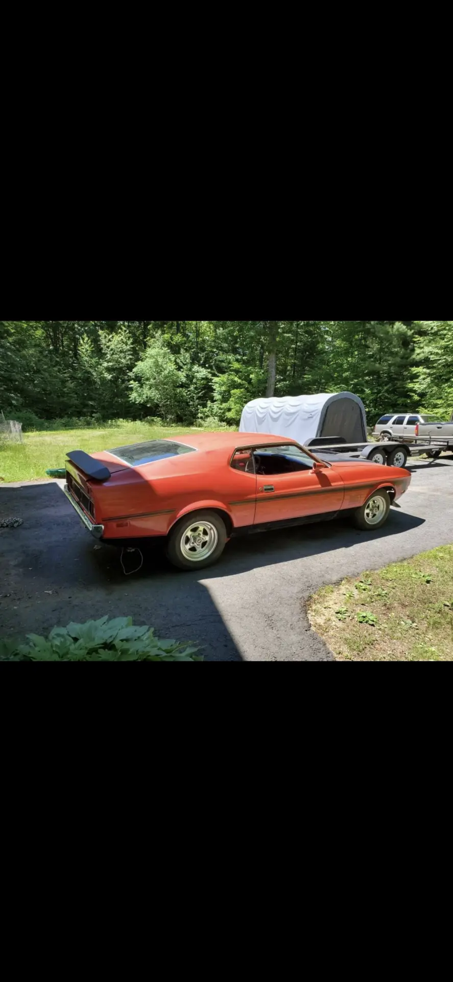

Few newer ones...hasn’t seen light in years, and likely how it avoided rust.
-John

That's Eleanor! Although in the 74 movie, Eleanor didn't have a front or rear spoiler. Nor the hood scoops. Nice find!

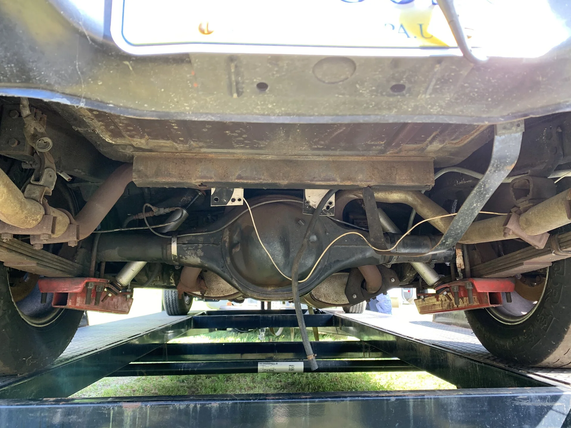

Rust, not bad at all. Work to be done for sure & I’m lovin’ every minute of it! Bring it on, I will finish this over the winter!
Looks like a Ford 9”, it looks a tad beefier than a 71’ 9”, bigger driveshaft & loop, was psyched some huge dome pistons stared back at me when I pulled plugs & stuck my Borescope in to have a look see..
Solid lifter Cam & 0.630-0.640 lift (+/-) with a dial indicator on a valve stem. Roller rockers. Done for today, rolling in the grass. Shop tomorrow.
Not sure what the owner before the guy I’d bought from was planning, Drags- no doubt, I’m just happy he didn’t cut it all up!

Looks like good old school Lakewood traction bars holding the spring and axle together. Great for traction, usually make the ride like being in a buck board.

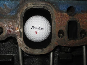

Have a pic that says it all about the Cleveland 4V Heads, thought you might find humorous...like golf? lol (Below)...
Have 2 4V sets, one open chamber, one closed (or Wedge, on the motor). Also a set of 2V head’s, open chamber.
Swept dome pistons for good flame travel rise into the little quench space remaining..

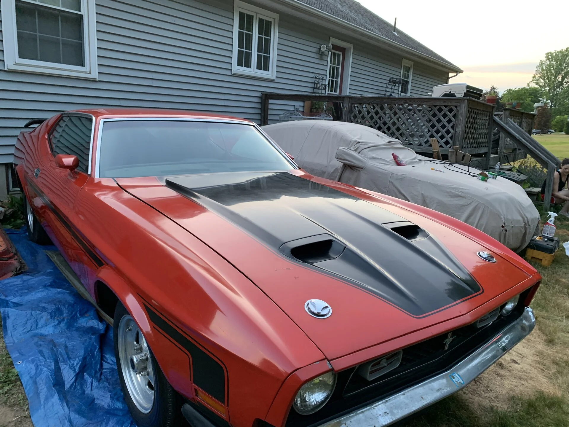

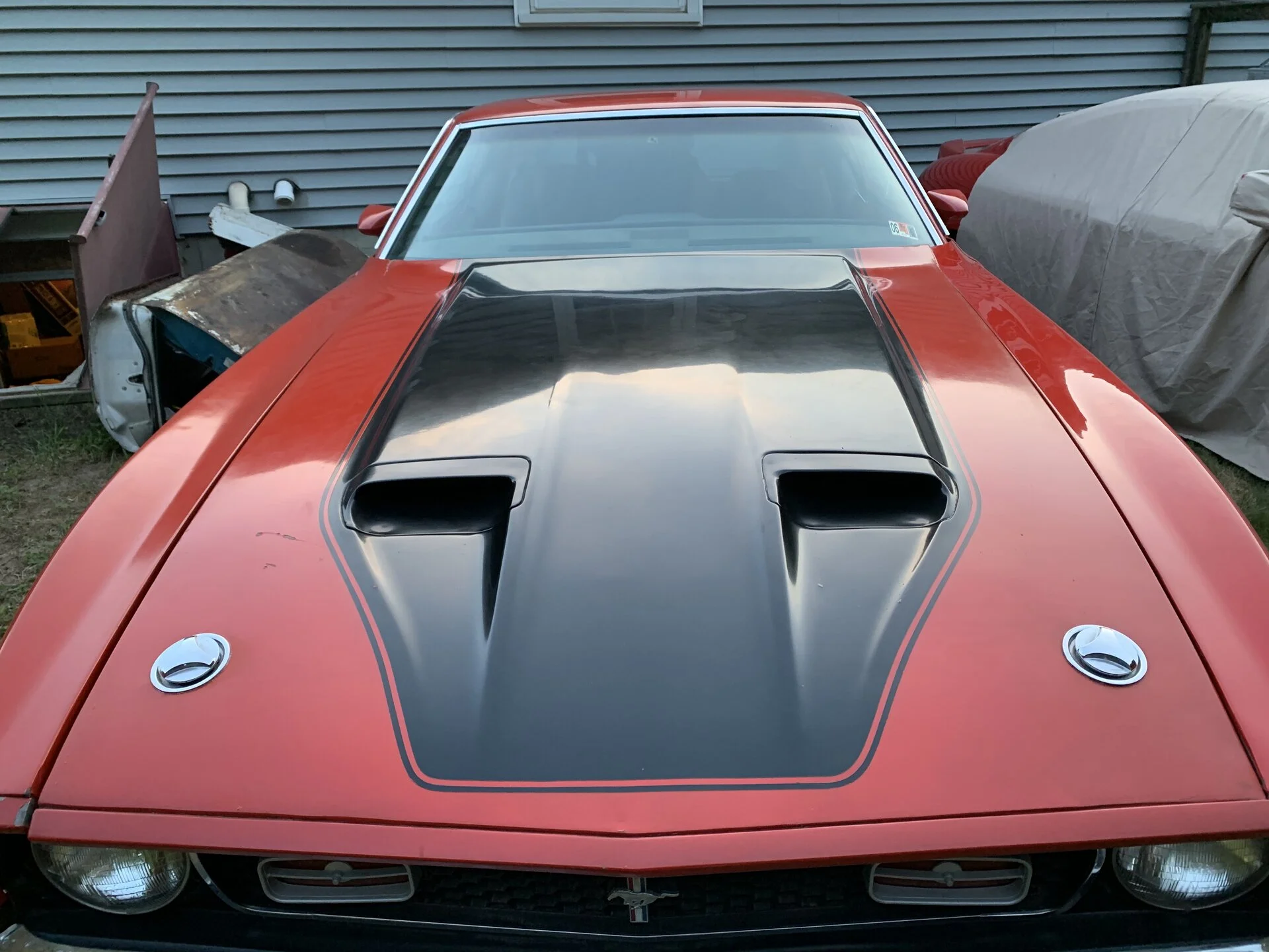

Sooo...after near 10hr’s and a full car hand application & removal of Rubbing Compound required a full can’s usage....91 degrees outside today (no complaints)..
She made me work for it, but was well worth the effort I think.... There really was a sheeny 71’ Mach 1 under all that Oxidation. IMO, Don’t really know a car unless you’ve been over every inch, 2 birds..one stone..
Step to polishing compound & then a coat of liquid ebony, then fixate on firing her off once the parts come in. Going to go back to dual point’s,
Valve-train geometry setup errors in already started premature wear on the Crane gold rockers they’d installed, heavy valve springs were removed/reinstalled after the solid lifter Cam install/break in, all else looks good.
Inside the hood there’s evidence of one heck of a previous carb fireball, intake valve Cyl 1 was adjusted in 015-.020, rather than .025 lash. Its one of “those” Cam’s, lol.
Keep imagining Wile E Coyote with his facial hair all singed off & black with that surprised look when tnt blows up in his face....
Had my share of that, lol.
Interested in how that fuels affecting things, or if a systemic issue finally reared it’s head(?)
Well, until you post..wish you & your family well!
-John
