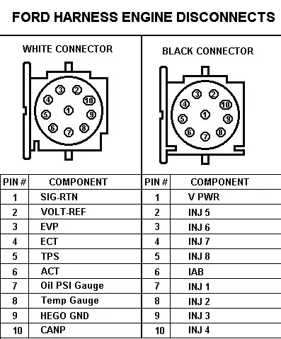

Pull your salt and pepper connectors apart [carefully] and inspect, clean , and lube all the pins.

Where do I find that connector? It looks familiar, but I'm not near the car currently.
