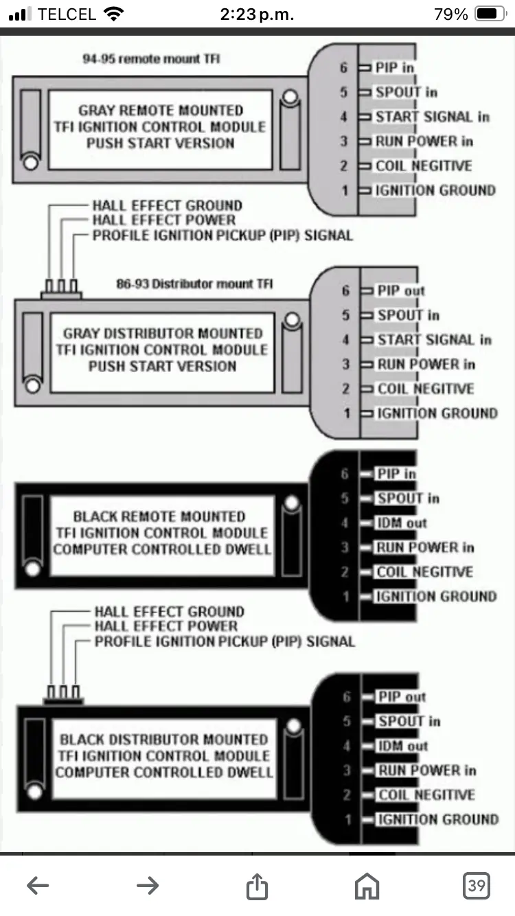

Searching for answers to that no advance condition I just tested the spout wiring and I have continuity from the spout to the ignition control module (TFI) and from the spout to pin 36 of the ECU. The funny thing is that all wiring diagrams that I saw of the ignition control module (TFI) that show the spout to be on PIN number 5, my 90 GT has the spout wire is on pin 5 also. But this 94 has the spout wire on PIN number 6 and it seems unusual. So besides that “Anomaly” what else could be the cause of a non advancing timing??? The computer that my friend brought to me looks like it was in the garbage!!! What do I supposed to see coming from pin 36 of the ECU???

And why the wire coming from the spout is at the top (On the ‘94 is at the bottom) and not one place before? As the pic at the bottom?
