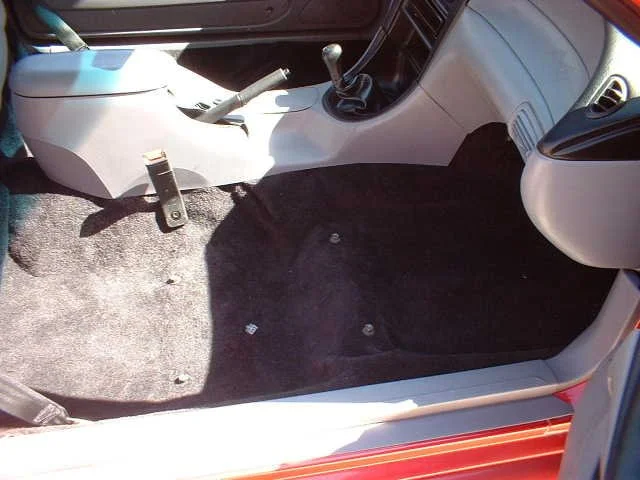

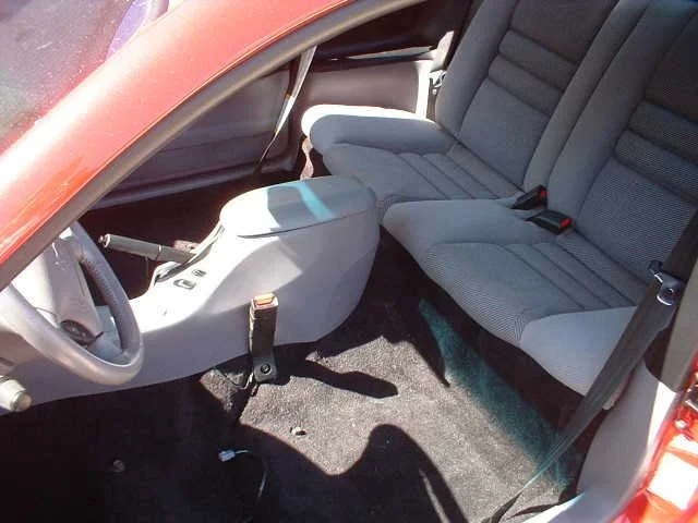

The door sills are not glued, they have plastic clips. I have taken mine off at least 5 times and they are still fine.
I replaced the carpet in mine about 1.5 years ago due to some water damage. I went with black and I think it looks great.
All you gotta do is remove the seats - 4 bolts/piece + unplug the connectors under the seats, and remove the center console - take out the tray in the middle and undo the 2 screws & also remove the shifter assembly and undo the screws holding the console to the dash. It helps to have the e-brake in 100% up position to get the console out.

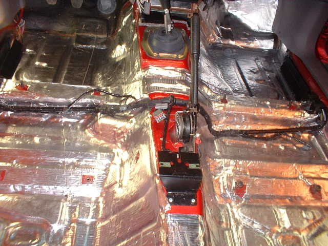

Also, you gotta usually cut all the holes and remove some of the carpet to fit under the console. You gotta poke holes for the seat bolts, seat belts, and wire connectors. I also put down a bunch of dynamat while I had it all apart, helped a bunch with exhaust/tire drone.
Also, I suggest getting some carpet glue for the spots that dont stay in place. Theres a couple places in mine that bunch up and wrinkle, so I gotta put some adhesive down so it looks factory tight.
