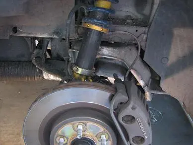

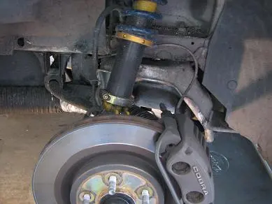

I am thoroughly confused at this point. I purchased a Baer "Track" 13" rotor front kit on the understanding that it was the same caliper as a PBR 2-piston and is quoted in numerous places as being the same as the "94-up Cobra" brake caliper. I bought them partly for the reason that it would be easier to find replacement parts than for something that was never an OEM part.
I would love to be able to purchase the spindle with Dennis' Cobra bracket.
Can anyone enlighten me as to the difference, if any, between the PBR calipers described below as "Cobra" and the PBR "Track" system I purchased that is pictured here?:
First, the Cobra brake calipers:
and mine:
So, what's the difference? Or will Degins' kit, which works with a Cobra brake, work with my PBR/Baer Track kit? Any help appreciated - or am I taking crazy pills!??! :crazy:

To my knowledge they are the same caliper with a different esthetic treatment. They use the same pads and rotors if I'm not mistaken.
I haven't examined one of the Baer pieces, but from everything I've heard, you are correct. If they use the same bracket as the Cobra piece, there will be no problem with mounting them on my spindle using the Cobra adapter. The adapter will not be expensive.

The Cobra/Bullitt/Mach calipers will fit into the SN95 V6/GT anchor brackets (caliper cages), but the anchor brackets (themselves) between the V6/GTs vs. the Cobra is not the same. Both share the same 130mm mounting distance between the mounting points where the anchor brackets attach to the spindles, but the Cobra bracket has a higher stand off in order to mount the Cobra caliper over the larger diameter 13" rotor (in a stock application). If these setups are being installed on an earlier application it wasn't origninally designed for, then it's just a matter of figuring out the means to get them adapted on there.
