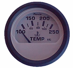

They are not that bad. You just need to learn how to read them. For example the middle of the gauge isnt the middle of the range. Notice how the geauge the ticks are grouped closer together at the left. And as you move right the ticks start to open up. All your gauges work the same. Fuel temp and oil. Once you figure whats what its pretty reliable. the only thing that tends to crap out is the regulator.

Im not saying you are wrong, but my gauges dont have "ticks" it has a tick on the left, a tick on the right and a solid line connecting them in an arc at the bottom. The factory 67 gauges. the only gauge with tick marks is the fuel, battery, and speedo, the oil and temp just have the open sweep, and i have a mechanical oil psi gauge that reads nearly 50 when my factory gauge barely gets off of the bottom "tick" anyway, like i said, maybe I do need to learn to read it, i just figured it would read a little different, maybe my oil psi gauge is bad?

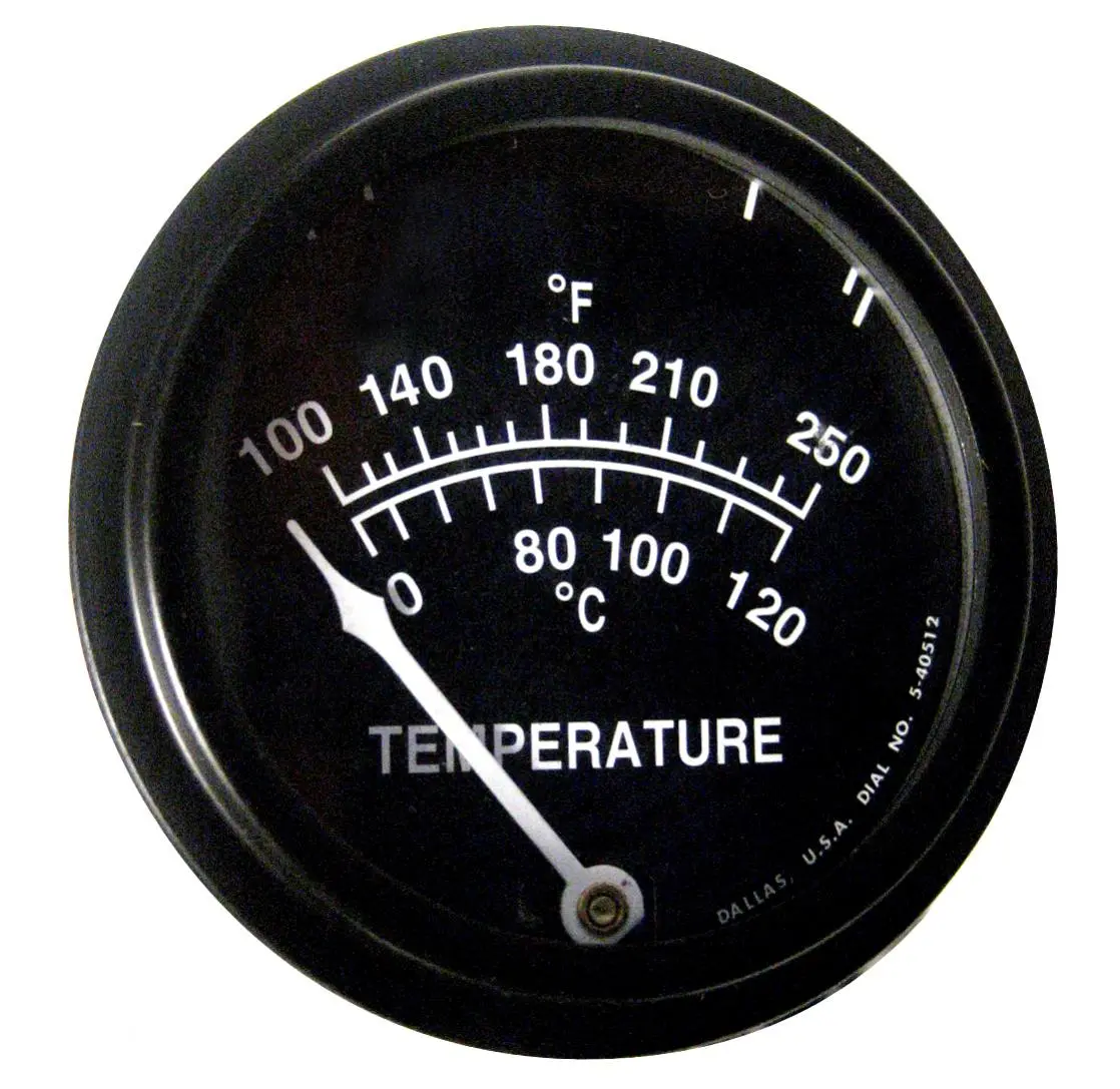

You are misunderstanding me. The point I am trying to get across is that your gauges move in the same manner as the one i showed you above. I am not saying you have tick marks. If your gauges had tick marks and digits they would resemble the gauge I showed you. Not Like this one below. See how the one below you can say each major tick is 50 degrees and each minor tick is 25 degrees. Unlike the one above each tick means a different thing depending where it is.
