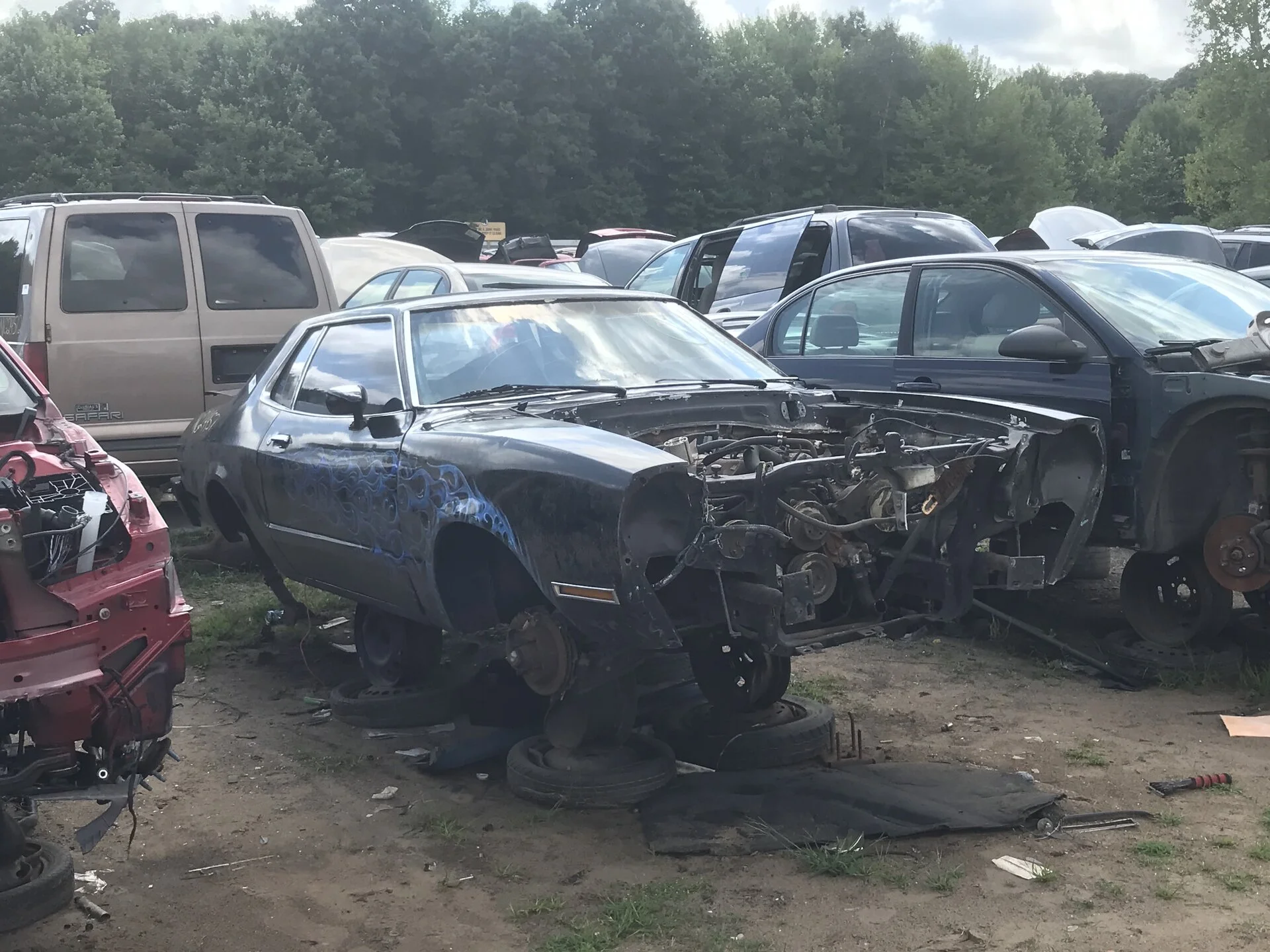

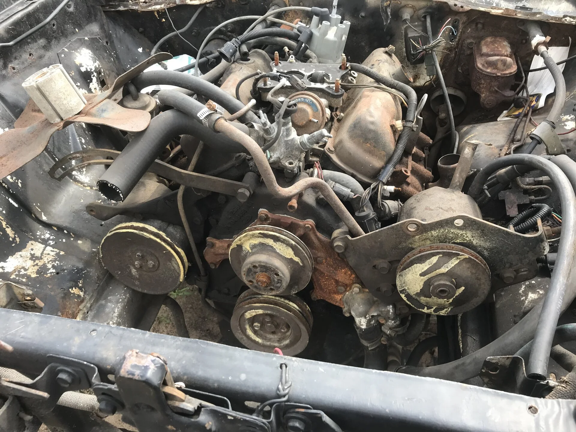

The salvage yard had this listed as a 75. I looked at the door tag and it was 77. I'll look at the vin when I go out there for @2Blue2. Still Minnesota is a long ways.
