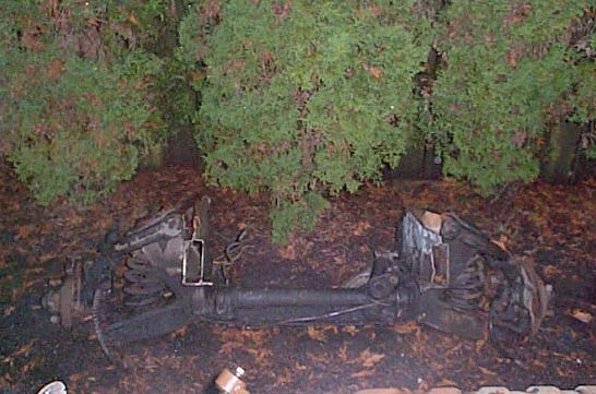

What measurement are you looking for, exactly? I need to head to dads 1st thing in the morning (where alot of my II crap still is...:rolleyes: ) I have two complete front suspension assemblies that were cut off a couple of parts cars that I can EASILY get measurments from. Have to go over there anyways to get pics of a couple of II doors for another fella.

What I would like to know is, where the front suspension subframe is connected to the frame rails. How far apart from eachother are those frame rails. Measuring from the inside of one to the inside of the other is fine.
If the frame rails were completely removed from the subframe or you cannot tell where they would have been exactly on the mounting points. A measurement from the center to center of the subframe to frame rail mounting surface, and a measurement of how wide that subframe mounting surface is will do also.
What I'm trying to figure out is, will the subframe be able to mount to a foxbody unibody without being lengthened or shortened.

Yeahhhh you're not gonna want to send one of these prizes out to VA. A Weee bit to heavy and kinda large.
Anyhow, the measurement (as if the frame rails were removed from the subframe) Is approx 27 3/4"
The wheel mounting face to wheel mounting face distance (suspension extended down) measures approx 56" (give or take an inch plus any gains with suspension at ride level also)
From the outside of the framerail to the wheel mounting face is approx 14 1/4, again with the suspension extended downward.
The 1st measurement is pretty accurate, the other two were eyeballed to the best I could to in the dark and in the rain. :nice:
Here's a pic of what I was measuring from. If you need any more measurements, you can indaicate it on the pic if need be.
