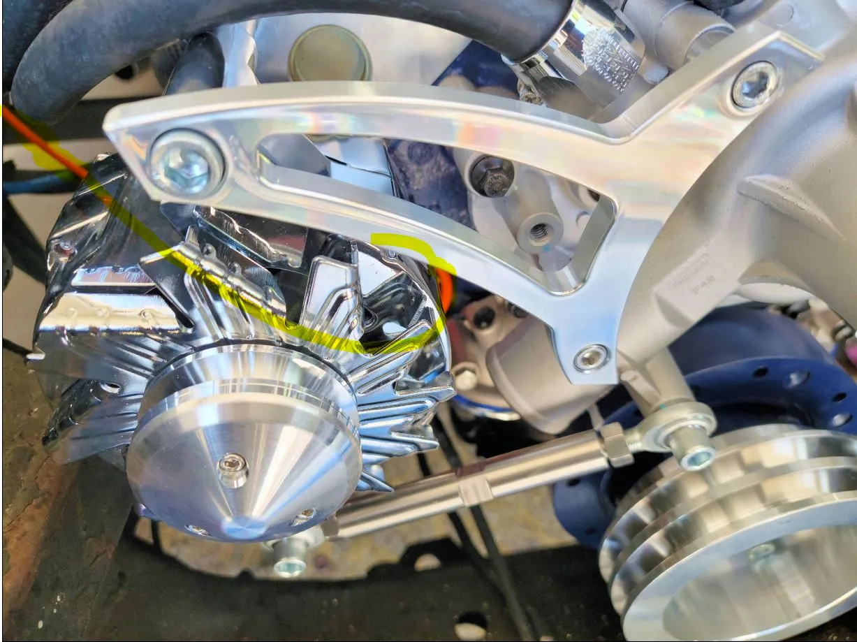

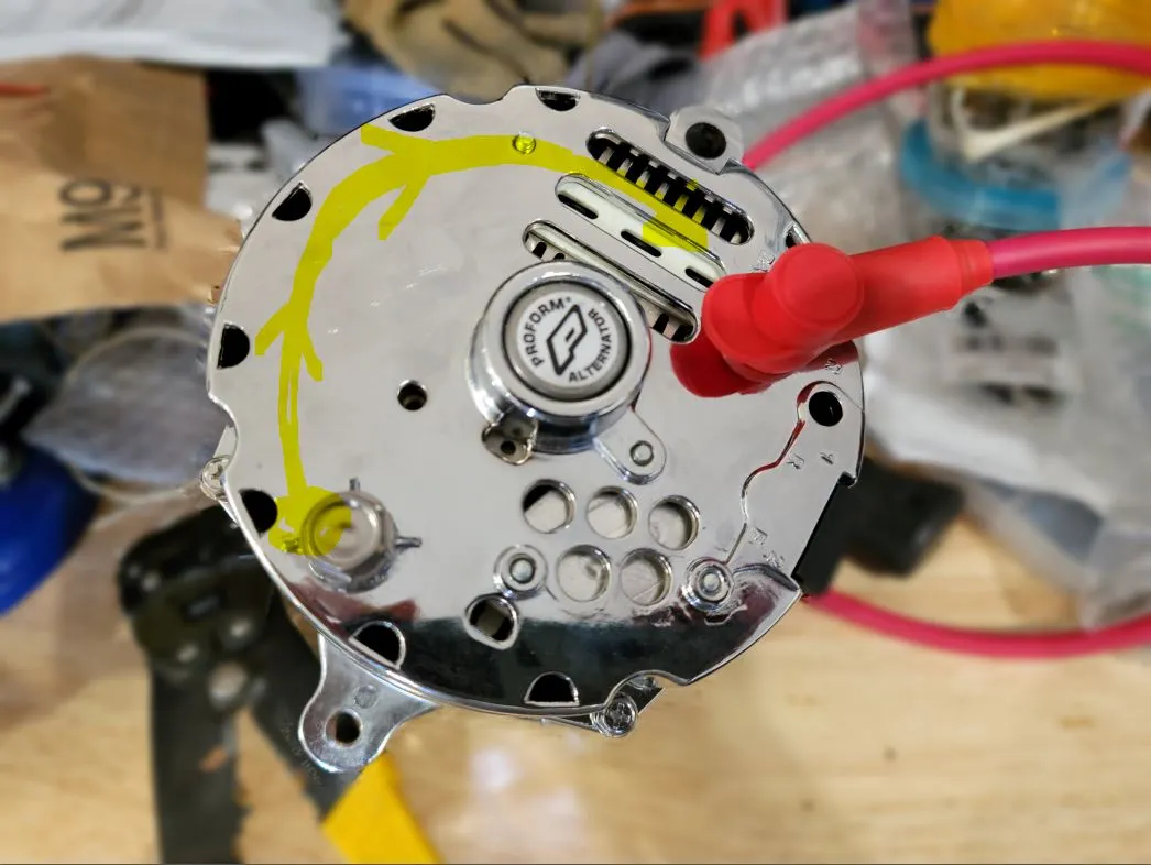

Thank you everyone for the suggestions/help/tips. Greatly appreciated! Note the previous 10 gauge wire coming off of the alternator and trapped between the alternator and block. Didn't like it but thought I had to live with it. Didn't know anything about clocking an alternator until yesterday. Removed and clocked 180 degrees to clear the block and also changed 10 gauge (manufacturer instructions) to 6 gauge (per forum recommendations). Will work way better now!

Fine by me ...since I got the info I was looking for! Thank you again!

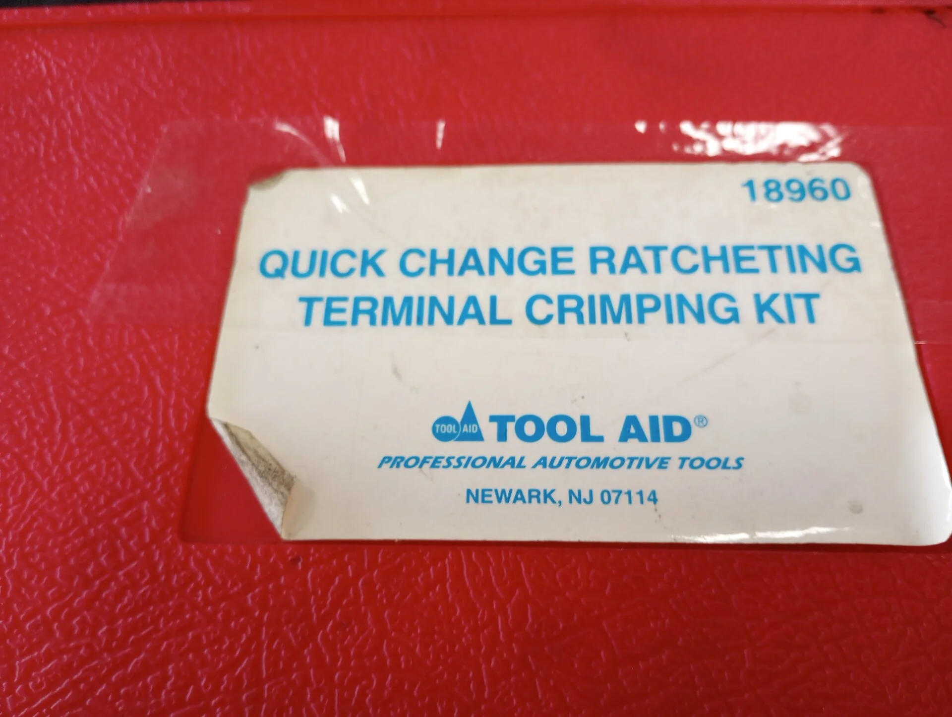

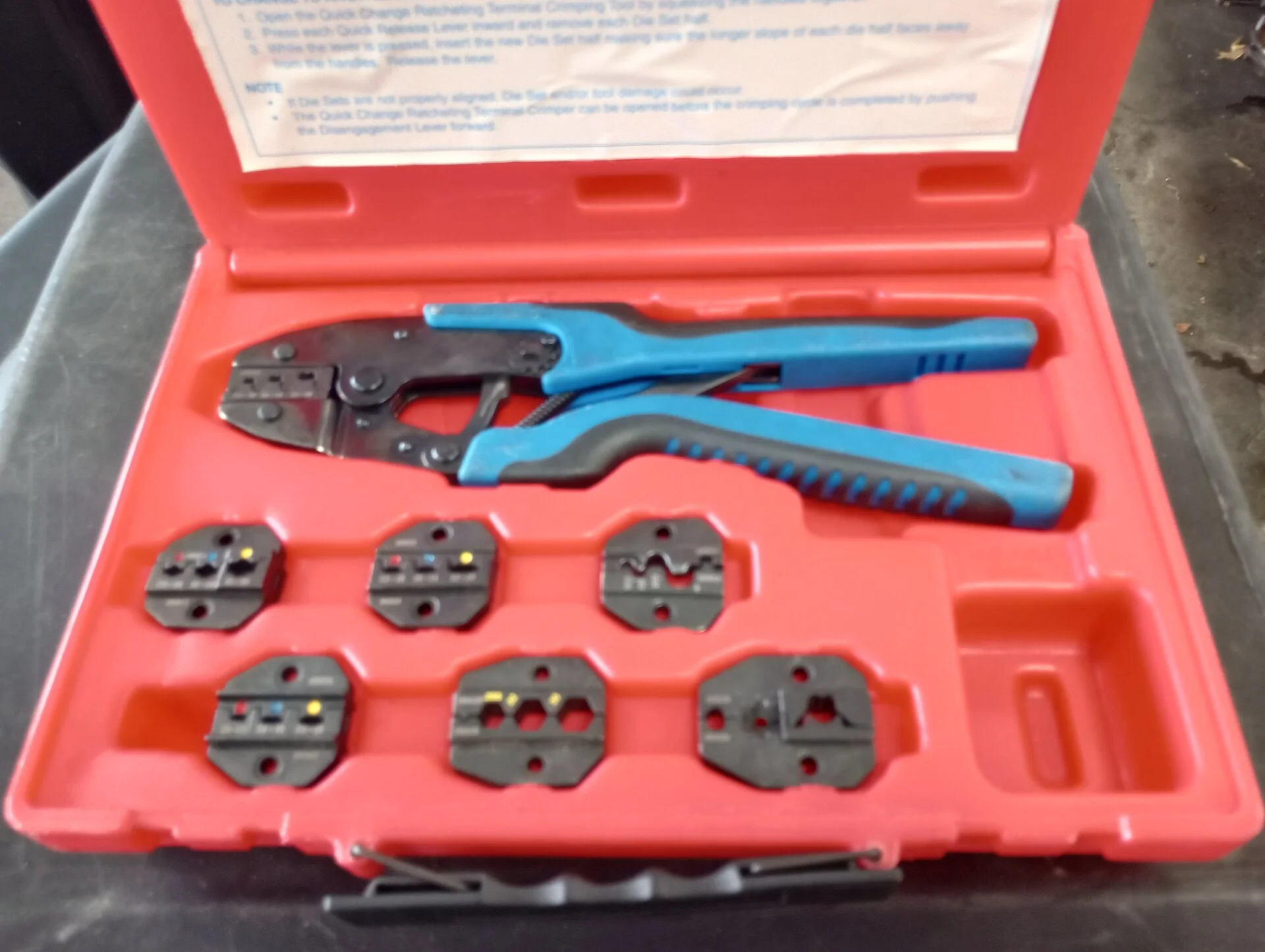

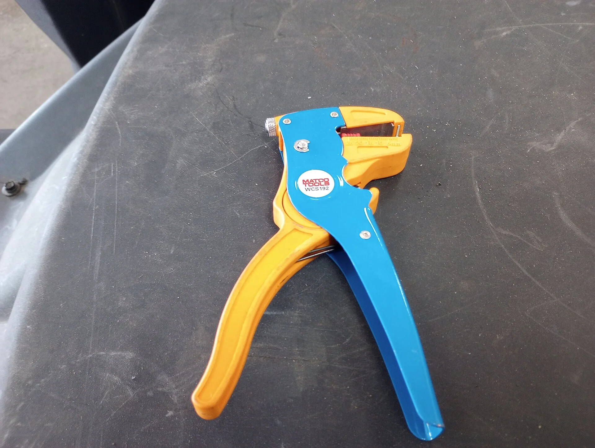

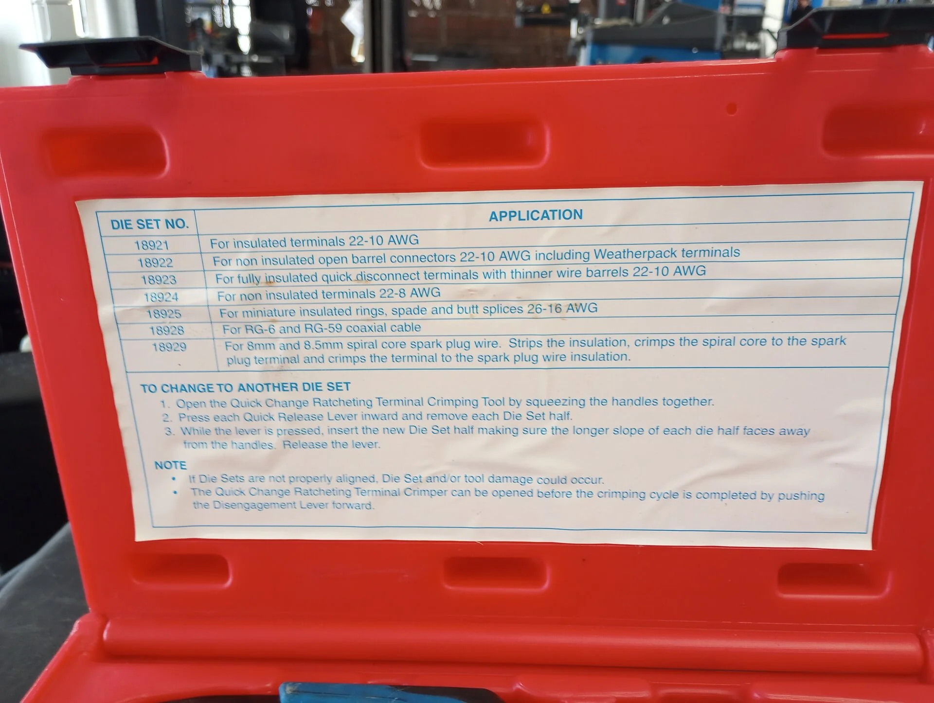

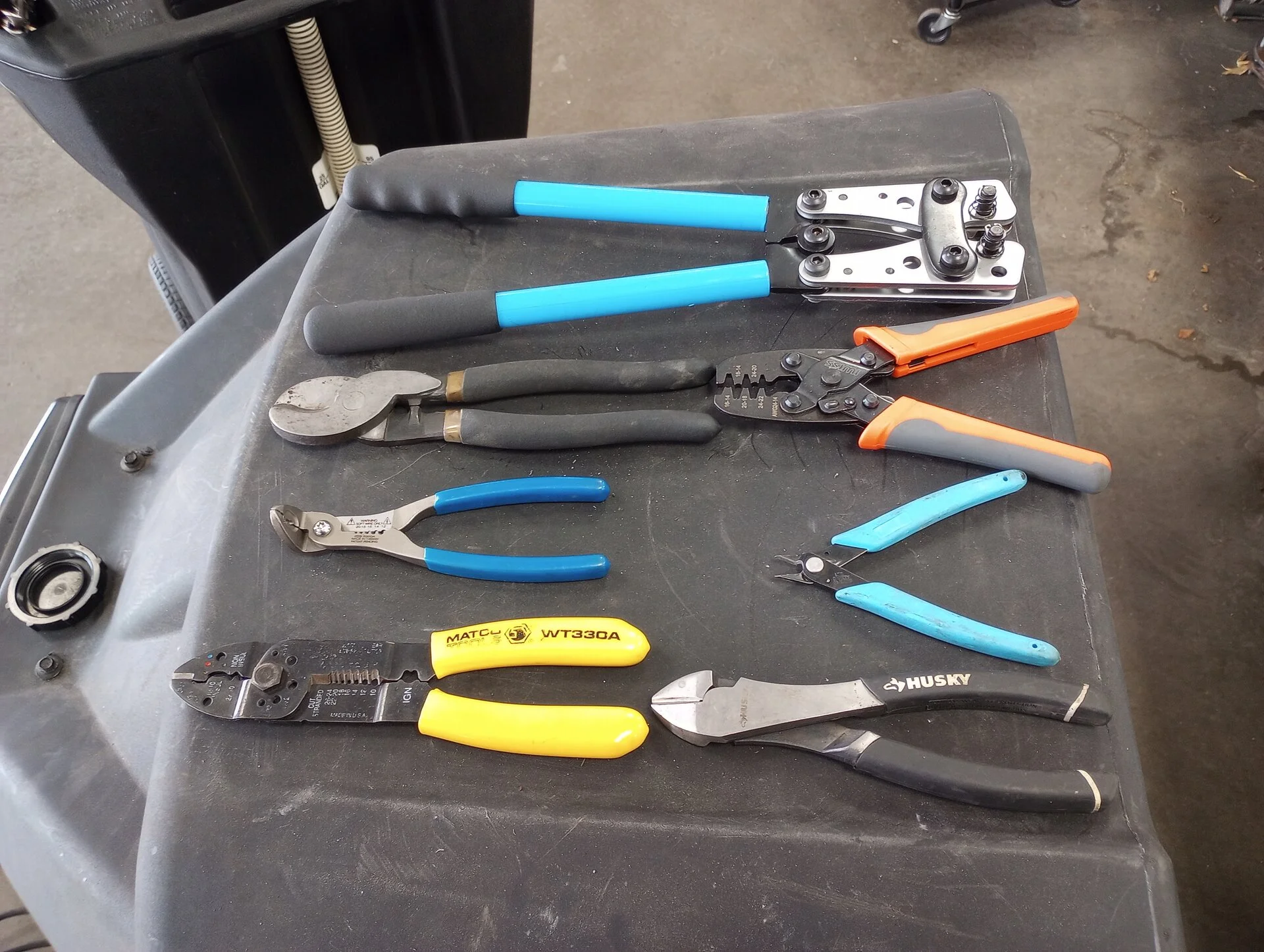

There's what gets used at the shop. Electrical repairs are kind of a specialty of mine. Pro-tip, any of these tools branded "Matco" were made by someone else and can be found cheaper from the company that manufactured them. The big battery cable crimpers and the orange-handled specialty crimpers are from a Chinese company called "Iwiss" that makes damned good knock-offs of other tools.
