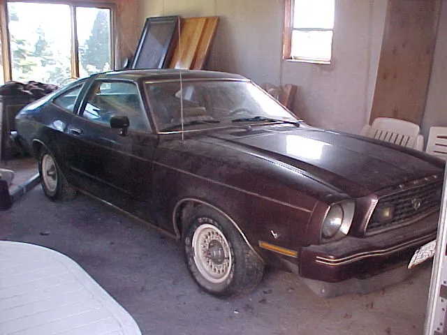

Hi, my ride:
attachment.php
Eos said:
Interesting color.....
It was supposed to be more orange but came out more copper than anything.
When the sun hits it the orange really comes out with the multi flakes. I get alot of good feedback of on the streets and with so much flake kinda puts the redneck girls in a trance (sorta like a bass boat) :)
