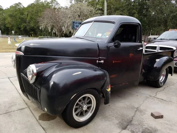

I have what looks like a completely stock Mustang 2 front suspension installed in a hot rod. The upper ball joints are riveted. I need to replace the upper control arms and anything else upfront that is worn. I have searched for videos on the internet and cannot find any that explain how to take this apart the right way. Does anyone know of a video or good directions?
