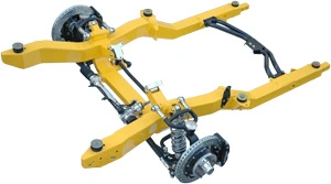

Additional information on the Chassisworks g-Machine Crossmember System that was discussed in the Rod and Custom article.
In regards to your possible plans for open track use, this is same front suspension (minus the bolt-on subframe) that is used on the RCR Series 3 Camaros built by Richard Childress Racing.
Chassisworks g-Machine Camaro Subframe System
RCR Series 3 Camaro Specs

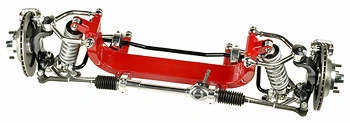

I had this same internal debate, and read tons of reviews and some of the incredibly well though out and explained viewpoints on this site as well as my own experience and settled on this option.
MuscleUp Performance and Rod Shop
This is the same system Jeff Schwartz is marketing with great success... both companies are fantastic to deal with and will answer any and all questions over the phone.... in my opinion, this chassis answers and the questions I had, and solves the problems I was worried about with front and rear suspension systems and the issues with tying them together for rigitidy. You still have to cut up a car, which is not good for a rare or significant vehicle, but my 66 was a rusty 6 cyl turd destined to be a parts car. It's not the only option, but in my opinion, it's a good solution to the handling issues we face when trying to update our early cars.
