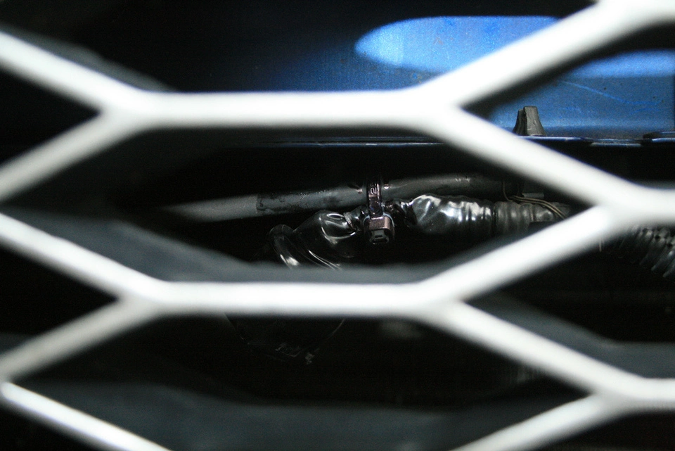

Removal is easy once you get a few of the tabs out. Take care with the bottom of the grill as it is right up against the painted bumper and can scratch it as you remove it. I used electrical tape to cover up the harness ends good and wire tied them to the harness bundle. I can take a pic later today and post it here

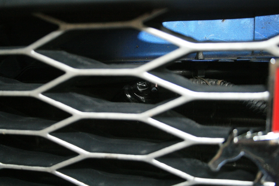

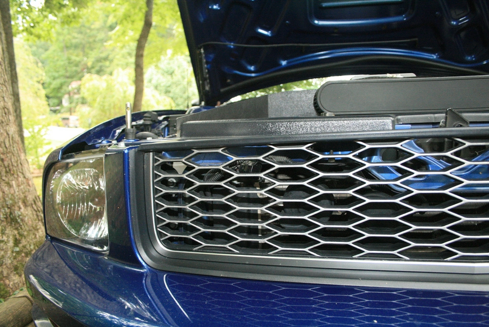

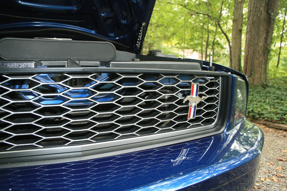

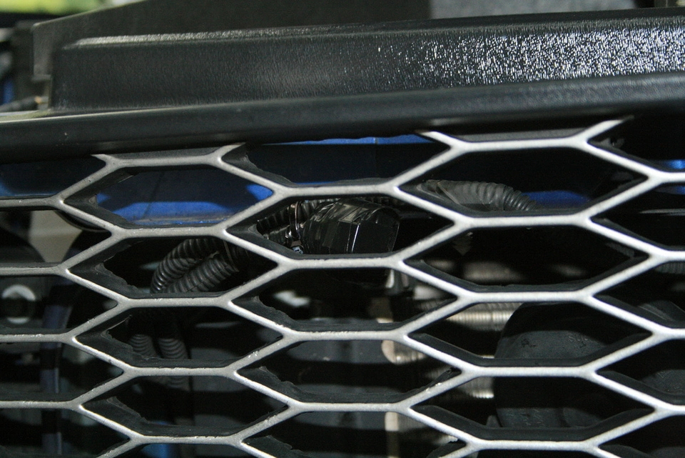

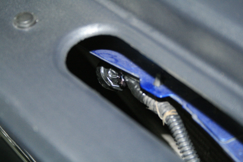

I didn't do a write up or even think about one before/during my grill swap
I also didn't have to mess with the bumper in any means to remove the OEM grill. I forgot that I used thin wire to also hold them together.
Note:It isn't that easy to see what is behind the grill, but the camera flash makes it appear that way.
